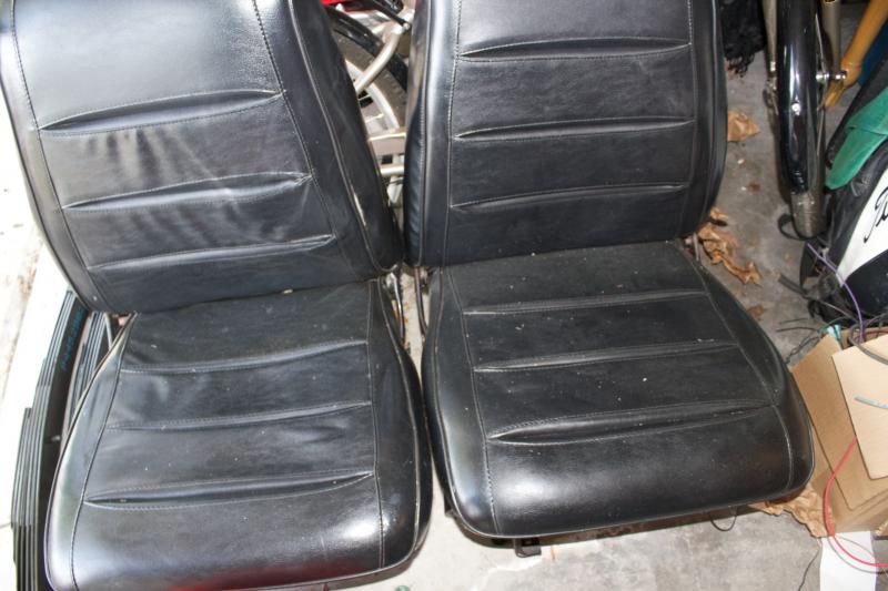

Seems like a shame not to post some sort of progress each day...so I'm cheating today...here wa a previous months $300 score. A set of 68 Charger buckets...there in pretty good shape overall, with working tracks. Tracks are a little rusty, so I will strip prime and paint them before mounting in the car. Due to budget I will hold off for a little while on reupholstering them.
$300 for a set of Charger buckets...Wow that is a good score. I need to get pointers from you on finding deals like that!
I would suggest a set of cal Tracs and new springs. And mancini sells the stock bottom plate if you go that route
Yeah, I was stoked to get such a good deal, especially after seeing bare, rusted out frames getting $600-$800! I saw a set recently that was held together with duct tape and the guy wanted $1,200....rediculous.
The secret is patience I guess...if you can wait long enough on a part and keep it in your sourcing rotation (the list of parts I'm searching for deals on every week), you'll eventually find a good deal....sometimes :)
