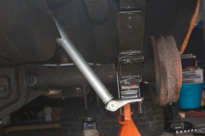

Ok, So here's my Saturday afternoon Leaf Spring and Shock replacement update.

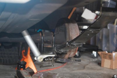

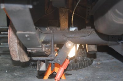

Passenger side done! Feels good and looks good compared to the rusted crap I took off the car. Here's a pic of the driver side with old spring, hangers, shackles, U-Bolts and unwanted traction bars vs. a pic of the new set-up on the passenger side, with new spring, shock, shock mounting plate, U-Bolts.
Thanks to many here on FBBO for recommending cutting off the U-Bolts, They were rusted on solid, but I was able to cut them off with a little effort and a cut-off tool, no problem. Biggest issue for the passenger side, was from my post above... just took a good 8 hours of sleep to clear my head and figure it out.

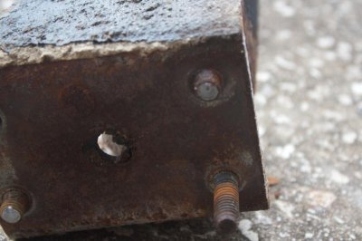

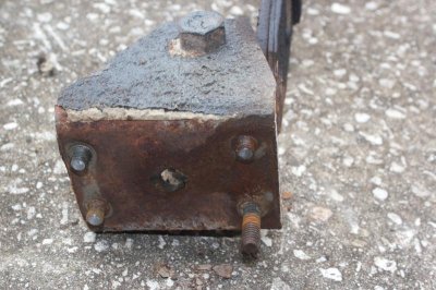

As for the drivers side, I got everything apart fine until I got to the front hanger. I should say that I very liberally sprayed everything down with Seafoam penetrating oil 24 hrs in advance. The first nut came off with an air ratchet, no problem, second one fought me and out came the breaker bar...Snap! followed by #3 and 4..snap...I don't know if it was the rust or if they were overtightened in the first place, but the hanger is toast. I will be buying new ones from Mancini along with a pinion snubber (which the vehicle doesn't have).

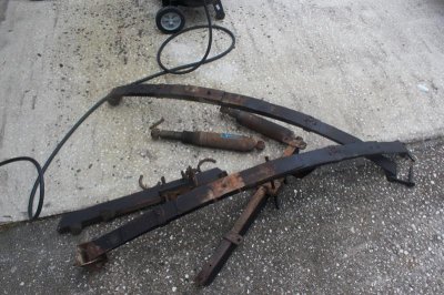

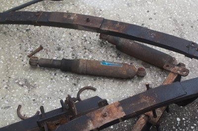

All in all I'm glad I tackled it. Here is a pic of the heaping mess that came off the car. Notice the 2 air shocks and how 1 is longer than the other (extended). The shorter one is frozen solid and won't move, this could not be helping the ride quality.

yeah sometimes you just need to get away from the project for a while. You could just knock out the broken studs and replace them with some grade 8 bolts.
Or some weld studs.
Or some weld studs.
My welding skill and equipment is nil. But its a great suggestion. Maybe I can find a local shop too do it cheap.
Possible but I would worry about having enough access to get a wrench in around the front spring eyelet. Seems more important to have the hanger on the eyelet before mounting?

Nice work! I agree with the other guys, pop them studs out of there, replace with grade 8 bolts...Save yourself a few bucks. You could grind them studs flat, toss the hanger in the vise, throw a little heat on the studs, and knock them out with a punch. Replace with grade 8 bolts, nuts, washers and lock washers. Spend $3 bucks instead of $70-80. Either way, she's gonna ride 10 times better after the work you've done back there.
Against my budget and the great suggestions from veterans here, I went ahead and ordered a new set of hangers from Mancini (The AR Engineering ones). I replaced so much new on the rear suspension it only seemed right.

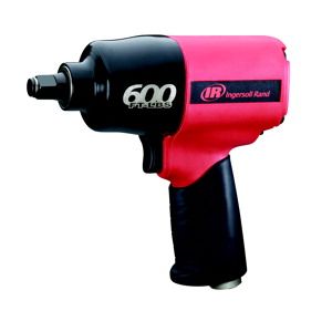

Also, went overboard and spent $50 of next months budget on this bad boy... My impact was a piece of crap and they were discontinuing this model at Lowes... seemed like a steel and it works beautifully.
