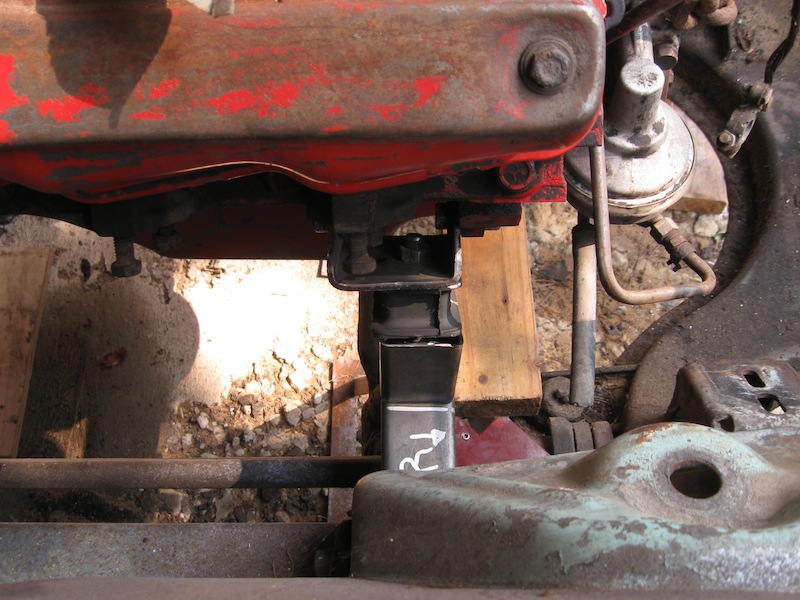

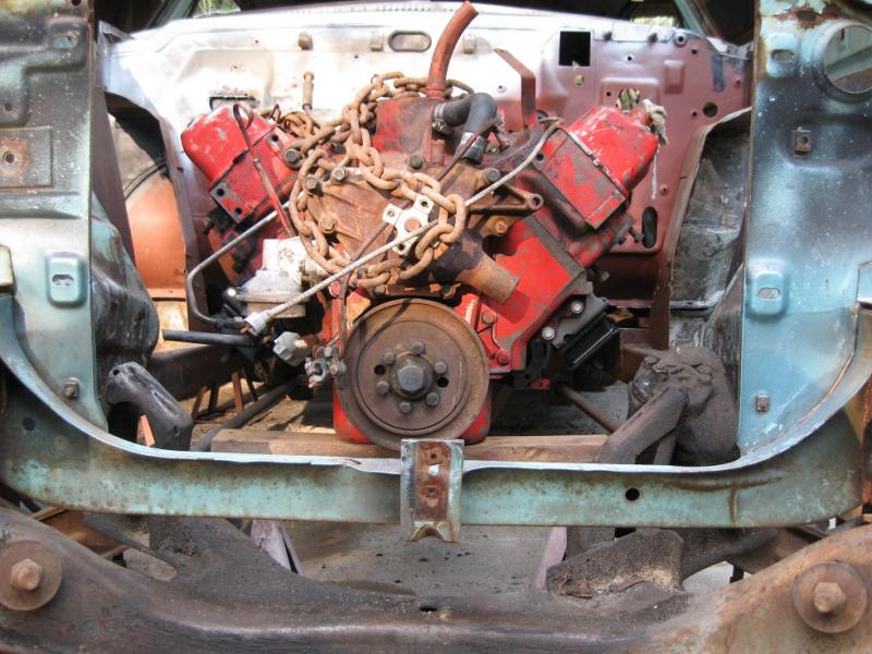

update

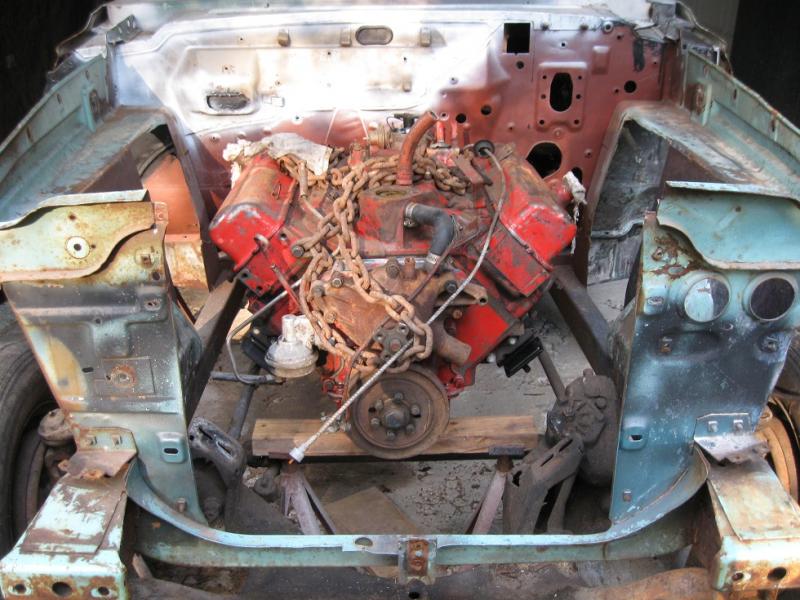

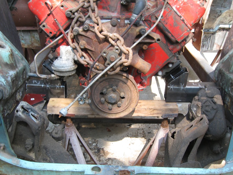

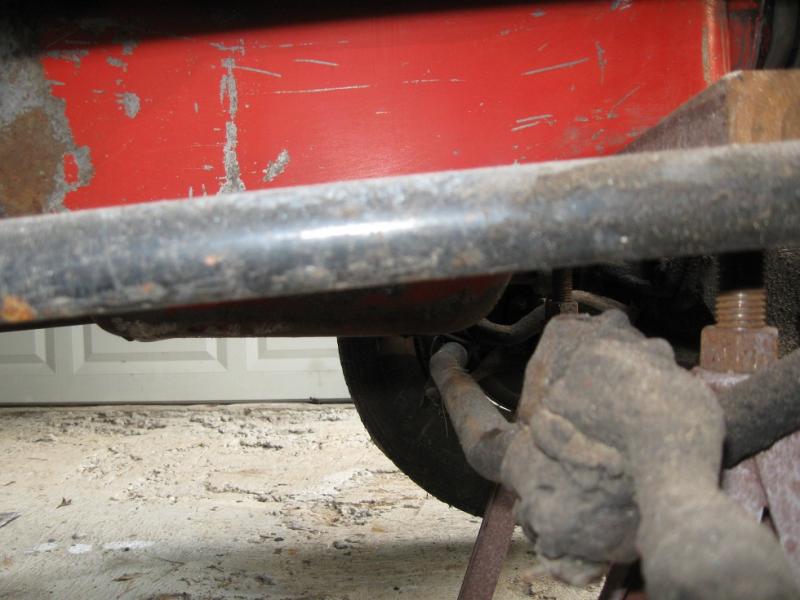

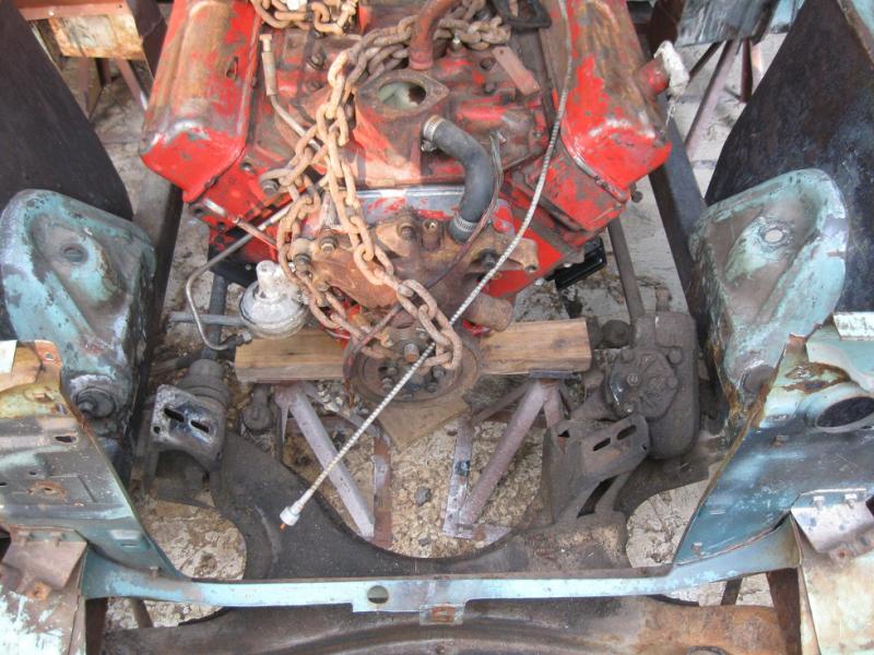

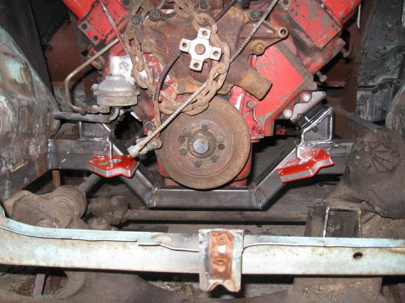

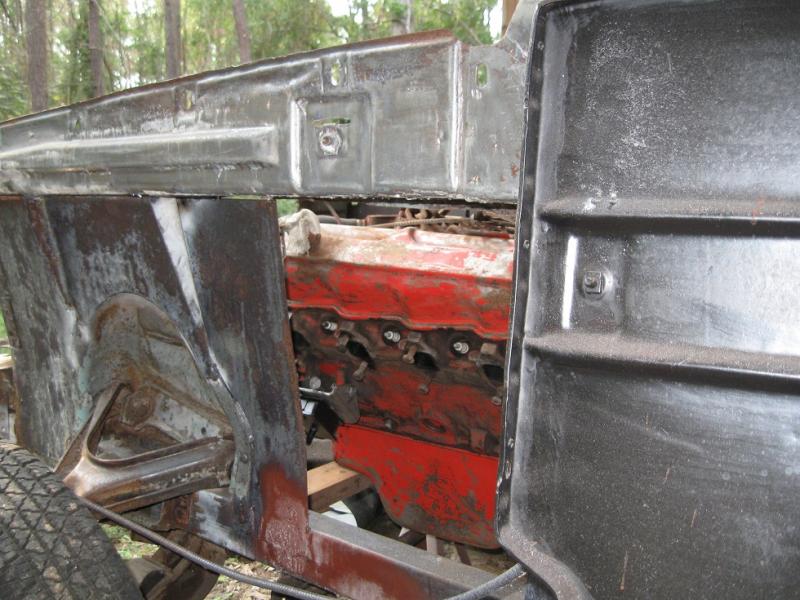

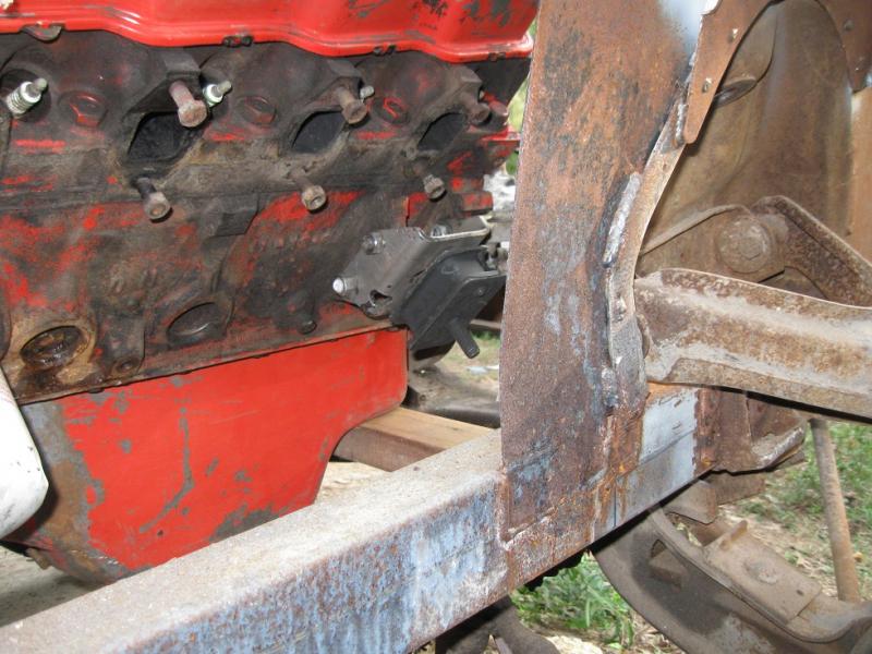

got the motor in to make up motor mounts and to check oil pan clearance
GREAT THREAD! I check this thread out EVERY DAY. Awesome work, I'm impressed. Keep it up.

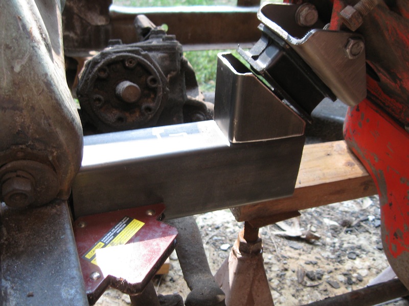

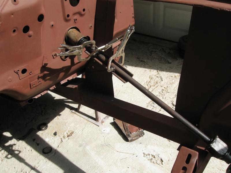

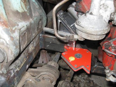

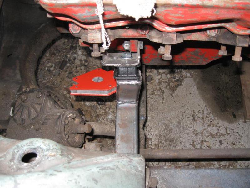

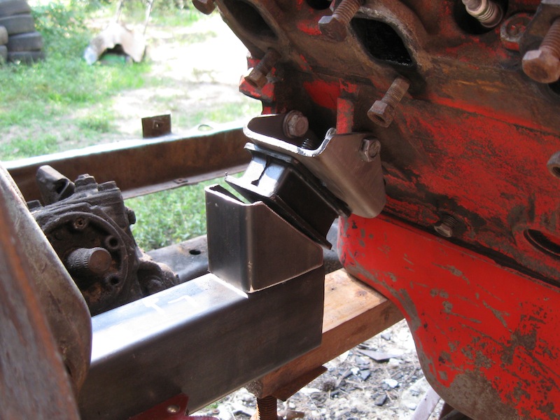

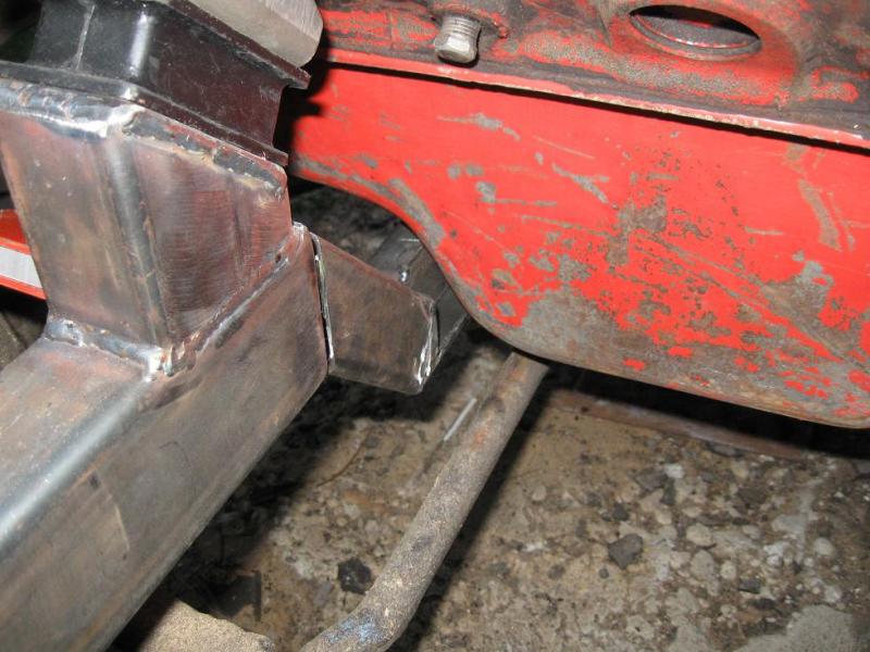

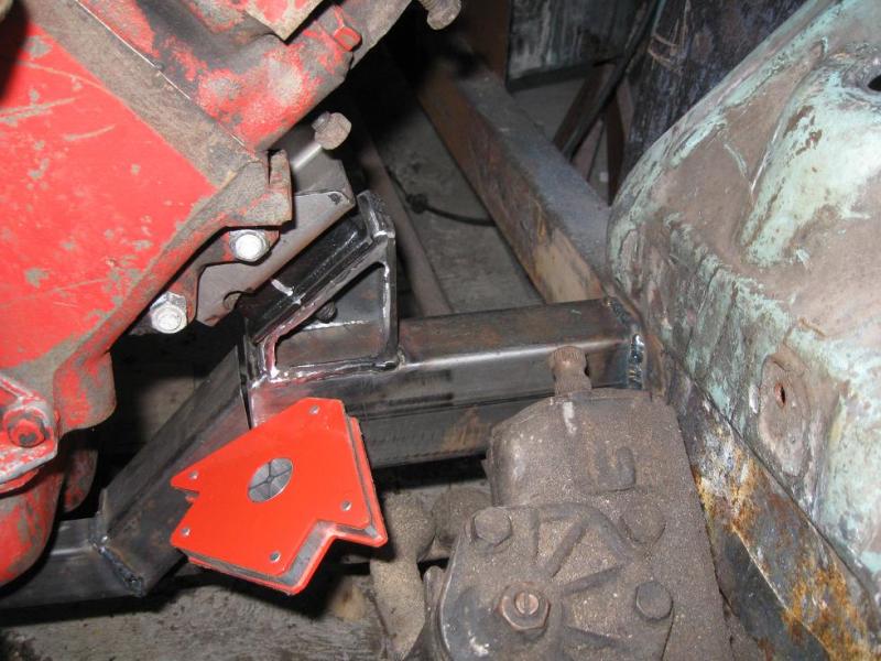

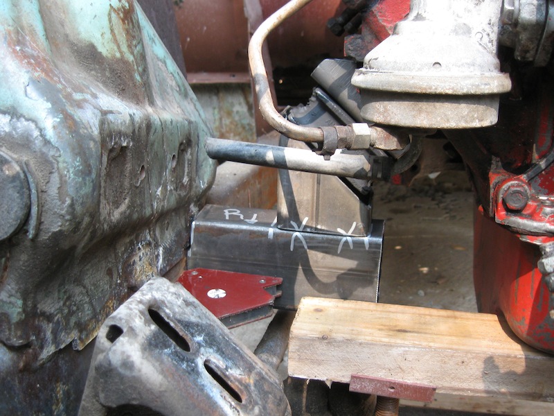

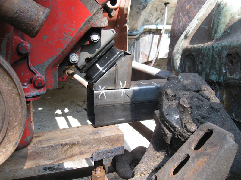

updates

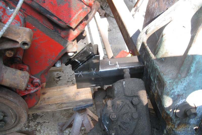

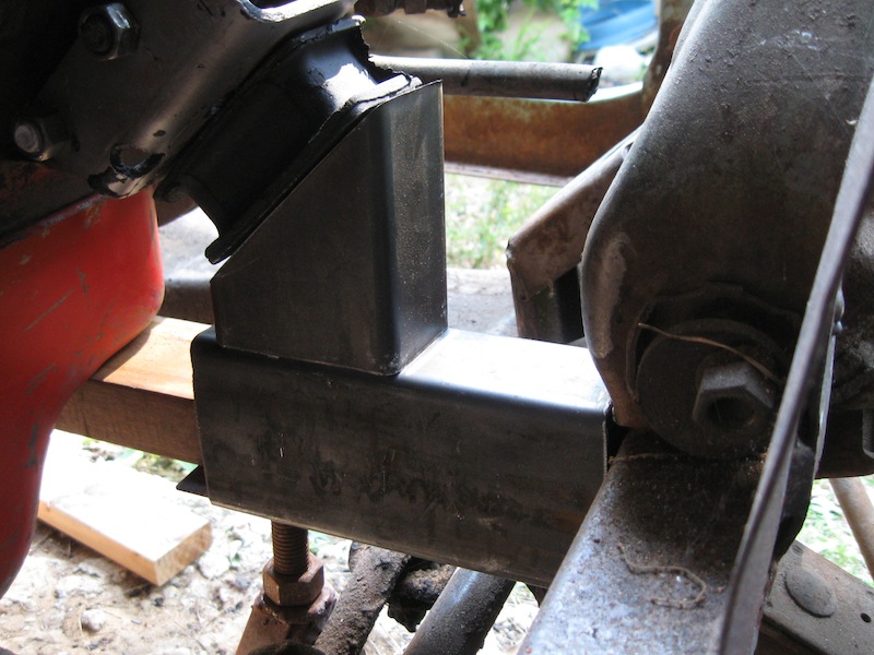

fitted motor mounts still need more tweaking ran out of welding gas too stay tuned :icon_bounce:
IMG_1371.JPG IMG_1372.JPG IMG_1373.JPG IMG_1374.JPG IMG_1375.JPG IMG_1376.JPG IMG_1377.JPG IMG_1378.JPG
looks like a perfect match up on the mounts.I'm always in awe of the fabrication you do on the car.

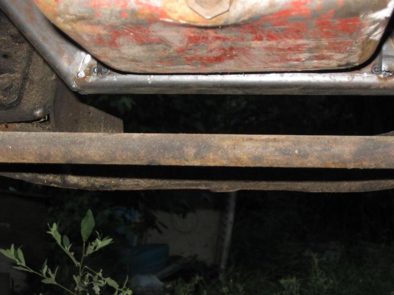

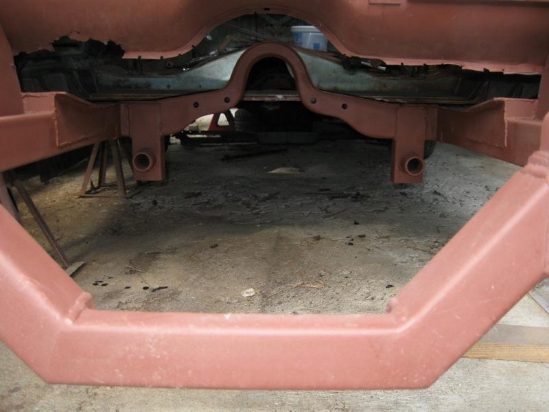

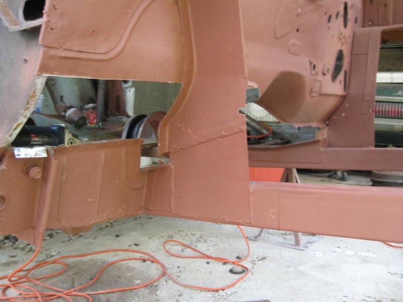

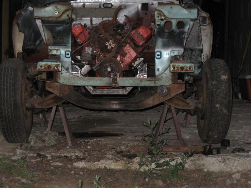

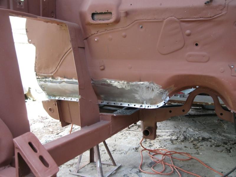

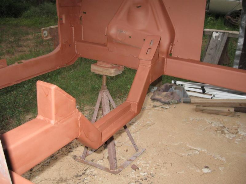

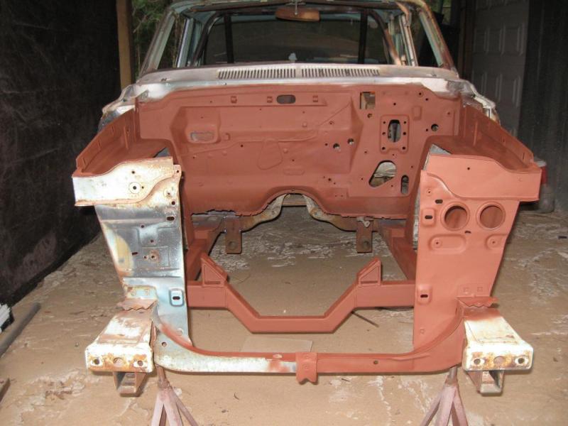

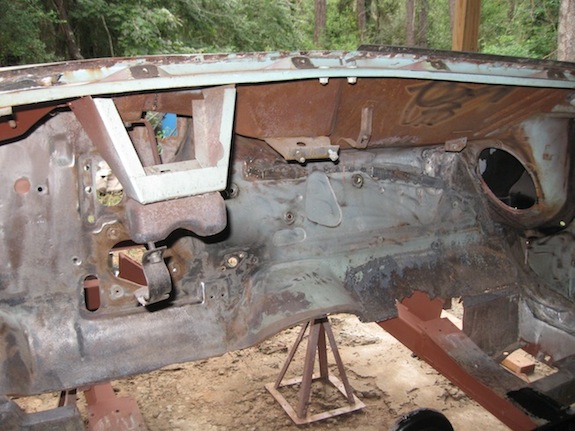

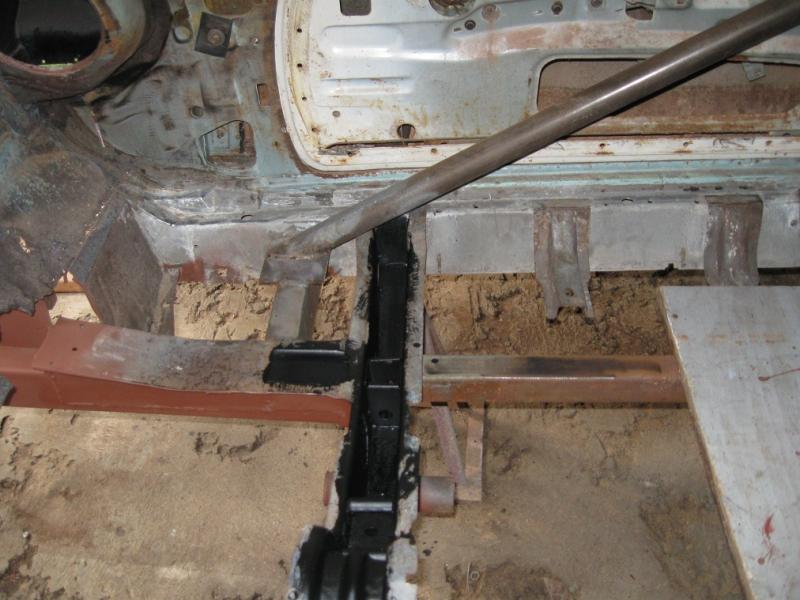

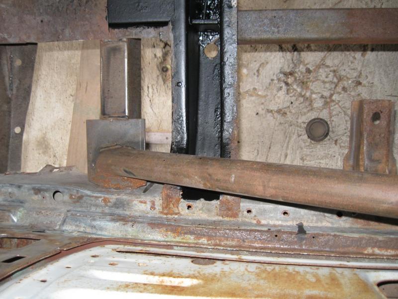

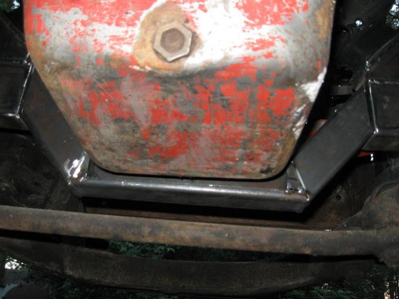

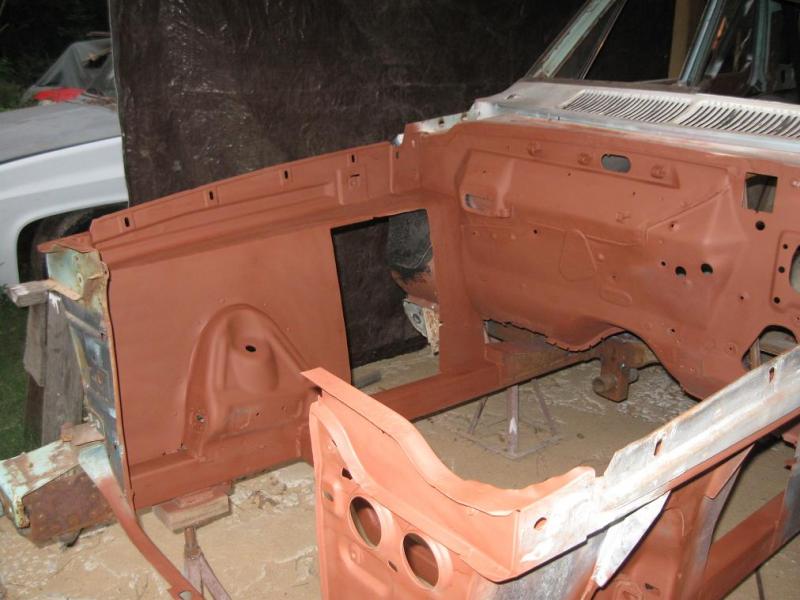

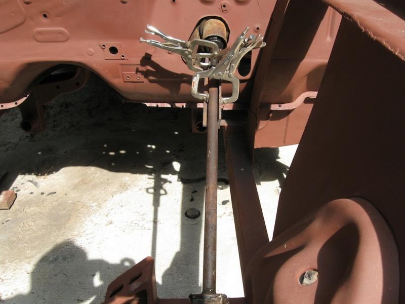

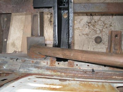

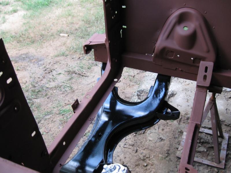

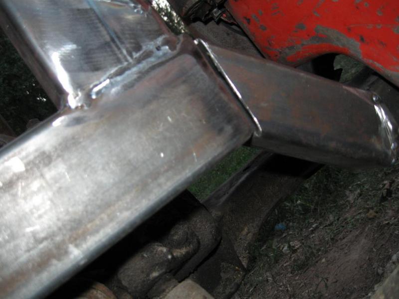

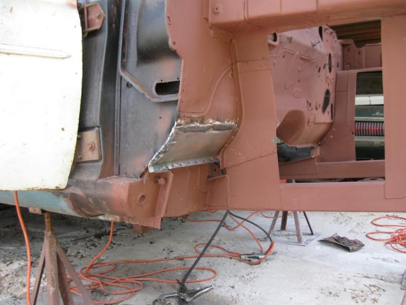

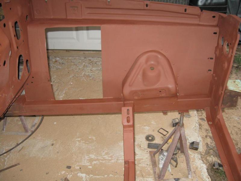

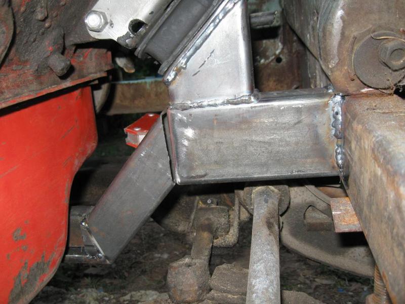

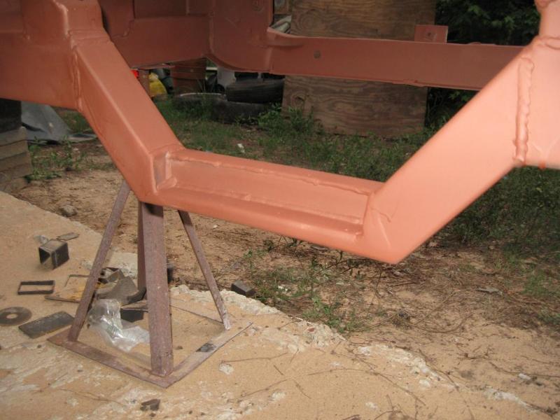

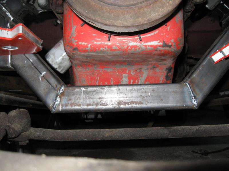

update
welded on the mounts and started on a cross member needs tweaking still .it got too hot out so thats it for today. once the motor is out and k-member is out then i can finish weld everything solid. blast and paint engine bay
Picture 376.jpg Picture 377.jpg Picture 378.jpg Picture 379.jpg Picture 380.jpg Picture 382.jpg Picture 383.jpg Picture 384.jpg Picture 385.jpg Picture 386.jpg Picture 387.jpg
