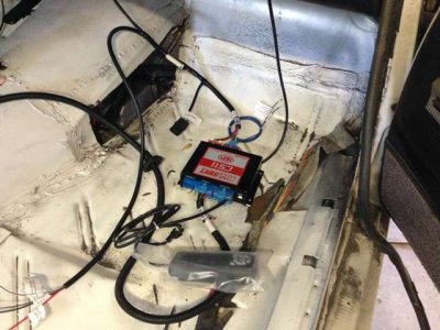

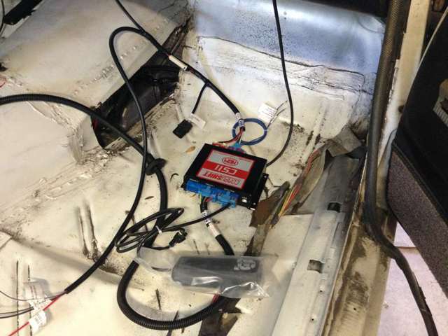

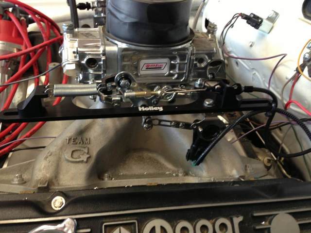

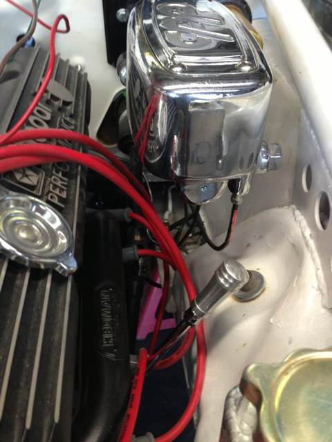

Some more updates. Getting really close to making rev at this point. I have the hydroboost all plumbed. The tcm controller is installed and just laying in there until I figure out where to mount it. I put a lokar throttle pedal and cable along with a holley throttle cable bracket. I had to re-engineer the TPS sensor from the compushift2 to work with the holley bracket. Not a big deal really, just getting it to track correctly and calibrate was a bit of a pain.
I am not sure I have posted much about the motor. Its a 40 over motor with eagle forged crank, manley forged rods, and ross forged pistons. Its a 10.75 to 1 compression motor. Has edelbrock performer aluminum heads. It has a crane hydraulic roller cam in it (232/238 .583 .566 on a 112 LSA), it has crane roller rockers. Aluminum water pump, Milodon deep pan, and a few other goodies. It has 1.75 headers on it for right now, but somewhere in the near future it will get 2 inch. I am working on the pieces to put EFI on it here in the near future as well.

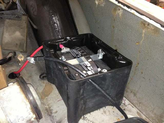

Wow, that is a lot of new parts in that car! Hope you get it fired up and motivating soon, but first put a grommet on that positive battery cable where it goes through the trunk. Just busting chops, I'm sure you already have :icon_thumright:
He probably didn't, lol!!

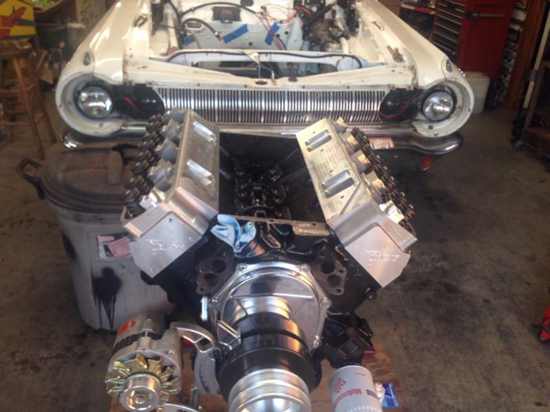

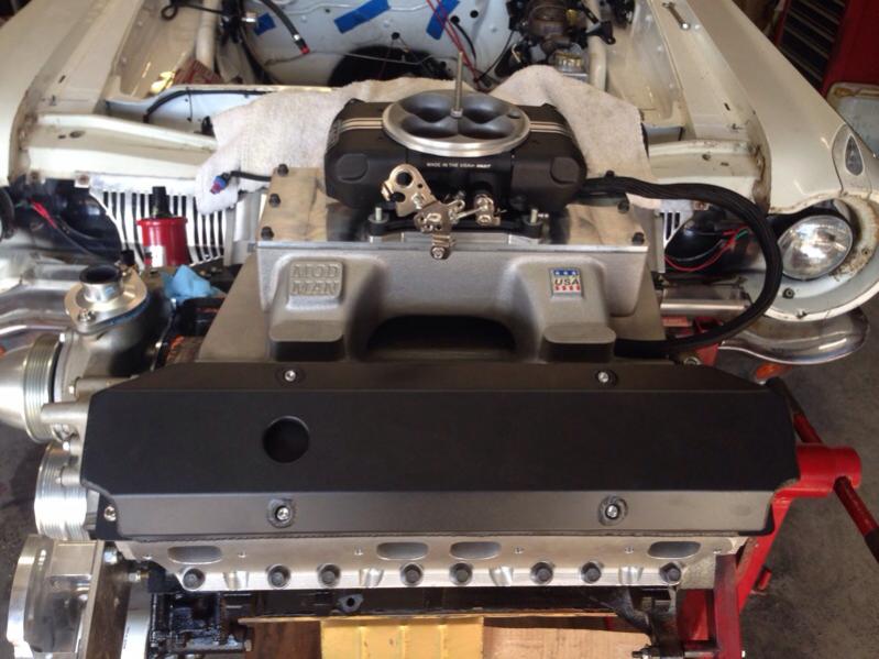

Ok so I'm moving right along. The ez efi2 is installed and working. I just pulled the motor to put in the bigger cam and the Indy ez-1 heads w max wedge ports. That with a mod man intake.
While it's out I'm going to clean it up and paint it black. I'm going to try to silence the power steering leaks as well. So I'm really looking forward to a much bigger cam, about 50 more cfm from the heads, and 12.5 compression with e85.
Getting ready to go back together.

That car is gonna be even sweeter when I'm done with your ss grille!!

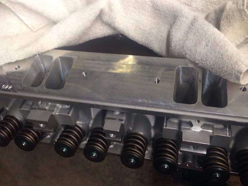

Getting closer. Down to pushrods now.

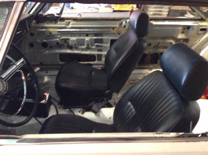

Got pushrods today. Seats too. I like the seats. Didn't know if I would
Yeah, they are pretty nice!
Here's a pic

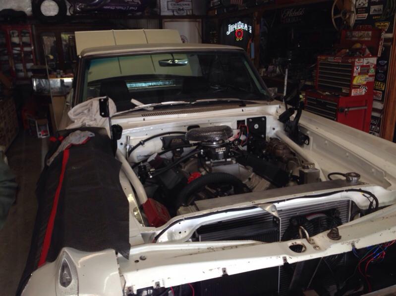

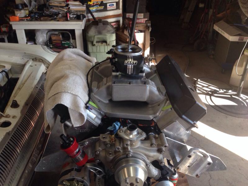

She needs fluids and she's ready to go

So most you that have been following my build know I've been doing the car in stages. This last round pointed out some flaws. I was out of fuel pump. I was starving for fuel under hard acceleration etc.
So here's the winter build up
Fast 102mm efi throttle body
A1000 fuel pump
ID 1000 injectors
Custom efi elbow
Mod man intakes being drilled for fuel rails and injectors
Crank and cam triggers
XIM fast ignition
Ls1 coil on plug
