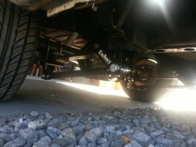

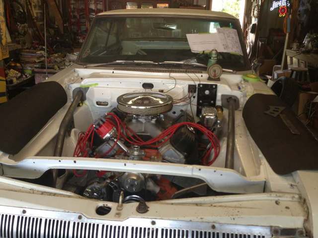

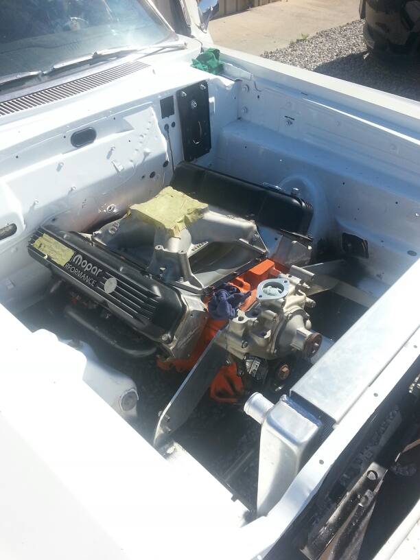

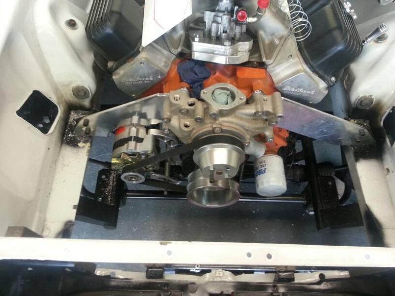

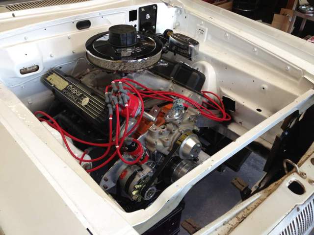

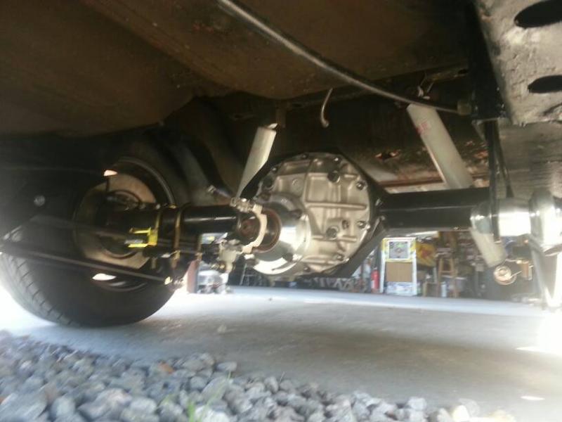

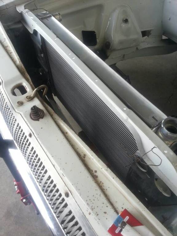

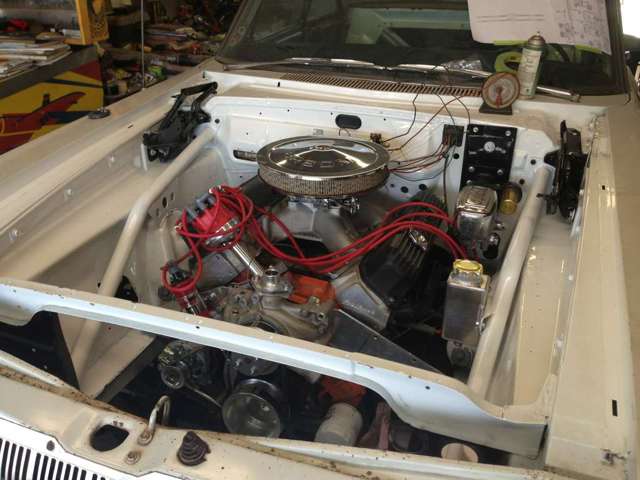

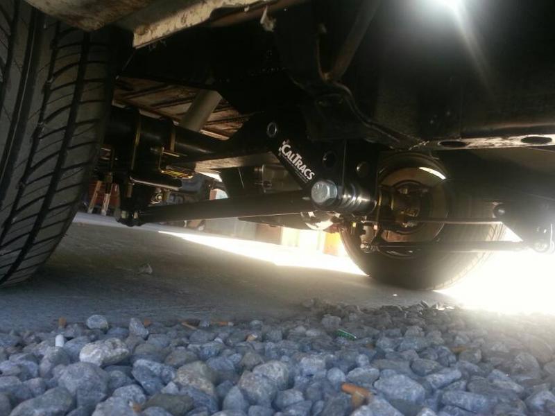

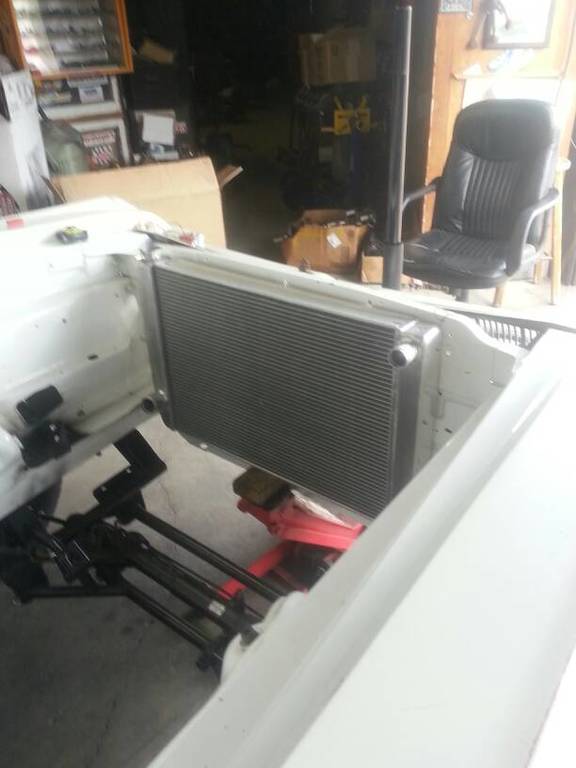

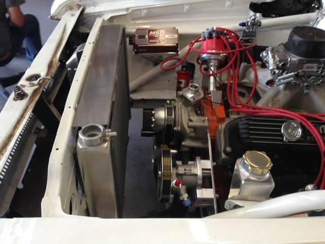

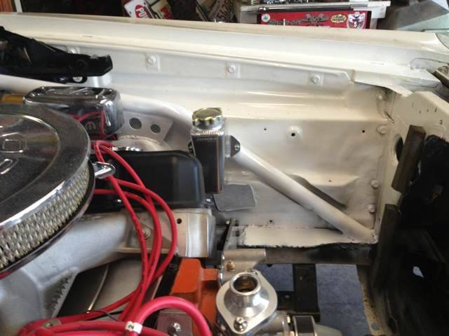

Some more pics. Radiator in and attached. Motor in, headers in, center section installed. Caltracs installed. Fuel, fire, and some wiring to go. Trying to figure out a serpentine pulley system of the home brew sort to make it all work accessory wise. I had to order an offset master cylinder bracket for the hydroboost to clear the valve cover. Marching right along though. Hopefully I will make rev before the end of the month

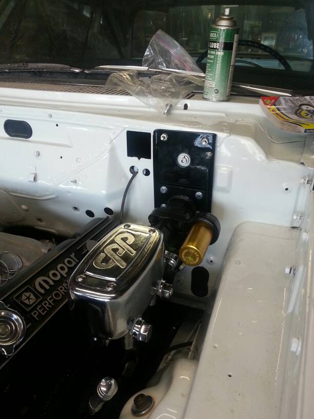

Since you have to stop before you can go, hydroboost 4 wheel wilwood disc brakes. I made a template for this so I can make more of these if anyone is interested. They fit very nicely on top of the stock firewall bracket.
Here is the rest of the progress from yesterday. I need to clean up the arc we cut into the elephant ear still.

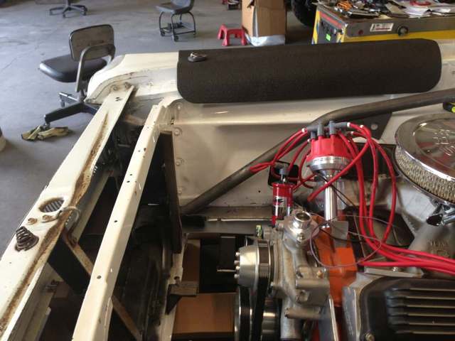

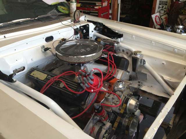

Plugs,wires,distributor all in.

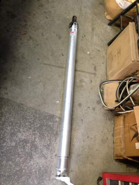

Aluminum 3.5 driveshaft.

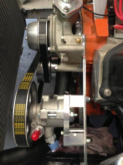

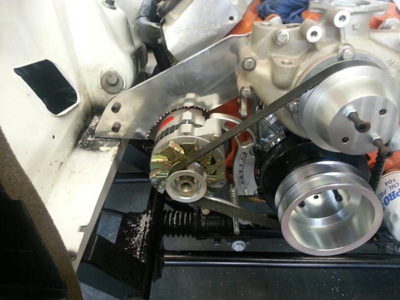

Adapter to use a new ps pump on the old car. Mounts to the elephant ear

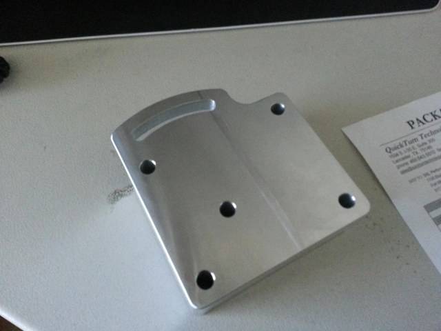

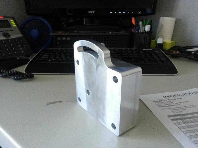

Finally got the bracket cnc'd for the gm power steering pump I switched to. Radiator is back in, gas tank in. Playing the waiting game for fittings
Really like your belt/pulley set up looks nice and clean.

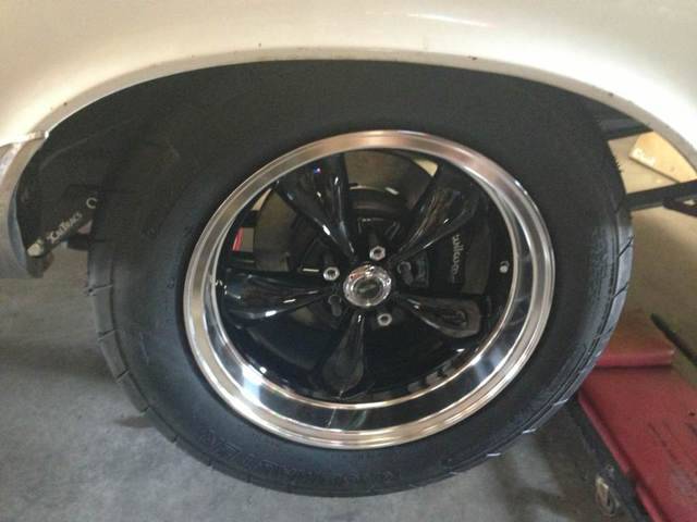

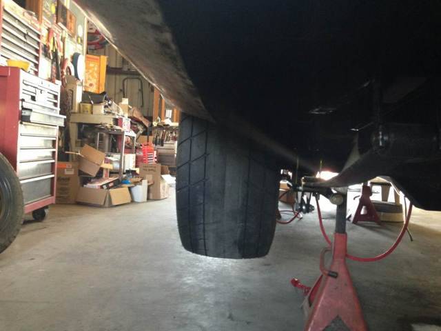

Rear wheels and tires finally on. Think it came out good. 17x11 American racing with m&h 325/45/17
