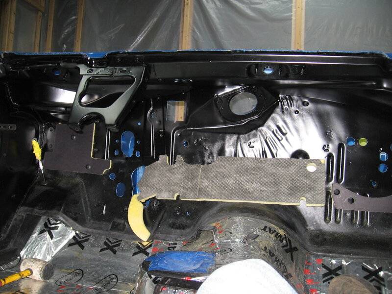

Should be a hump on the left of the clutch pedal. I used AMD Pan. The floor shift hump is pretty straight forward. Meets up to the fire wall. Second pic. is from fire to floor pan line to opening of the shift boot location.
Awesome, that help a ton. Thank you!!
If you look where the mallet is to left and look at the x matt you can see two holes punched in the x and matt word that is where you will find the holes for the dimmer switch. In the front in the fender wheel you will see the holes for the bolt's to come through.

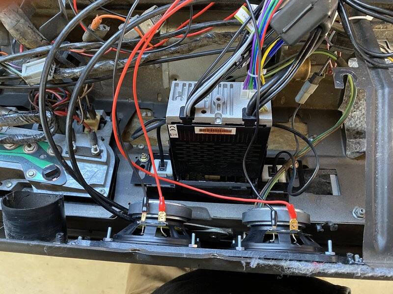

I did get the Redondo radio in from retro manufacturing. I was pretty excited about this but was a little disappointed when it showed up. most of it is real cheap plastic and feels like its gonna break. Didnt come with any instructions and just had a card that said to visit the website, and the website instructions were real vague. I emailed customer support and asked a few questions, they sent a response that didnt answer my question at all and then just stopped responding altogether. I was able to find some help on a forum from someone else who had a similar experience. so i've got it installed in the dash and I'm really hoping that the sound and convenience makes up for my experience with is so far. I was also able to get a front speaker as well as two rear speakers in.

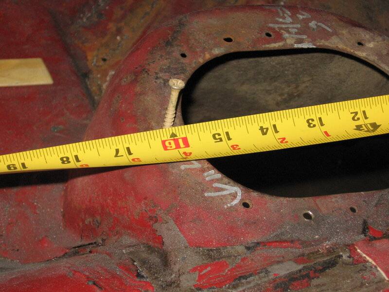

I still need a radiator, I'm pretty sure its got a 26" hole, and I have a seven blade clutch fan I'm probably gonna run with, I'll just need a shroud. So any recommendations there would be appreciated. I was looking at champions and they seem like the best bang for the buck. I'm not opposed to running an electric fan, I just dont want to spend a ton of money. I'm also in Michigan, so it doesnt get super hot and I'm not going to be racing.

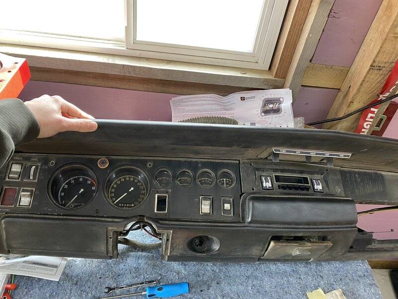

Started on the weather seals last weekend, still might be a little cold here for the adhesive to completely setup, so I think I’ll hold off on the rest for a warmer day. But I was able to install the dash speaker and wire that up to the radio. I bought a pre fabricated bracket with speakers installed, it didn’t quite fit, but with some modifications I was able to get it installed. That’s just about everything as far as the dash goes. I’m gonna do some more cleaning on it and then try to get it installed this weekend.

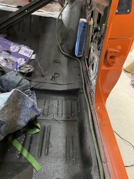

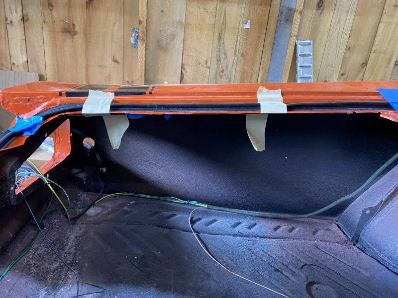

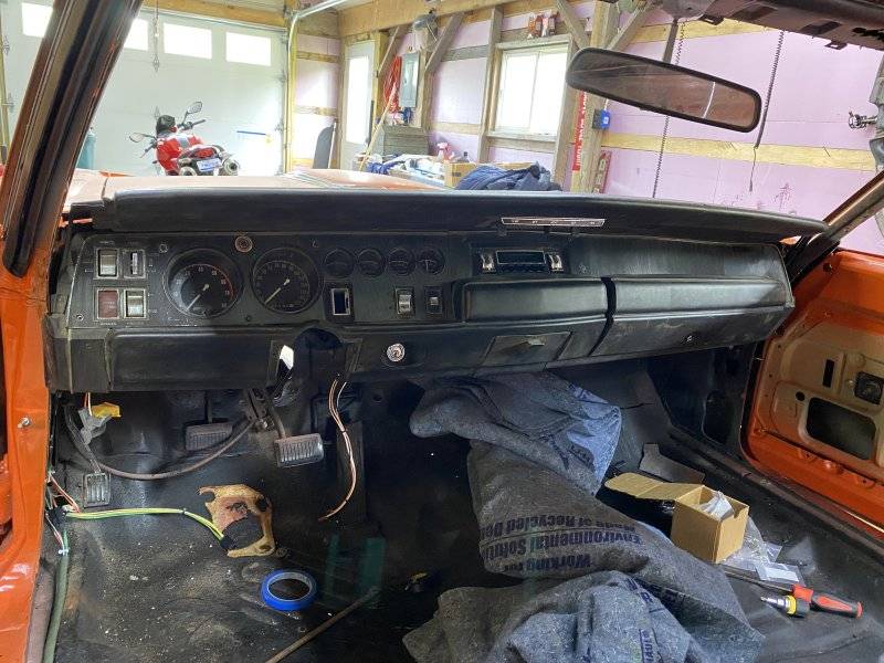

So I finished all the wiring aft of the firewall and got the dash installed. Have a few parts left over but everything seems sturdy so I’m gonna let it ride for now. I need to figure out where the fuel tank sender wire is supposed to pass through cause the floor is a generic repop and doesn’t necessarily have markings for everything.
Still have to screw the dimmer switch into the floor, and one of the speakers doesn’t quite fit into the holes on the back window shelf so I’ll have to grind that out a little bit.
Also got the door weather seals installed but realized I have to get the windows installed next to get everything aligned properly.

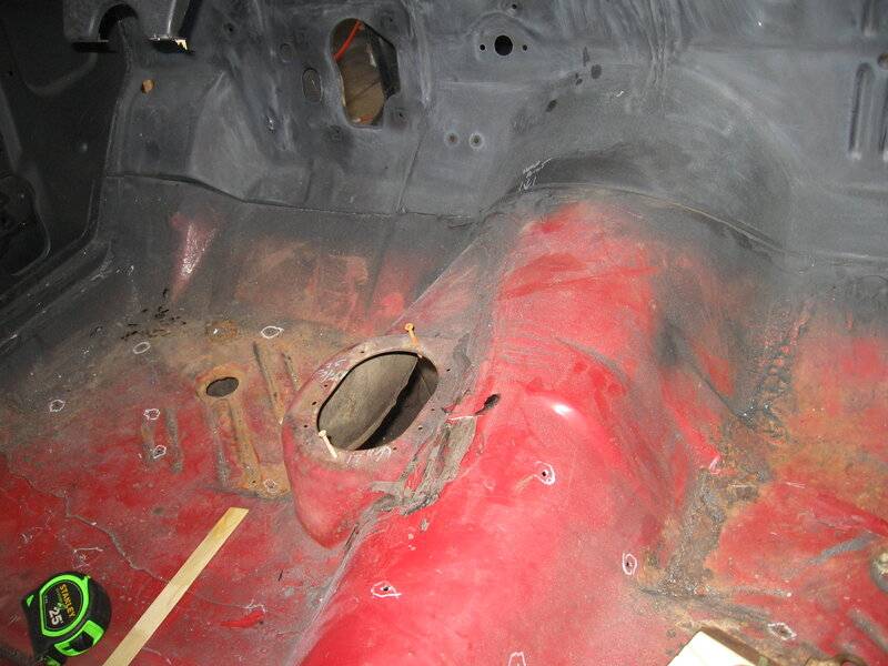

I also got the gas tank in and all the stuff for that so I’m gonna have to do some research on that and get that installed.
As always any advise or words of wisdom are welcome and appreciated! Thanks!
Also in the process I realized I don’t have a heater box, so rather than being patient and getting one I’m just gonna run without it. I have the part that goes on the other side of the firewall so I’ll put that on to cover the hole and put metal tape over the rest of the holes.

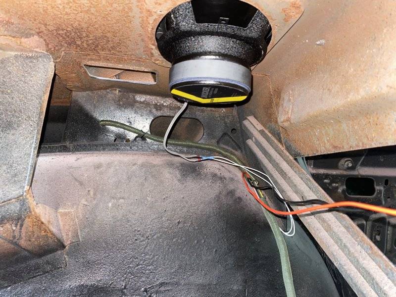

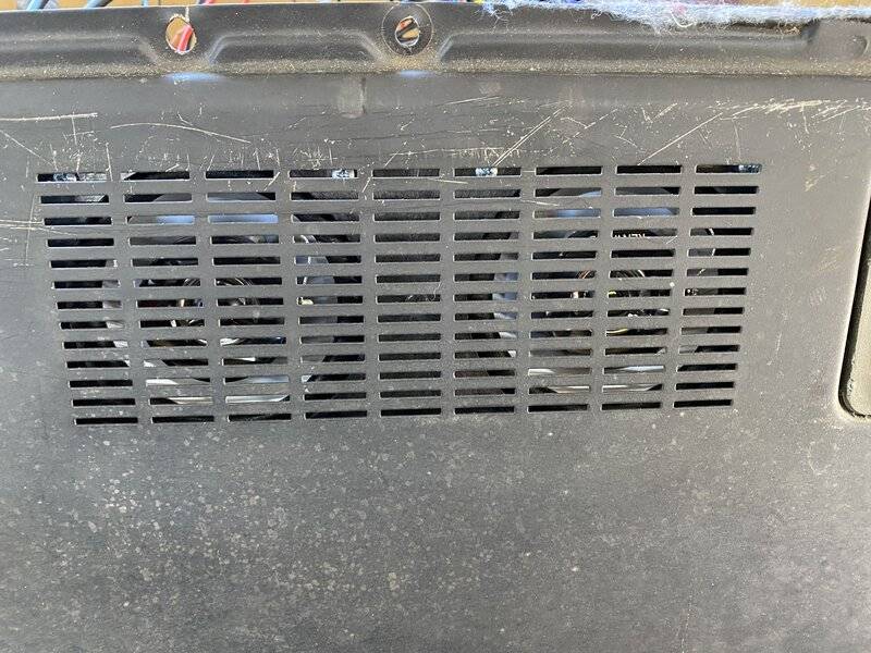

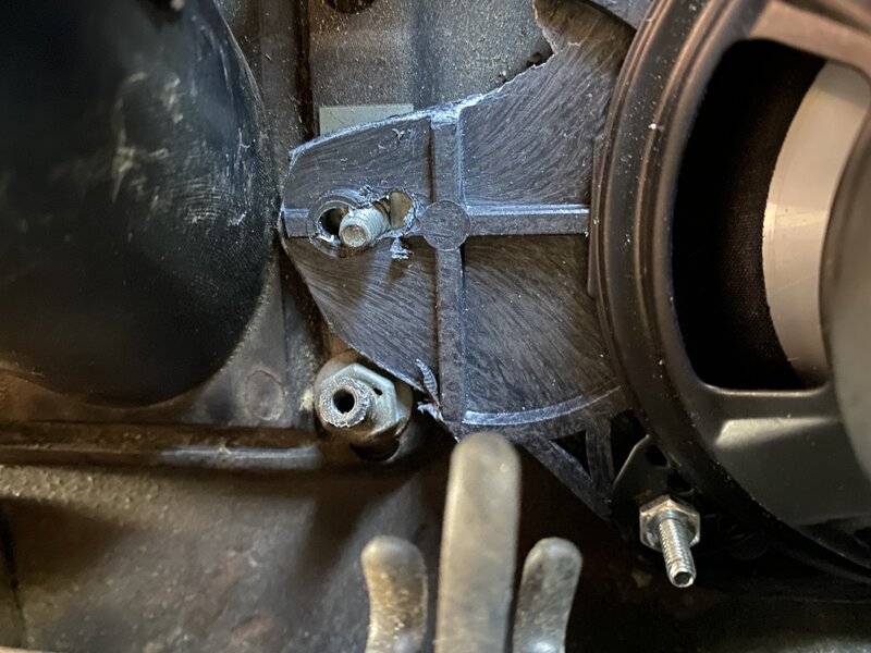

Ok, regarding your rear speaker installing can we get a historian to chime in. It seems , at least to my b bodies that the rear speaker cut outs were made for different size speakers, seems maybe a 6x9 on one side and a 5x7 on the other, correct , yes or no. I don't think one could order a standard pair of 6x9 rears for our sixty and early seventies cars. Yes-No. And for the rear cutouts, did they drop them in from the top or were they put in from the bottom. I put in a long bolts from the top , nutted them tight, and doubled nutted the speaker from the trunk. My thinking is that if I wish to change them later the rear package tray cover won't have to be removed. Great progress Sir, I like it. :thumbsup:
That’s interesting, I hadnt considered mounting from the bottom, the holes line up so I don’t see why that wouldn’t work. I got a standard pair of 6x9 speakers and one was able to drop right in, the other doesn’t drop in but the holes line up. If I can get away from cutting the package tray that would be ideal, but I’m also not opposed to it if that’s what it comes down too. It’s just a clone so It’s not like I’d be messing up a numbers matching car or anything.
I am with ya on that one, I don't cut sheet metal anymore if there is any way around it. I just left the smaller hole over the bigger speaker and my old ears cannot hear any difference in the sound.

Actually, ‘68’s package holes were opposite direction to each other. Very few Fm radios back then. The hole that ran parallel with body was for a rear defrost fan setup.(blew air up from trunk area)
