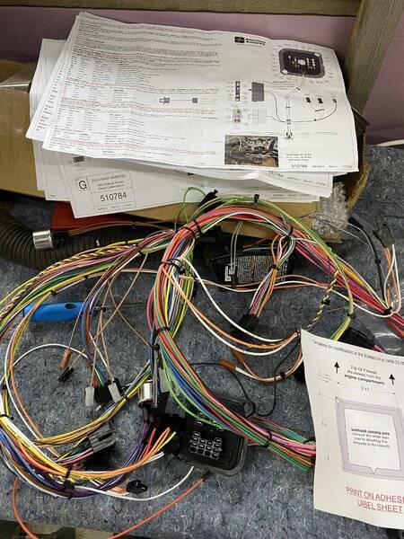

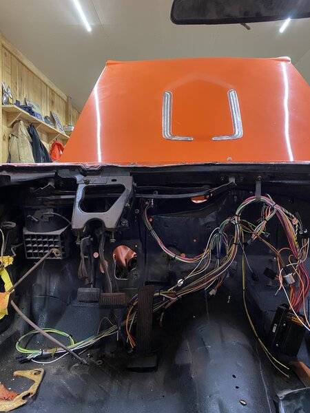

Started laying out the wiring harness while waiting on the crimpers to come in, and I found out that the previous owner put in a generic floor pan. This means nothing is marked out or where it “should” be. I’ll have to take measurements for the 4 speed floor hump, the seats, the dimmer switch and probably a few other things. Does anyone have a picture of where the dimmer switch is supposed to go? Or have measurements from something that isn’t the floor pan? View attachment 1175822 View attachment 1175823
On your crimpers, if you don't have them yet, I highly recommend the ones American Autowire makes. #510587. They are specifically for the Packard style terminal that our cars and some others makes use. I've found that the universal units, like the Pertronix ones with the multiple dies, are not bad but can still crush not crimp the terminal. The usual parts store ones just mangle the connectors. I did find out that Tyco, a manufacture of terminals, tools etc, make units specifically for the terminal type. Packard, Weatherpak, Molex etc but I didn't want to shell out north of 2k for them. The ones from AA also do the double wire type terminal which you sometimes get on the old cars.

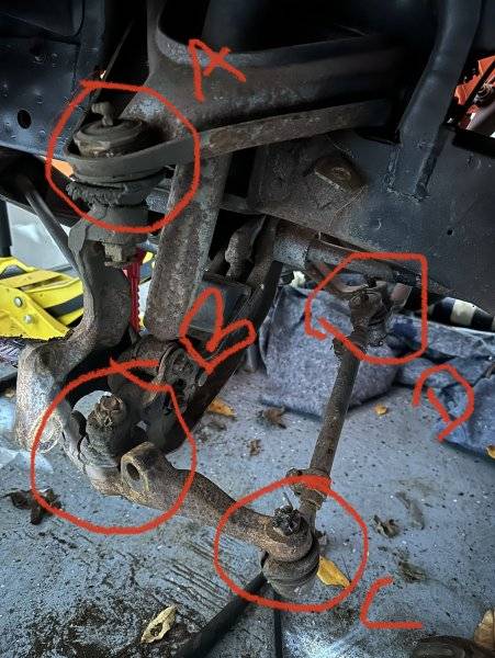

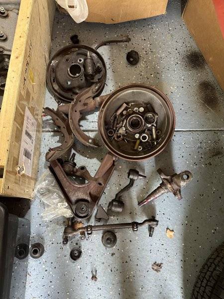

Hey guys it’s been a real long time. We ended up moving somewhere with a smaller garage so I haven’t really had space or time to work on it until now. I’m in the process of swapping out the front dum brakes for disc breaks and seeing all these bushings I figured I should probably swap those out while I’m in there. Can anyone help me figure out the names of the following bushings or recommend a whole kit that I can get to swap them out? Thanks!
PST is a vendor here. Order a suspension kit from them.
And FWIW you've circled a bunch of parts but missed the upper & lower control arm bushings...
Sorry I tried looking it up on my phone quick then got frustrated, so I snapped a picture really quick before I had to go be social somewhere with my wife. But I’m sure they’ll need to be replaced as well.
Those upper bushing are fun. Ask me how I know. There is a guy that shows how to get them out and get them back in on the net. The upper control arm that is. Need a press. Have fun but be careful.
I just ordered a whole front end kit so we'll see how it goes

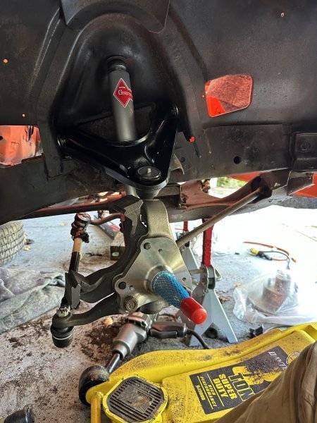

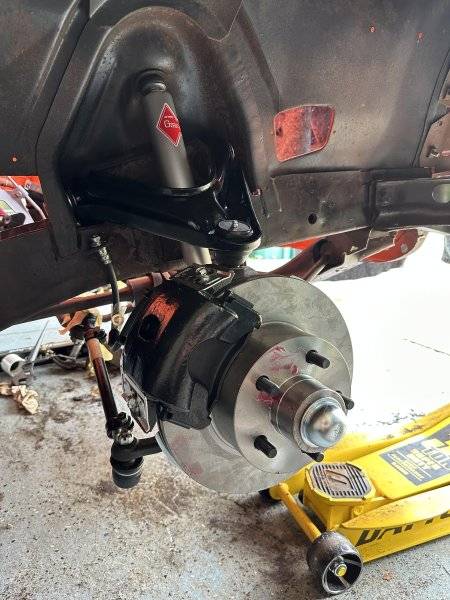

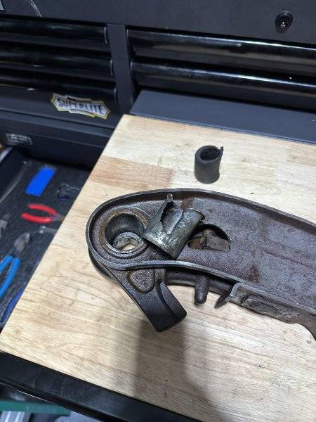

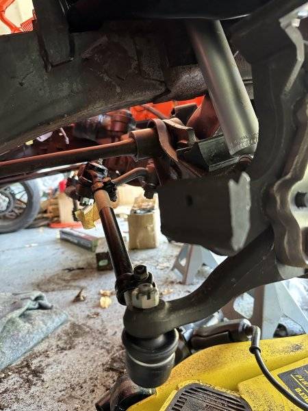

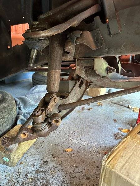

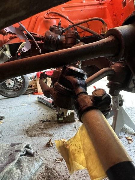

So I was finally able to get everything apart on the passenger side. even replaced the lower control arm bushing which was a whole ordeal. really not looking forward to doing it again on the drivers side. But now that I've started re-assembling the passenger side I've run into a new issue. The inner tie rod end is hitting the torsion bar, and I cant for the life of me figure out where I went wrong. As far as I could tell all the replacement parts were the same as the ones I took off. Here is a list of everything I removed and replaced.
idler arm
inner/outer tie rod ends
tie rod sleeve
lower ball joint
upper control arm with all the fixins
shock
spindle
bushings for the struts
It also looks to me like the upper control arm is being pulled pretty far down. I have a new bumper replacement for under the upper control arm, but I wasnt able to install it because it didnt come with a new nut and the original nut doesnt fit it. But it doesnt look like there is clearance now to install it. I've tried using a floor jack under the lower control arm to move it up and down with no luck.
If anyone can point out anywhere I've gone wrong, or knows a way to fix the tie rod hitting the torsion bar I'd really appreciate it!

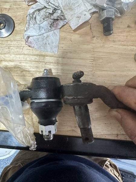

After fighting with it for a couple days I think I've found the issue. I took the new idler arm out and put the old one back in, same issue it was just as high. then I took the new tie rod ends out and compared them to the old ones and they are much beefier, this is where I think the problem is. If anyone has recomendations for Tie rod ends that actually fit I would appreciate it. I'll be out of town for quite a while coming up here soon, so in order to get the car off jack stands sooner than later I elected to keep moving forward and come back to fix the tie rods later. I tool the zirc fitting off the top and for now it barely clears, so I taped over it and I'll deal with that later. since then I've got pretty much the entire passenger's side done! now just on to the drivers side.
I’ve never seen tie rod end that look like that. What brand are they?
