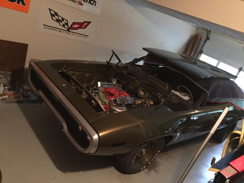

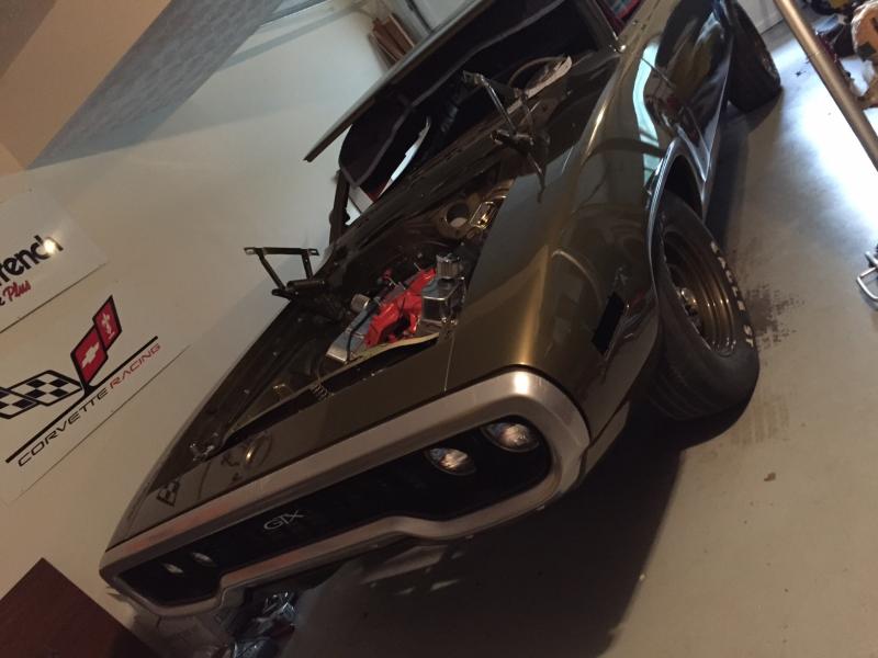

My '71 GTX
and after 5 long years, last weekend...I installed an engine...
(yes, there's a corvette sign on the wall....all marques are welcome at my house...I have a '71 240z, a '57 Austin healey 3000, a '66 C10 pickup, a ford focus....)
sjd
Now it's time to button up all the little exterior stuff. looks like I'll have to wrap the headers, I have about 4000 zip ties to tie up all the loose wiring, then factory ties to tie the wiring to the body. the headlights work, but not the tails...the fuel pump is just strung across the garage floor.
I have to fire it up, and run the trans through reverse and drive, then check the level in the trans. there's 10 days till the first year one weekend show of the year...wonder if I can have some miles on it by then...
sjd

1. the only issue i've found with the FAST EFI system is getting the base ignition timing down. there's a screen where you can figure out the offset it needs to run base timing, but that screen doesn't apply the offset. you have to go back to another ignition timing screen and set the offset there. it took two starts and set of glowing red headers to figure that out. road testing is next. the car start and runs no problem.

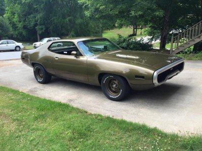

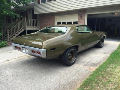

Here's a couple new pics after a shakedown in the neighborhood.
i'm chasing that electrical gremlin in the taillights. the first one was that the harness wasn't plugged in...LOL!! OOOPS. the second was now that the harness is plugged in, the drivers side taillight wants to stay on ALL THE TIME.
the car is running well, I have to pull the pickup out of the fuel tank to see if it is collapsed. I'm running fast fuel injection, returnless, with a Walbro 255lph. The fuel pump was making the weirdest noise. (like a cat whining, on and off as the relay cycles it, almost like its sucking air in..., but the float says 1/8 tank....) You guys think I should just pull the tank pickup off and go to a pre-filter??

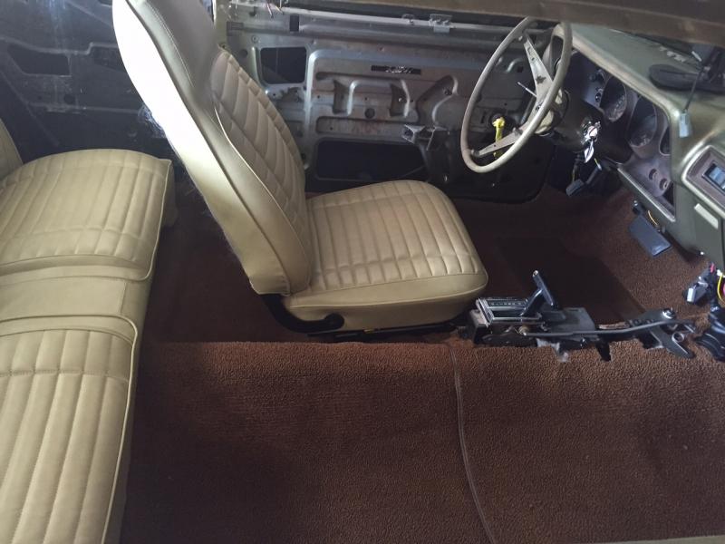

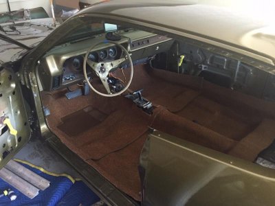

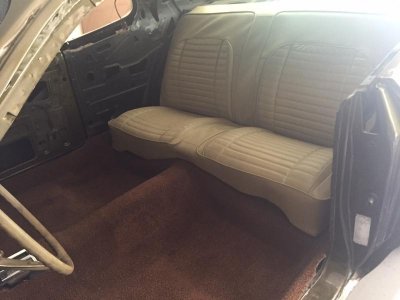

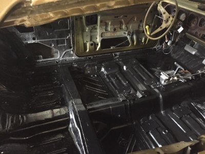

Here's some new pics of test fitting the interior.

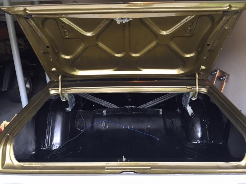

I applied a fresh coat of gloss black over the pans and trunk to freshen it up a bit. I know it's not correct, but neither is the rest of the car.
The seat covers are all from legendary, the carpet is from StockInteriors.com. The carpet color seemed to be the closest match to the multicolor faded gold/brown swatch i found under 4" of dirt.

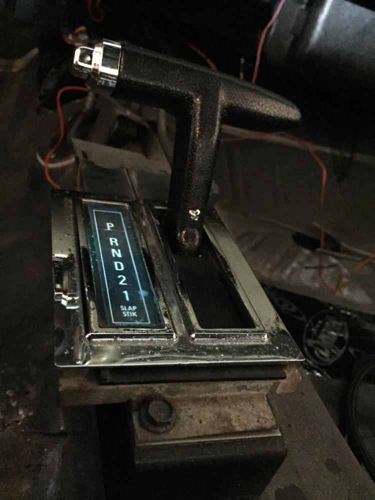

The shifter has an LED light to match the rest of the dash, the bulb cradle was unusable, so i cut one from the dash harness i saved for parts. The dash sockets are the same size.
