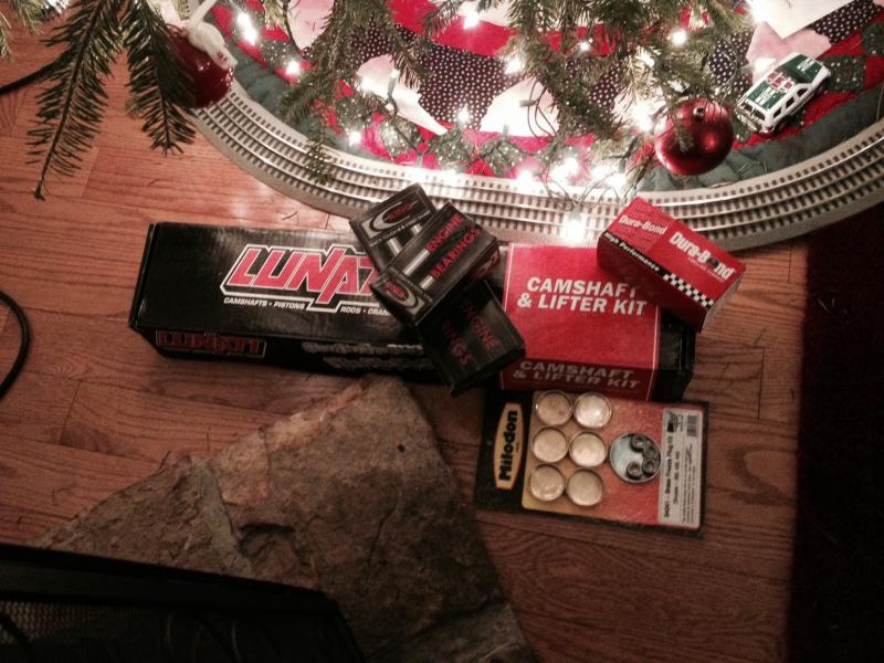

My BUDGET 451 build... finally
Looks like daddy was a good boy this year!
So what cam# did Santa deliver?
Hey grabber, it's the 704 cam. Voodoo hydraulic flat tappet. Super psyched!
Part number: 10230704
Advertised Duration (Int/Exh): 276/284
Duration @ .050 (Int/Exh): 234/242
Gross Valve Lift (Int/Exh): .513/.533
LSA/ICL: 110/106
SWEET HT413
Nice set-up!
