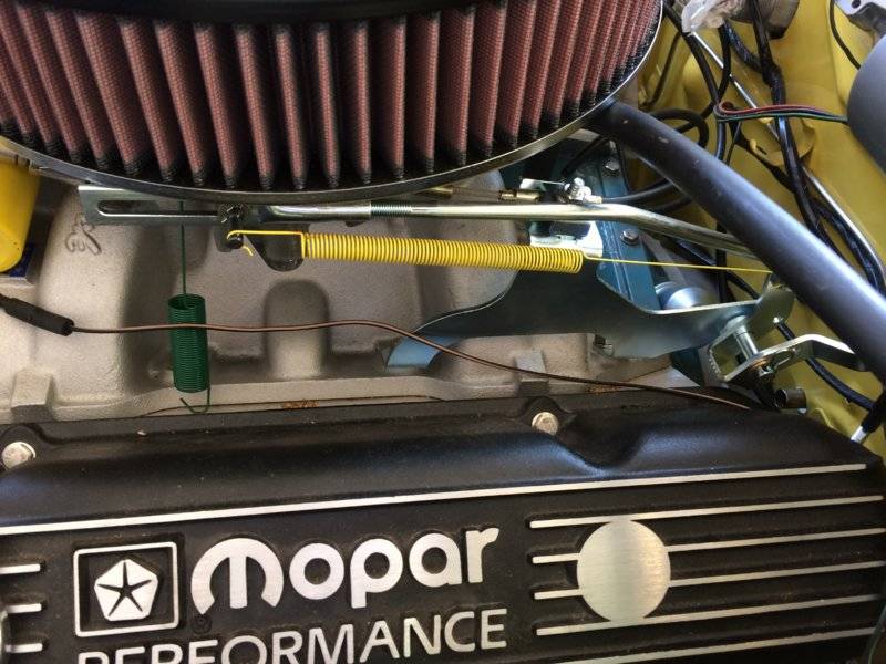

I've still been working on the engine bay. I have been figuring out some of the wiring, gas and air lines, and throttle linkage. It has been a learning curve for me to try and figure how all of these fit. I keep finding out that because I installed a taller intake manifold that it changes the fit of many other things on my engine. I tried several throttle linkages and finally had to buy a taller holding base and a longer throttle cable. Now my kick. down linkage would not work so I bought a kick down linkage from Year One. I now feel that everything seems to be fitting and working as it should.

I had some 440 stickers made for my K&N air cleaner.

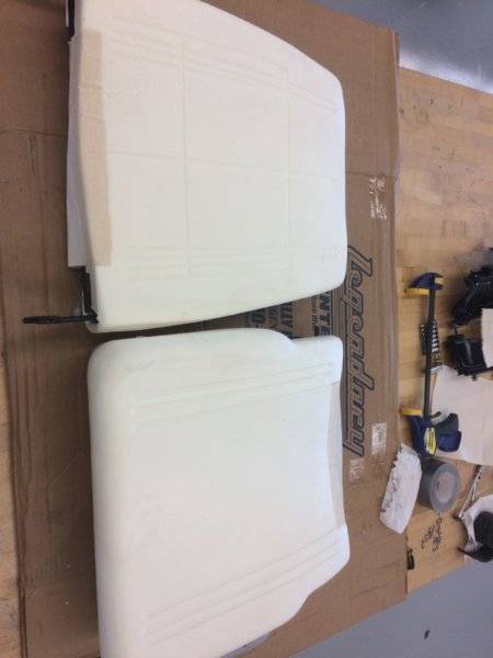

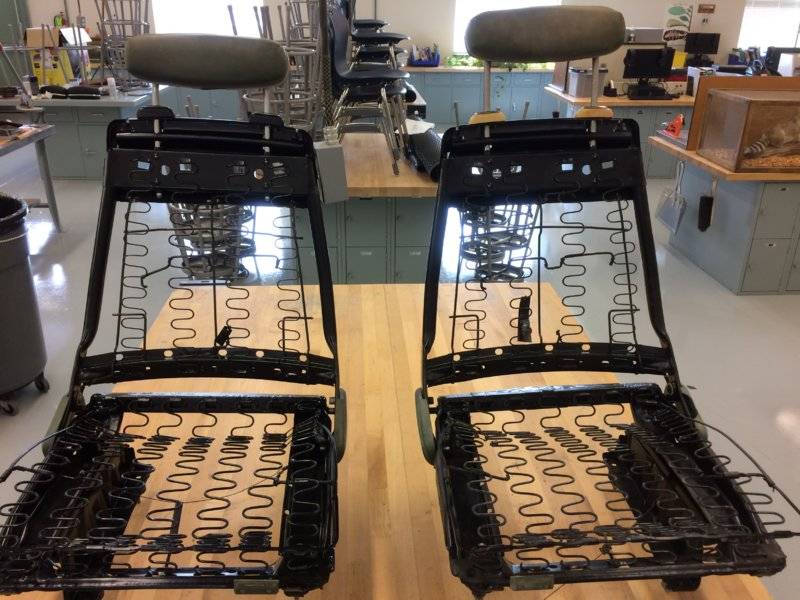

I'm Starting with the front bucket seats that I have already cleaned and repainted. I pulled up the Legendary Auto Interiors installation instructions on the computer and started following the step by step video and everything seems to be going good so far.
First I had to follow the video on how to attach the muslin cloth to the molded foam.
Attaching the burlap material.
Molded foam is on ready fro the upholstery.

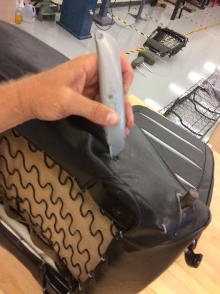

I worked on finishing up the front bucket seats today. The back seat was more complicated than the bottom seat but still not to hard to make look good.
Again I followed the step by step instructions in stretching the material over the seats and hog ring attaching them to the seat frames.

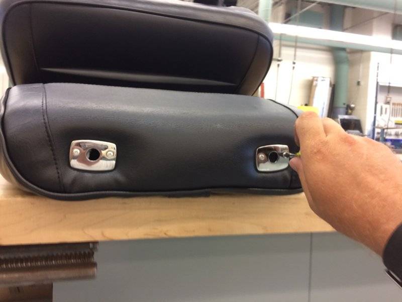

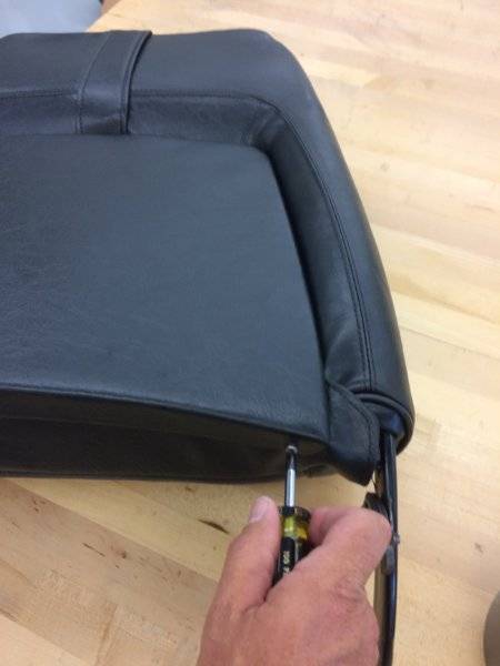

Clipping and screwing the bucket seat back panels.
Cutting out the holes for the seat back bolts.
I kept and reused washers, screws, etc.

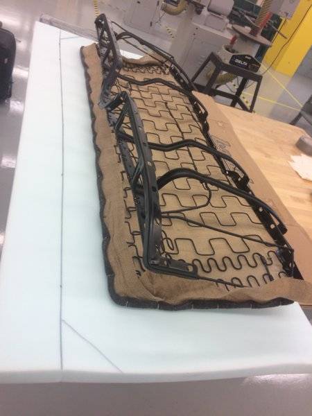

I started to work on the rear bench seats today. Apparently the instruction video, for the rear seats, has more confidence in my understanding because it hasn't been as detailed and they have skipped some steps so I hope that I can figure it out.

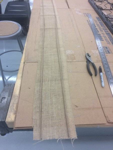

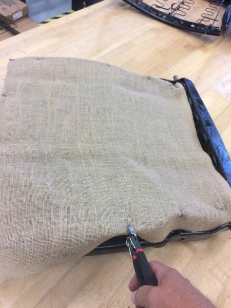

I started by getting them covered with the burlap material.

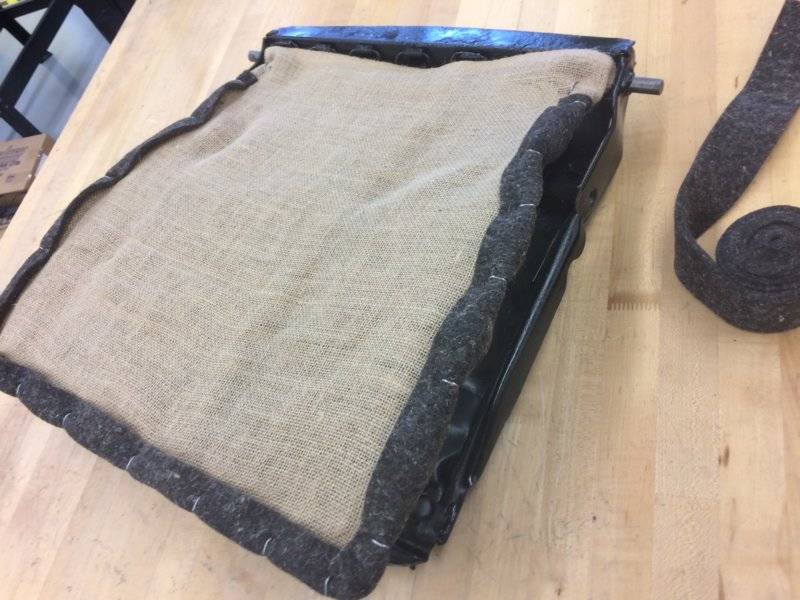

This next step, to put on this border to protect the foam from the seat springs, was not mentioned but I noticed when I was watching how to install the foam that the instructor already had it on his seat.

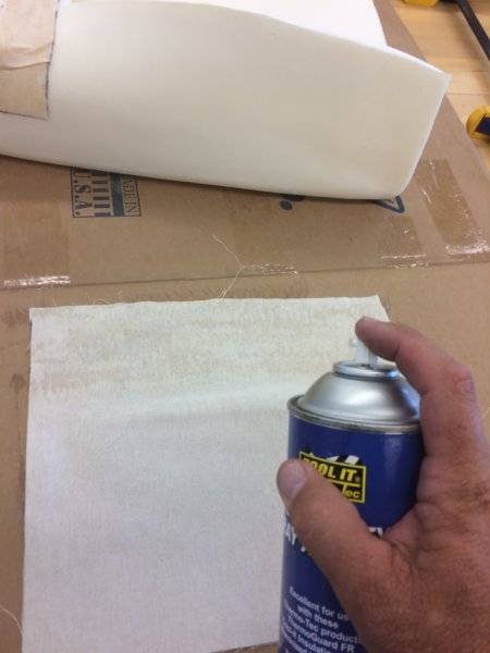

This foam is supposed to fold over and be hog ringed to the seat springs. The foam was so stiff that when I would attach it to the springs that it would slowly rip the foam and leave the hog ring on the springs and flip back open, even after using many clips. I ended up spraying adhesive on the foam edge and attaching some muslin cloth then the clips held and didn't pull through.
