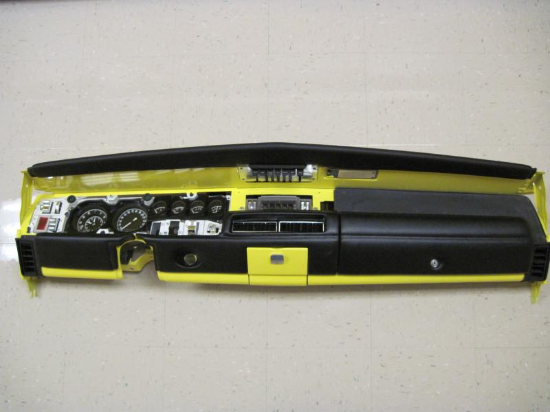

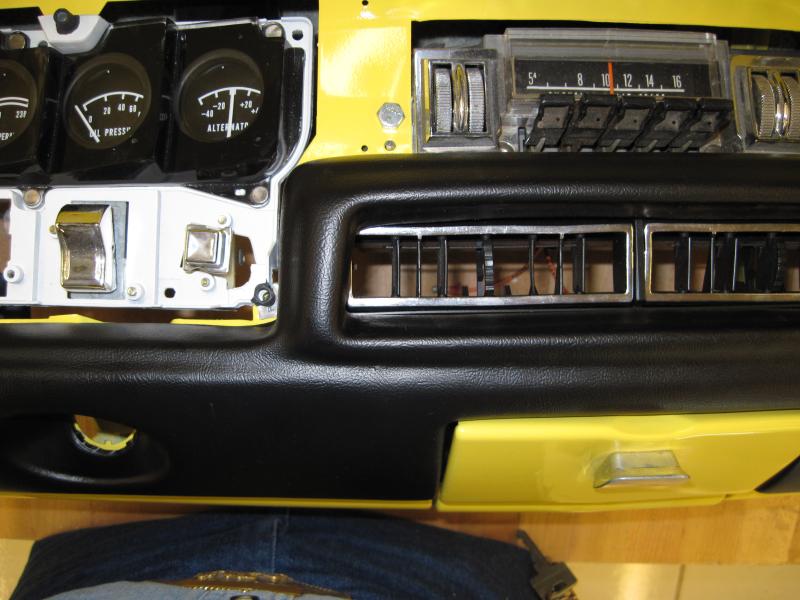

My lower dash pads were warped and hardened from the hot dry temperatures here. I contacted Just Dashes and they let me know that they will trim, smooth, and straighten any of the imperfections before recovering them so I sent my lower dash pads off to them to have them recovered. $825.00 later I got them back. They looked nice but after I installed them I found that they were still distorted and my center A/C vents will not move because the pad has shrunk over the vent corners.:sad2: I contacted Just Dashes and sent them pictures and asked if they could fix my pads. I was told that they did there job right and that if I wanted them fixed that I would need to pay for the repair and recovering. I have not had them fixed yet, I am trying to decide if I can live with it or pay to have it fixed.:eusa_wall:
I heard all good about them and this sucks, Spending that amount of money you would think there is some light at the end, I can "to a point" what they say, "we do the work, we can cover it" I really don't know how to look at it, once i spend that, and get it back, i EXPECT it to fit and work right, thats just to much to say "your on your own now" and it seems that's what there saying, There has to be something they can do, it sure doesn't make them look or sound to the rest of us to try a gamble, and to me, sending it in im expecting it to be right but IS a gamble!!!!

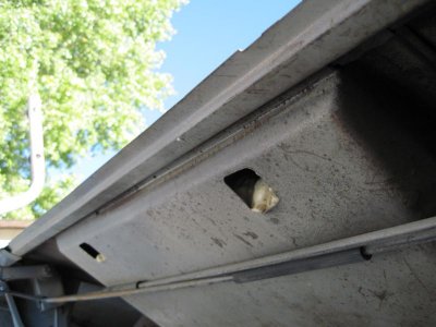

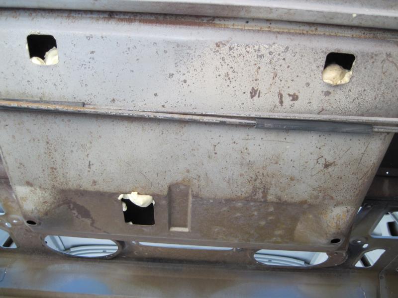

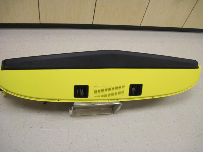

The rear deck behind the rear window on my car was floppy. We tried to heat shrink it but it would still tin can. We ended up filling the cavity with expanding foam and after it hardened the deck was smooth straight and solid.:)
We will clean out the excess in the holes and paint it and it will never be seen.

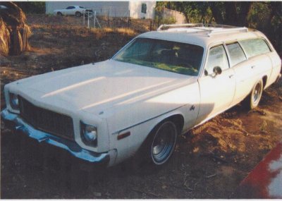

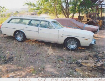

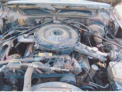

I found me a 75 Fury land barge with a 440 that I could rebuild for my charger.
Cool deal! Make that ride the way you want it, a 440 is a good engine as the 383 is to, sometimes better depending on the year and HP but it sounds like you have a good plan, have fun and i hope you'll keep us in the loop!
Good score on the barge/yacht!
Glad you did that, Ive been wanting to do the foam in that cavity myself but sceered it would screw up somehow. I'll do it now,
BIG THNX for the pics.. Supurb work going on here.

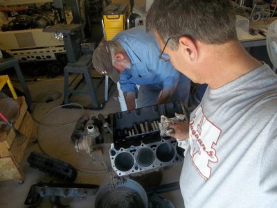

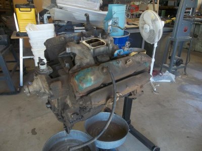

I removed the 440 and took it over to a friends garage (Dale Kelso, retired mechanic). Because I do not have much experience or knowledge about rebuilding engines Dale agreed to help me and show me what to do. I have wanted to do all I can myself on my car and am very appreciative of his knowledge and help.

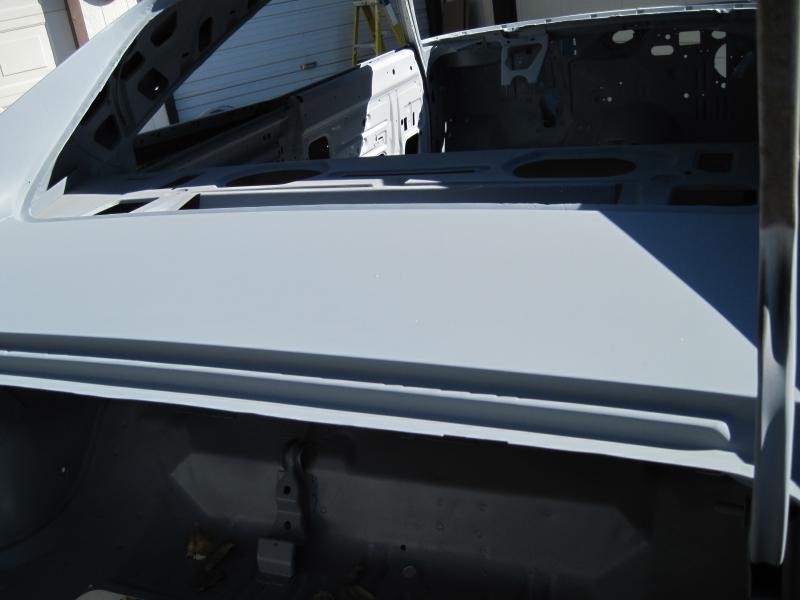

I am still waiting for my front fenders (on back order) to come. My car is now ready to paint as soon as I get my fenders fit.

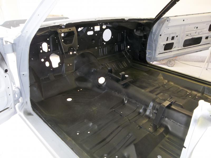

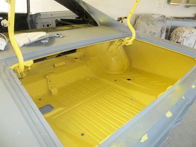

The inside of my cab is painted.

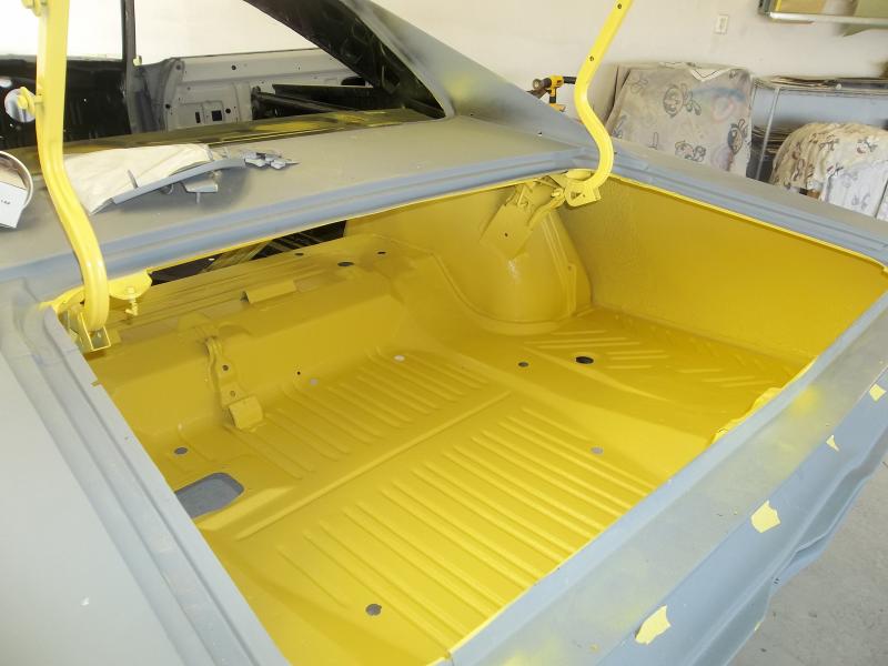

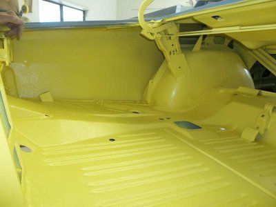

I had the trunk sprayed with a coat of bed liner and then painted with the finish color.
That is a good idea on the trunk paint! Very good work!
Question- Why black on the int instead of yellow?
That 440 looks pretty clean inside, good score!
I have been trying to decide what color to do on the interior. I decided black because the black paint is cheaper and I already had it and I would need to buy more color paint. All of the black interior will be covered and anything that will be exposed I will have painted with the yellow. I also had the inside of the doors and other panels painted black because the metal was raw from being media blasted.
Good ideas! I did some of the same type painting in doors and other bare spots.

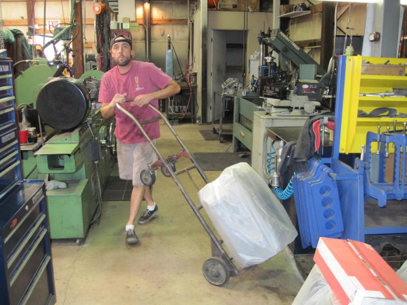

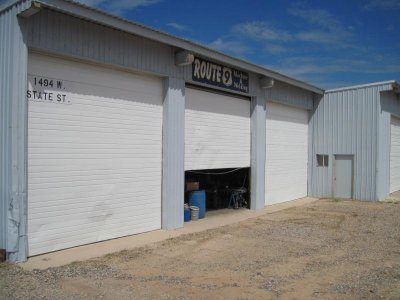

I took my disassembled engine to Rout 9 machine shop where Jim and Dave did the machine work for my engine. The block was in good condition and they bored it 20 thousands over because we could not find pistons for 10 thousands over. I got a engine kit with Erson cam and they ground and balanced the crank and cleaned ready to put back together.
