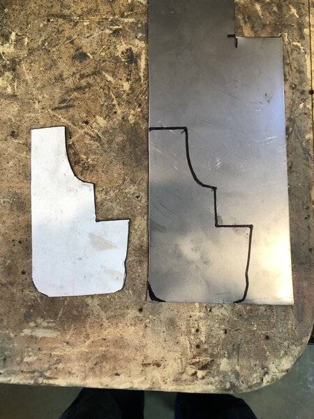

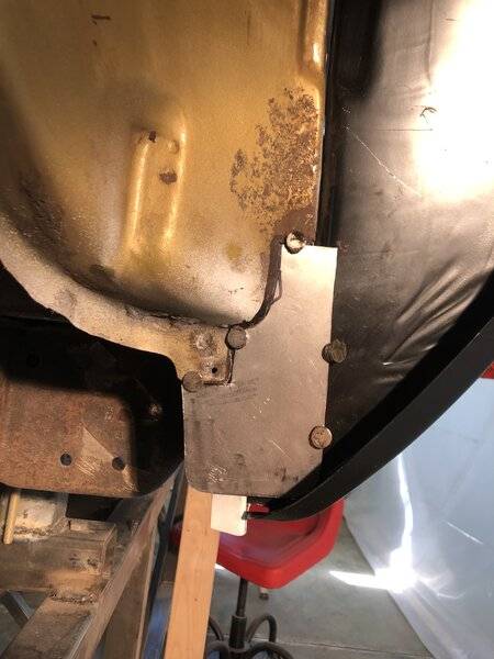

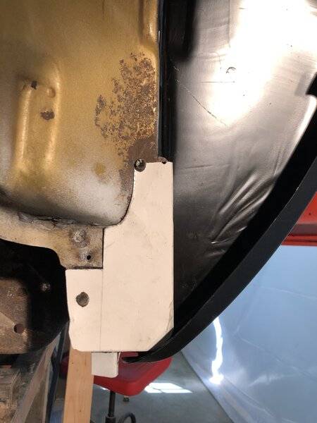

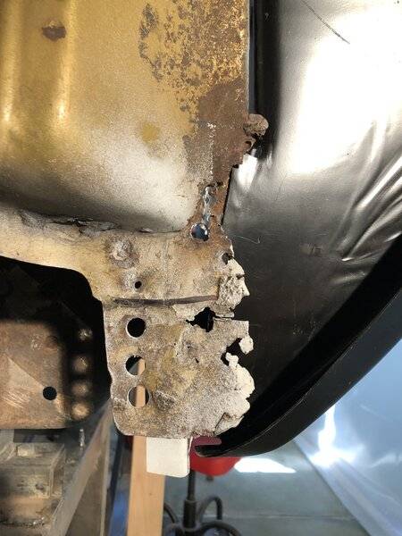

Today I tackled making a patch to replace the rotted lower flange on the right side inner wheelhouse. I made a poster board template then traced it on sheet metal and then cut it out.
Lower flange:
Template:
Sheet metal:
Tacked in:
Welded in:

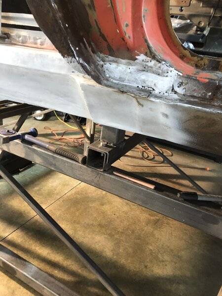

I then decided to patch the lower left corner of the right side door pillar. This section was rotted, as well.
Door pillar area:
Patched:
I still need to touch up this area a bit. Thanks for looking!

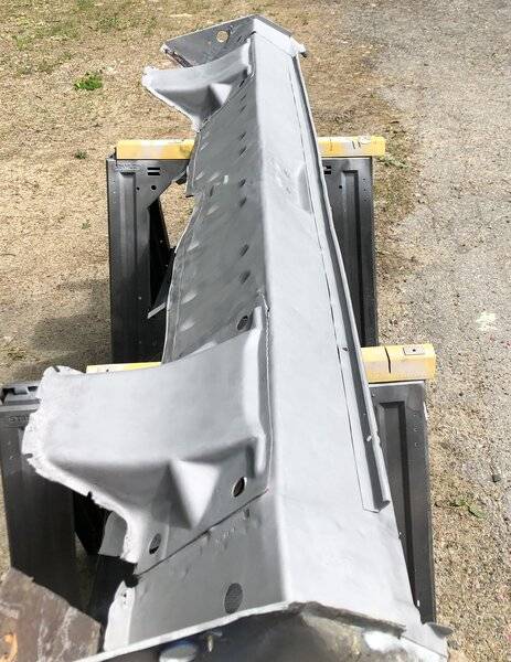

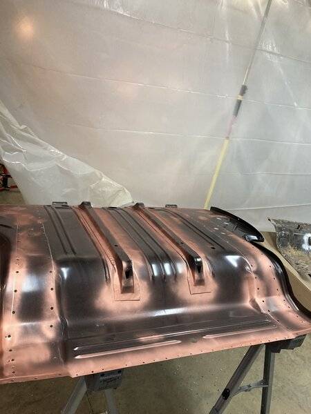

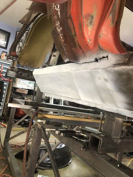

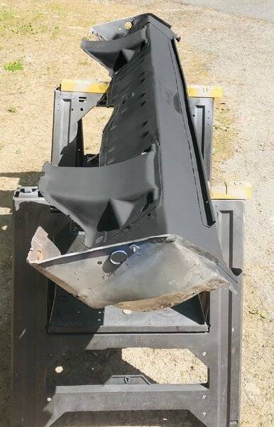

Not much to report. I’ve been working on cleaning up yard, mulching, replacing lamp posts, etc. I did get the replacement trunk panel blasted and primed. I do have to remove the end pieces and the trunk pan flange from it though. That’s for another day. I’m also waiting on trunk gutters that I ordered from Classic Industries almost 2 months ago. They are telling me they will be dropped shipped from AMD directly. That was almost a week ago...
Before:
After blasting:
In primer:

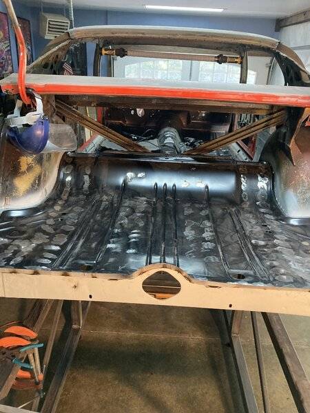

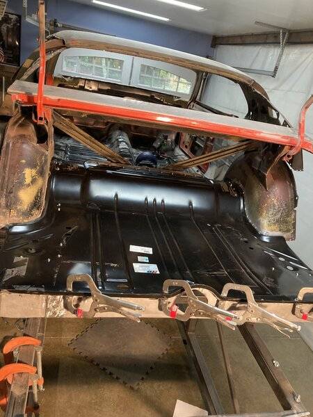

Started working on getting the trunk pan installed. The AMD pan pretty much fit right in.
Initial test fit:
Getting the trunk braces welded in and plug weld holes drilled:
I fit it back in and, of course, I ran out of shield gas. I was planning on going to the supplier this morning but they were closed for the holiday weekend. Damn! I’ll have to wait to weld it in next weekend.
Thanks for looking!

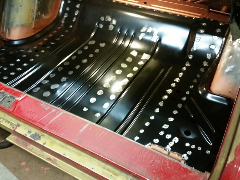

I got the trunk pan plug welded in and started to clean up the welds. I’ll have to go back and touch up a few areas but it’s not too bad, for my abilities I guess.
Been their done that also. Used a bit of the wire in one hand while welding to help fill in the holes that want to appear out of no where. So glad that is over was really tired of welding then grinding. That grinding metal get's past the mask and you goggles. Keep up the good work and it look's grate. Blue.
Thanks everyone! It’s a very tedious job. Welding, grinding, filling in those damn little holes, grinding again. I wish I could weld :)

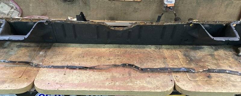

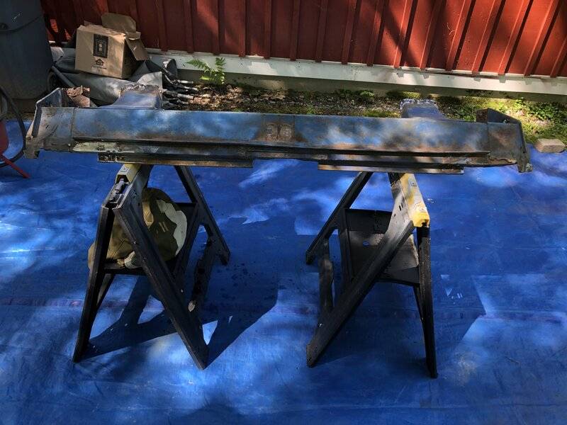

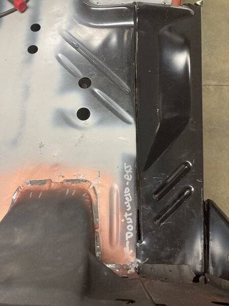

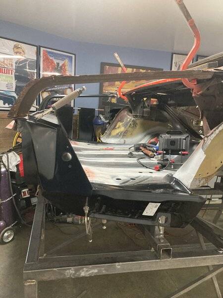

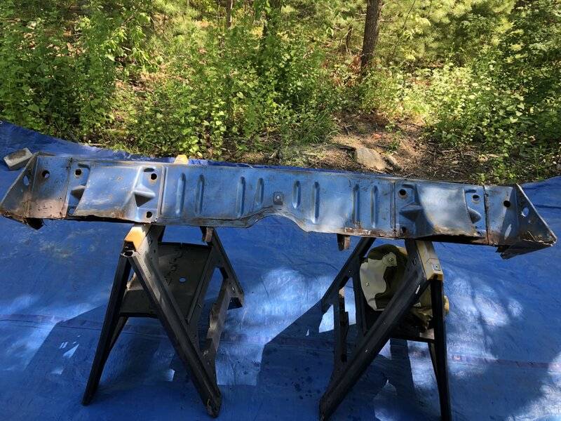

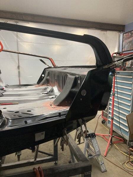

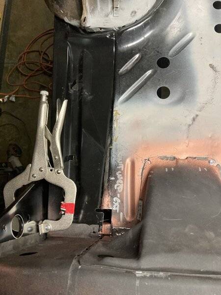

Some more progress, started mocking up the donor back piece of the trunk (I’m not sure what it’s called). I had to remove the lip that was left on from the donor’s trunk pan. I was able to remove it in one piece! I also mocked up the trunk pan extensions and inner quarter extensions. Ran into a small problem on the left side (forgot to take a pic). At the back, there was a 1/2” gap between the trunk pan extension and trunk pan. This gap was at the back and then ran to nothing about a 1/4 of the way, down the seam. After about an hour of measuring and remeasuring, I’m thinking that the left rear corner of my trunk pan was messed up. The small recess stamped into the pan in this area is way off from the location of the one on the right side. And the flange on this side is about 1/4” longer than the flange on the other side. I was able to rebend the flange to close the gap. I need to do (try) some more hammer and dolly work to make it look better.
Donor piece with flange remover:
In this pic, you can see the small recess to the right of the pan extension:
Right side pan extension, the joint is not tight, it’s not clamped:
Mocked in :
