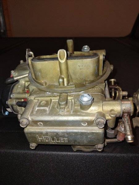

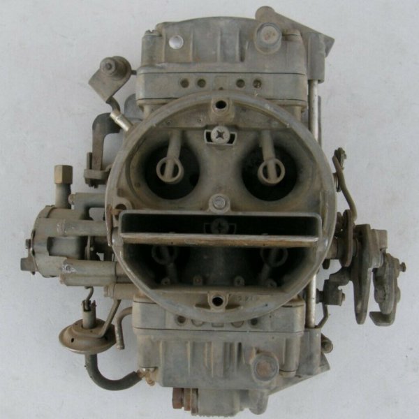

Shame you coudn't get the street demon working well enough.. i haven't driven with mine yet.. hope it works out.We just returned from vacation. When we were away I had too much time on my hands and found an original Holley Thermoquad replacement on Kijiji for $100 plus shipping. It is a 650 double pumper. It has not been run since the 80's so it will need a complete rebuild. What's nice is that it has both primary and secondary metering blocks, so I can adjust the jetting and power valves. I still have a stash of Holley parts. I did put an extra half turn on the secondary air valve on the Street Demon. I will check to see if that helped. I also plan to test the Holley on the 361 before I do the 400 swap to see if it is worth using.
I think he meant that he got a spreadbore Holley - a replacement for a Thermoquad, but still a spreadbore carb.Shame you coudn't get the street demon working well enough.. i haven't driven with mine yet.. hope it works out.
P.S. Thermoquads were made by carter, you have just a holley 4 barrel![]()

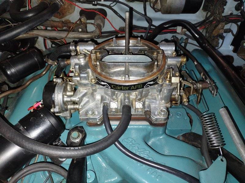

I went for a short drive today, and it will still not take full throttle from a standing start. No problem from a roll though.Shame you coudn't get the street demon working well enough.. i haven't driven with mine yet.. hope it works out.
Now that you have put in half a turn clockwise you should test it at highway speed, when you go full throttle the air valve will start opening and you can feel how it's working.I went for a short drive today, and it will still not take full throttle from a standing start. No problem from a roll though.

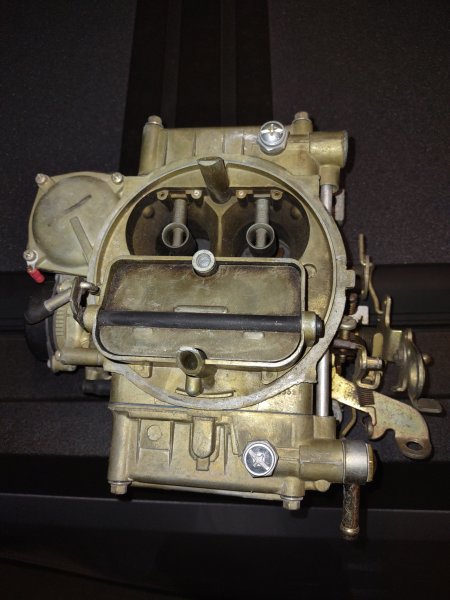

You do know that electronic ignition is the devil's work?I went to buy a rebuild kit for the spread bore Holley, and my dyno operator talked me out of it, figuring it wouldn't solve my bog problem. On his advice I now have a deal pending on a Holley square bore 600 vacuum. He also recommended more initial timing. I was still running the stock points distributor in the 361. I decided to swap over to electronic ignition now, before the engine swap so I could use my recurved distributor, the same one I ran on the dyno. All went well until my dial back timing light quit working. I got it running, but I'll have to see if I can borrow one to get the timing set.

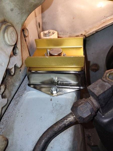

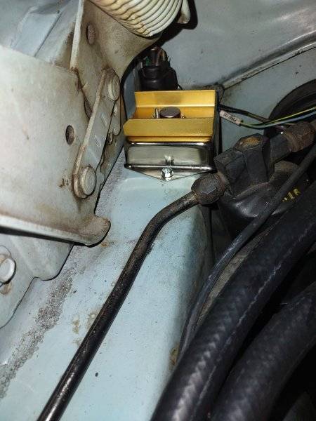

You need to have isolated dual fields for the electronic regulator.I have a couple of electronic regulators that I couldn't get to work before, so I guess they we be my back ups if the mechanical regulator doesn't play well with the ECU.
