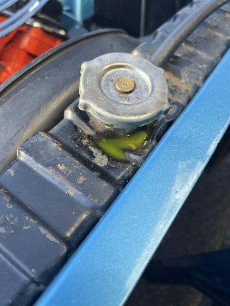

Update: took for cruise, temp never above 190-195… return home and let idle for 15 minutes. Temp the same. Put cardboard in front of radiator to raise temp, when up to 220….and a dribble out the radiator cap.(see pic)
Removed cardboard, temp back down to 200.
Shut motor off, NO SPEWING!!!!!
I don’t get it..

Pic does not look like a COOLANT RECOVERY SYSTEM PRESSURE CAP......is it? Whose brand name is it??.....quit worring about the minutia or inconsequential stuff.....210° F IS NOT HOT.....as stated b4 with a 50/50 mix of coolant and 16 psi pressure cap (either type), the temperature will need to exceed 265° F to become hot......just run it as is......
BOB RENTON
BOB RENTON

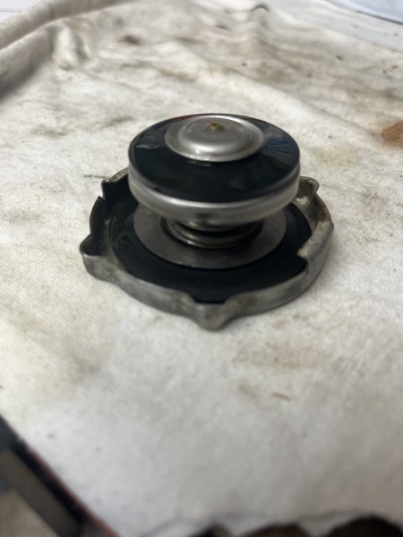

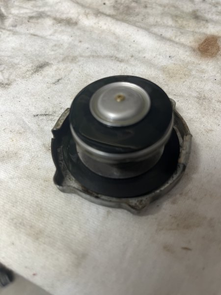

First, there’s no name on the cap, its the one that came on the car. The new one i bought at Oreillys, didn’t fit as tight.
Second, i have no idea what a “ coolant recovery coolant cap” is. The car had no recovery bottle on it when i bought it, just a drain hose from below the cap. I decided to reduce the coolant spewing all over the ground, to install a catch can which that hose now goes into.
I don’t feel spewing coolant is inconsequential, so i guess I’ll worry until this issue is resolved. Together with all the help i get here, im sure I’ll get it done.
A coolant recovery cap will have 2 gaskets, 1 at normal spot at lower lip and another to seal at upper lip of fill port.
I had drained my rad one time. Refilled it and had an overheating issue. Loosened off one of the heater hoses at the firewall to bleed it. Might have been the inlet side of the heater. Waited until coolant came out, and tightened the clamp. Did have the heater controls set so coolant could circulate. This was over 25 years ago. Everything worked fine.
This is what came on the car when i bought it…

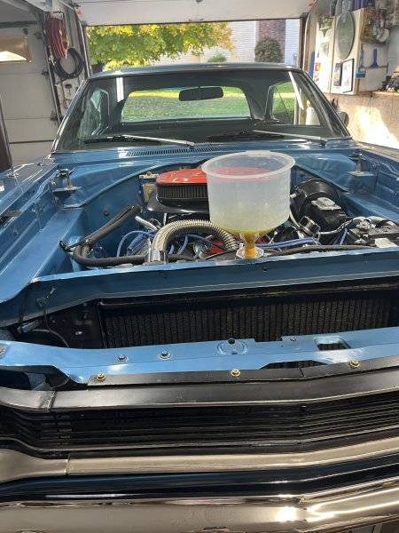

Ok…. Bought this kit, arrived last night. Installed this morning, ran car up to temp. -and for
about 15-20 minutes.
LOTSA BUBBLES. Once bubbles stopped, removed kit, then removed small amount of coolant from radiator to make level about 1” from fill neck…. Fingers crossed!

Fan diameter is 19.5”, opening of shroud is 20”…. Radiator cap is new. There are no seals on an A12 lift off hood. So far, after”burping “ the air out of the radiator, no issues
Update;
Since reducing the air in the coolant system, correct coolant level, new rad cap…. No overheating issues!!!!
I want to thank EVERYONE for all advice and suggestions!!!!!
