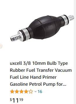

Easiest, cleanest way to drain. Take a length of aquarium hose, mark it an inch shy of the dipstick tube length and stick it down the tube and then the other end down under the car. Suck to get it siphoning into a container and go have a beer.
Bulb pump from amazon handy to have.

I'd rather use that little pump bulb like in post 25 but might use an old Holley fuel pump instead. Got a few of those still laying around. Can only imagine how much it takes to get that fluid up by mouth.....kinda like trying to drink a thick shake through a straw?
