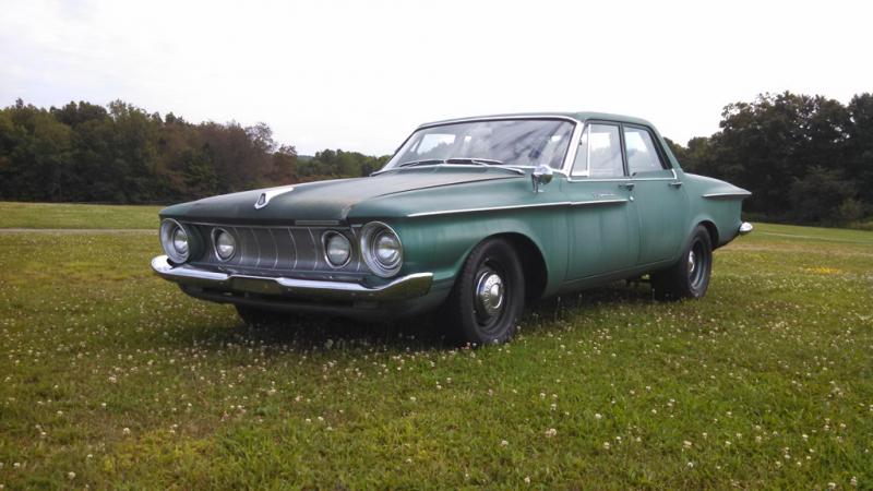

My Dad frequent's here often, so I thought I'd post my combo to share with you guys.
The car started as a 12,000 original mile "Barn find" that was destined to be cut up as a parts car for a convertible restoration. Fortunately for me, they didn't end up using the car so it sat at a friends for quite a while under a tarp. I ended up traded three pushbutton transmission rebuilds (he bought the parts, I did the labor!).
It's gone through a few drivetrain itterations since I started (mostly because it kept breaking stock parts as I continued to turn the power up!!!)

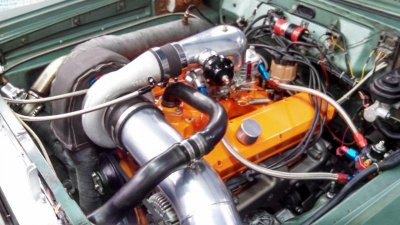

Currently it's a cast crank, stock block 360. Ported Eddy heads with a small [email protected]" hydraulic roller, and a non intercooled 75mm turbo pushing 15~16psi on E85. It just uses dodge magnum truck manifolds flipped backwards (no fancy headers here!).
Car still has the pushbutton in it, Dana 60, and a 3.55 gear on 275/60 radials. At 3740lbs it's been a best of [email protected].
Anyway... thought you guys would enjoy it... take a look at the pics/videos. I'm trying to get the turbo knowledge passed on to the mopar community, so ask away!
Scott

Thanks guys... combo is the following
Stock '91 roller block with 1/2 fill
stock cast crank (not even turned)
Eagle H-beam Rods
Diamond Pistons
CNC ported Eddy's
9.2:1
[email protected]" .540" lift
Victor 340 intake
750HP carb converted for E85 blow through
9.5" PTC converter
727 pushbutton with Trans Brake
Dana 60 3.55 gear
Cal-tracks with mono-leafs and good shocks
275/60 drag radials (non-pro's)
The car runs 9.80's in the EXACT same form I drive it on the street. I drive it to work, kids to daycare, etc... it's so tame it's unbelievable.
Turbo is a cheap $650 borg warner S475, fed by 94 dodge ram magnum manifolds, with 4" exhaust all the way to the bumper.
I had a few people grumble that it's only got a roll bar (not a cage), but it's only been 9.88 so not too far under the rule. When I ran at Norwalk for the 10.0 deal I just slowed it down a touch, and dialed near 10.0 in Pro the same night. I went to the last 5 cars in pro, and the last 3 in the 10.0 shootout before the front pump seal nuked itself from too many hot laps double entered and spewed trans fluid all over the starting line!
It's got a LOT more left in it... I'm just scared to lean on the stock block/cast crank any further... lol It's got to make 750~800hp I would think which is well beyond what most will say a small block will take. But these turbos are SOOOOO easy on parts. You don't need a lot of RPM or timing to make them fast. Keep it out of detonation and they will take a lot of abuse.

Your car would go way in the nines with the current 62 motor. Don't know what your car weighs but it looks lighter than mine at 3340. My bet is it would run 9.40's easy at 3300lbs and only 15psi. And be completely streetable.

This particular turbo is what they call a "mid frame" which is a T6 flange. You are right... it is huge... TOTALLY un neccisary for the power levels I make. That being said... it's actually fairly SMALL compressor wheel inside a huge casting. This turbo can be re-machined to support 1200+hp with the larger compressor wheel. The only reason I bought it is because it was cheap $650~$700. My new kits will have a much smaller T4 turbo. Still supporting 600~1000hp depending on version.
I would say this motor probably makes 400hp on motor alone. It's got nice heads on it, but it's only 9.2:1 compression, and with the small 1 7/8" outlet manifolds, I'm sure that wouldn't help it in N/A form. I run it around 15~16psi, so usually 15psi will double the HP of a motor. I am pretty conservative with the timing/fuel tuneup, so there is probably room to make it better, but it already FLY'S...
I didn't use a big block for a lot of reasons.
First... there aren't really a lot of great manifolds to work with that can be flipped backwards, the small block one's worked very nicely for that.
Second... someone gave the the motor. It was out of a county work truck bought at an auction, so free is good.
Third...Small reasonably priced turbo's can make insane power on small motors. If you have a big motor, you will need a big turbo to feed it or it will choke on the small exhaust side of the small turbo. Big turbo's can be MUCH more expensive (i.e. 2x~3x more)
