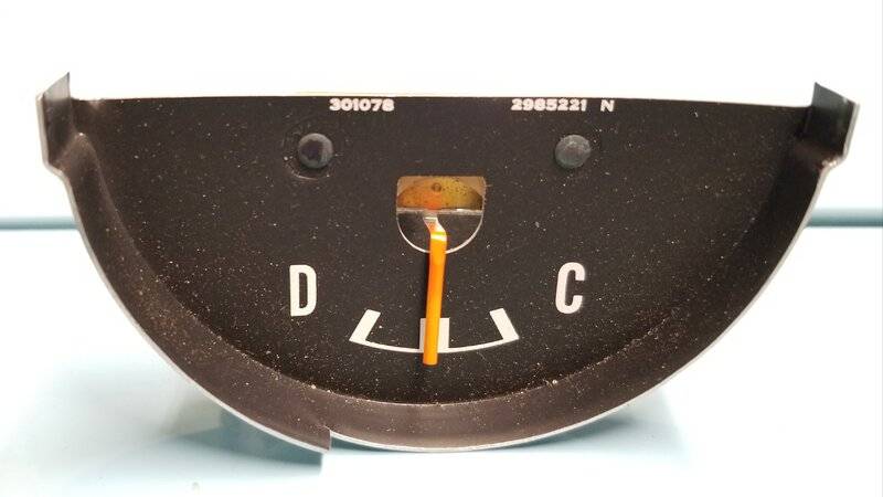

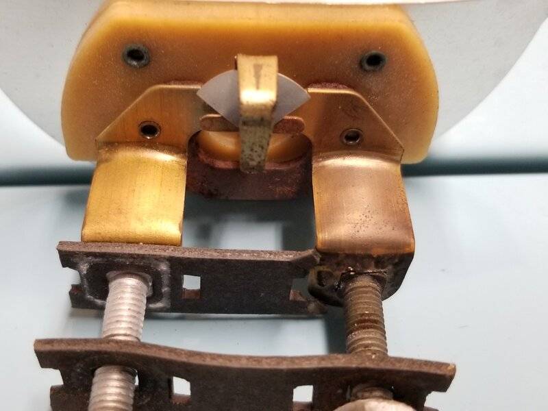

Here it is, if you still want it, I'll box it up. As you can see, a piece of the insulation broke off.
