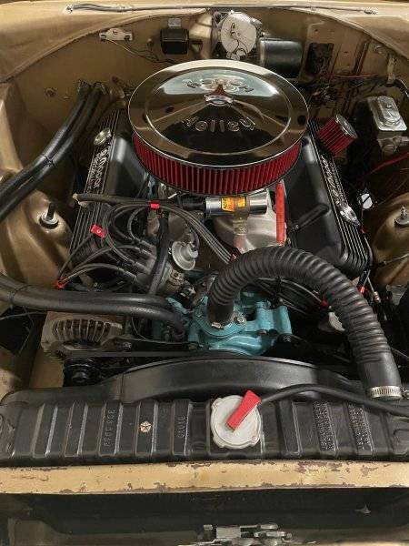

So guys, firstly I would love some help/advise about buying a prebuilt motor and transmission, and selling mine. I was never able to get into any mechanical stuff with my dad before he passed and have 0 experience with motors/transmissions. I have the opportunity to buy a prebuilt date code motor and transmission for my R/T to bring it back more original, which for my build, 9-8-66, is very hard to find. The build date on the motor I could buy is 8-10-66. However, I don't have a clue about what questions to ask, or things to look out for. I have discussed with my uncle, a 40 year body man who has restored many Mopars over the years, but he freely admits that he is not an engine guy and can only help a little. His biggest concern being that the block is bored 0.060 over. From what I have read that may, or may not be an issue.
I did speak with the guy selling, did a little research, and he does run a mopar restoration shop, and the motor was built by an engine builder who also drag races. So, I do know that this was not built in a back woods garage somewhere, if that helps. My uncle was not privy to this information when he read the listing. I do plan to discuss this with him as well, and see if he will call the engine builder.
What would I be looking at to finish the set up to be able to install; parts and cost wise? I know I would need carb, alternator, ignition, starter, plugs and wires, but anything else I should be aware of? Can I use what I have on my current motor, or should I include that when selling?
Additional information: I do have two sets of C440 HP blocks, 915 heads, crankshafts, correct 67 exhaust manifolds, but no other parts that I have the option to build from scratch (or sell), but they are not date code correct for my car. Would I be better off building from scratch and am I too hung up on the date code?
I have listed the specs and pics from the listing below. I would really appreciate any feed back, advise, concerns, hesitancies you guys have that could help me make a more informed decision.
I understand the basics, but above that really don't know what I am looking at here, and as always thank you guys for your help, it is ALWAYS appreciated!
Engine listing:
For sale- Freshly rebuilt, 1967 440 HP engine, the later valve covers are installed to keep it clean, the factory chrome covers are included but they need replated (AMD reproduces them but they're on backorder), this is about 10.0-1 compression, the cam is a Comp #21-223-4 w/268/280 duration & .477/.480 lift, it is .060 over, KB pistons, when I got it, the bottom end was recently rebuilt, I had Randy Beyer of Beyer Racing Engines (40 years plus experience) take the bottom end apart for inspection, go through the heads & rest of the top end, I installed a new bearing & seal in the water pump, I acquired the correct exhaust manifolds w/new heat riser & hardware, A mint restored 67 air cleaner is included, correct intake, new motor mounts, new plug wire looms, throttle return spring bracket etc., primed & painted it with eurothane paint (I know, mopar used enamel but this will last). I did not install the throttle cable bracket as I don't know if the buyer will use an auto or 4 speed ( a little touch up paint is included). The casting date is 7-7-66 & the machine date is 8-10-66.
Secondly, in order to help offset the cost I plan to sell the 66 383 and transmission that came with my car. Again, I have no experience and can't find much in my research as to what would be a fair asking price. It has a 750CMF Holley Street Avenger, Lunati Cam (I can pull the specs off the box), and 2400 stall converter. That is about all I know. Here are some pics for reference. Again, any advise or input on what to be aware of would really help.
I know I have packed a lot in here. Again, you guys and being part of this community are GREATLY appreciated!

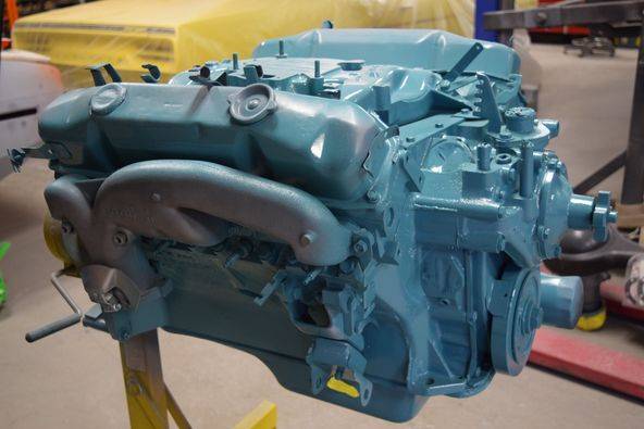

Intakes and distributors will not swap, yours is a B and the other is a RB. Everything else will swap but I'd sell yours complete as a runner but check your heads and make sure you are not letting a pair of 915's pass you by. Are the small chamber 915's on the motor you're looking at? 0.060" over is pushing it. That's what my current engine is and I'm building another standard block - I'll use the 0.060 engine to wring stuff out but it's history as soon as I finish this one. You could always sleeve the block though, mines not worth it.
Chuck (snook)
Hi Paul,
Here are a few random thoughts of mine (in no particular order):
  • For you, the right date code seems important, and it makes your car that much nicer. Although it would cost some money, if needed you could even sleeve the .060" engine. The right date codes are hard to find, so if the price is not unreasonable, I would make my best deal on this.
  • I would not be afraid of a properly checked and built .060" over 440. The key terms there are "properly checked" and "built". If a block has significant core shift, then some bores can be thin on one side. You especially don't want thin bores on the thrust sides of the bores (the thrust side of the bores are the right side of all bores as viewed from the back of the engine).
  • Opposite of my above statement, I presume that you are not going to be drag racing this car and engine. So concerns about wall thickness are reduced vs. an engine that makes 700 HP and gets beat on down the quarter mile.
  • If I was going to buy an engine without rebuilding it, I would much rather buy an engine that had 1000 mile on it or so, as it shows it was at least done well enough to go 1000 miles without destroying itself. This appears to be a fresh rebuild that has never been run. It could be perfectly rebuilt, or it could have lots of mistakes made during the construction.
  • If you can talk to the builder, I would ask if a honing plate was used when the block was honed to its final size. A honing plate is a big thick piece of steel that is bolted to the engine block. It mimics a head being bolted to the block, and it distorts the block similar to the way a head would distort the block when installed. This way you are assured you get round cylinders with the head bolted on the engine. This technique is much better than not using a honing plate. I would also ask if he checked core shift or wall thickness.
  • Assuming my assumption is correct that this is rebuilt but never run, I would pull the engine apart, at least partially, and check things. An easy first clue is how well has the cam and lifters been coated with appropriate starting lube? If not done, this engine likely has problems in other areas.
  • So bottom line on the 440: There is no other way around it but to say buying this engine is a gamble. But, it is the correct date code, so then you just need to decide if you want to fire it and take a chance, or pull it completely apart after buying it and be sure.

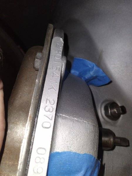

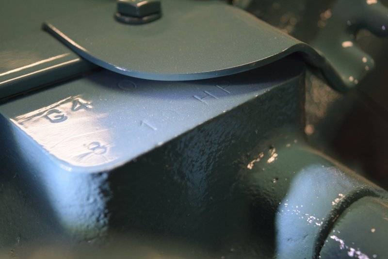

I got to ask... Are you just wanting more engine or is there a problem with the 383?
To me ( date code correct ) is just a term for not the original motor. At that point its no different than a 76 block.

"Date correct" means a hell of a lot more on a 67 or earlier car.
It basically means- "the original engine", unlike 68 and up, which had VIN stamps.

Getting from "no VIN stamping on block" and "date code in range for body date" to "good as or identical to original engine" which can't be proved not to be ..... is purely logical. In fact it's relatively easy.

@YY1 This is what I think as well when considering "Date Correct". 67s have this ability to more easily be brought to originality and preserved. Unfortunately over time (with all years) this has gotten harder and will only continue to get harder. I do thinks it's always worth keeping an eye on and if the right opportunity presents itself to consider it. Exactly why I created this post.

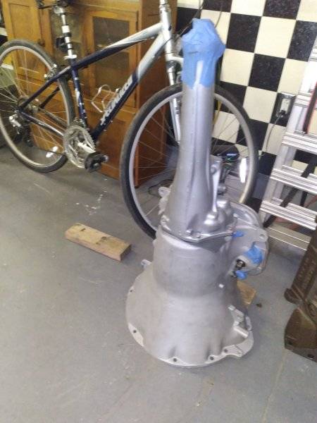

Engine listing:
View attachment 1317659View attachment 1317658
View attachment 1317665View attachment 1317667View attachment 1317666View attachment 1317664

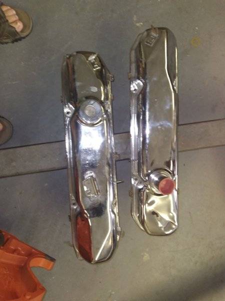

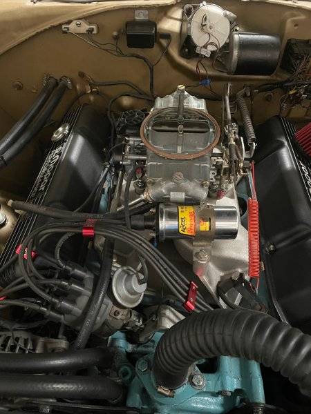

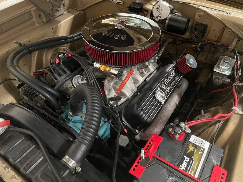

View attachment 1317672View attachment 1317673View attachment 1317674
