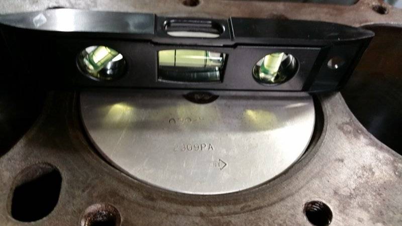

OK i finally put the crank and a single piston back in. Its a flat top piston and as you can see in the picture the cylinders have relief cuts. At TDC i was able to get 12.2 cc in it before overflow. 30 over pistons.
Who is the math person who can tell me my compression ratio now. Also yes i know when i took the picture i was not yet level
You won' like what I came up with. First, a LOT of assumptions. I'm going to assume your measurement is correct for volume above piston to deck. Next I'm assuming something like a standard felpro gasket and UNcut 906 heads. 915s or aftermarket heads, steel shim or thick cosetic gaskets substantially change the numbers.
Swept volume of 030 over 383 is796.9cc
Volume above piston to deck (your measurement) 12.2cc
ASSUMED measurement of gasket, 4.4"bore, 035 compressed is 8.72cc
ASSUMED 906 head UNcut is in reality around 88cc.
Calculation is 796.9+12.2+8.72+88=817.82÷12.2+8.72+88= 7.508cr.
Now remember, this is ALL a guess. Actual measurement of head cc.s ,actual head gasket, actual deck hight ( feeler gauges under your level might be close enough) will give much more accurate results.
