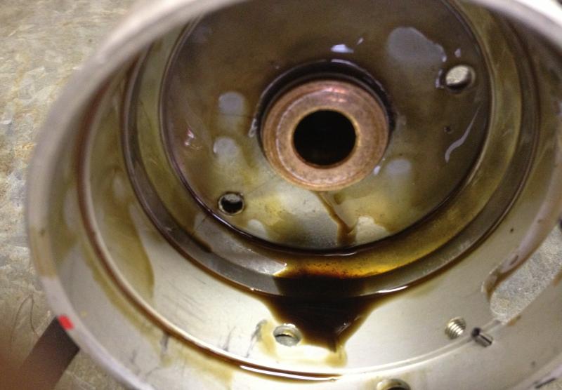

I originally took apart the distributor and it had a teaspoon of oil in it.

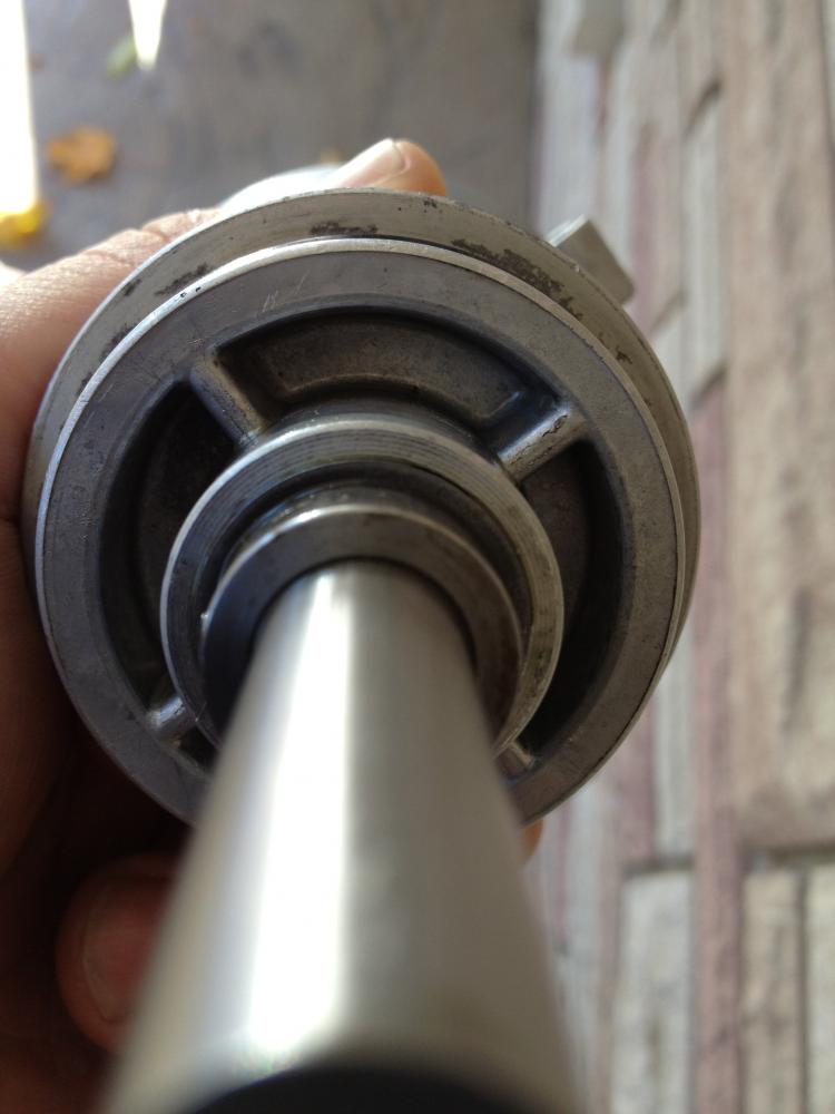

dryheat, I am running no vacuum advance but good point. I took apart the distributor and found oil inside and decide to add a larger shim diameter. I think the oil is forcing it's way up the oil port in the bottom of the distributor and working it's way up threw the bushing. Should I add some felt to the oil ports, and a larger diameter shim to cover the ports?

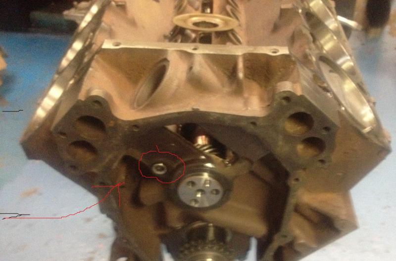

This might be a silly question because I have never seen oil come out of the disributor. Oil must be under pressure to be violently thrown at the bottom of the dist. The only place there is pressurized oil close to the dist is the pipe plug blocking the end of the lifter rail. It might be possible to be loose enough to squirt oil under hard acceleration, or might be missing altogether. I have a hard time believing that non-pressurized oil can get past two bushings with enough volume to flood the dist and leak, just a thought.
69Bee, I agree with you. I cannot understand it either. Is this the plug you are referring to.april 2012 035.jpgoct14 001.jpg

I was and wasn't talking about that plug. On the RB, there should be an inner plug on the lifter rail, but not the B I guess. I just verified on a 400 I have in here. The excessive clearances could contribute to the problem, and can be fixed by most any machine shop. They just ream out the old bushings, install new oilite bushing stock, and hone to size. I would expect to see something along the line of 0.002" to 0.005" since my 69 manual says to rebush if over 0.006".

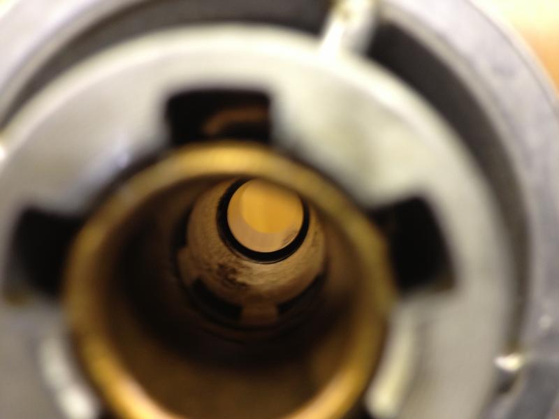

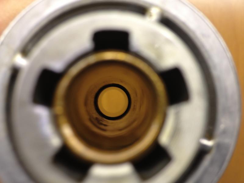

69Bee, the block I used is a 400. I removed the lower bearing last night, and will have to get a new one machined. It is a weird OD. The inner is a standard .500, I pulled it because it was not 100% round. After using a telescope gauge I measured .050 on the top bushing, and .051 on the bottom bushing. The top measurement was the same in all positions on the bushing. The lower was not the same in all positions. Some were .050, .051 and .052. The distributor shaft was .047 on the top and bottom.
I am not following your measurments. You start out by saying the id std is 0.500", but then go to 0.050" to 0.052", and the shaft is 0.047". Are you saying the bushing measures between 0.500" to 0.520" and the shaft is 0.470"? If so, the clearance is approx 0.030" to 0.050", and too much.

Sorry 69Bee, I made a mistake. I remeasured it. The distributor shaft is .497 and I meant to say .500 for the top bushing all around. For the lower bushing it was ,.500, .501, and .502.
The lower was out of round. Still within spec. Sorry if I confused anybody.
oct21 010.jpgHere are my results. I replaced the lower distributor bearing and installed a fitting on the distributor base drain hole so I could hook up a small vac hose to route the oil some were else. This would show exactly were the oil was coming from. I now have a diameter of .499 on the top and bottom bearing, and the distributor shaft is .497. A difference of .002th. I added a larger diameter shim on the bottom of the distributor to cover the 5 oil holes and set the end play to .007th. I tried about 10 wot hits and sure enough oil is back in the distributor. It probably blew out 1 tablespoon. There are no signs of oil around the distributor base, heads or valley pan corner. So I thought maybe the 4.15 crank I used was throwing the oil up into the distributor oil holes, and by blocking the distributor oil holes that did nothing. Trying to set the end play on the distributor from .023 to .007 thou also did noting. I drained the oil today and thought maybe it was over filled. I removed almost 6 quarts. I am using a 440 source hemi oil pan with a 440 source stroker windage tray. I am also using a Melling high pressure and standard volume pump. Could any of these items be affecting this. Maybe the oil is not draining back quick enough on wot due to the windage tray. Is there away to check the crankcase pressure under wot? This has to to be from oil pressure pushing the oil between that .007th gap, or is it from the top of the engine being flooded with oil? Maybe the pan is to small? Any ideas?
