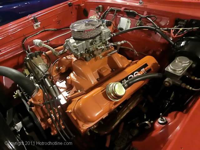

I just wanted to let you know that I used to run a PCV valve in my old 440 with the MP .557 cam but when I built this 493 I used a stouter cam that has .264 & .270 @ .050. So I run two breather caps like you see here on each side. I used heater hose and run it down to the wheelwell and tie them there just leaving the breathers open. I did not tie them into my headers as with a full exh system out to the rear bumber I was not sure it would work good. This has been perfect for me with no leaks anywhere and no oil ever drips from the hoses.
