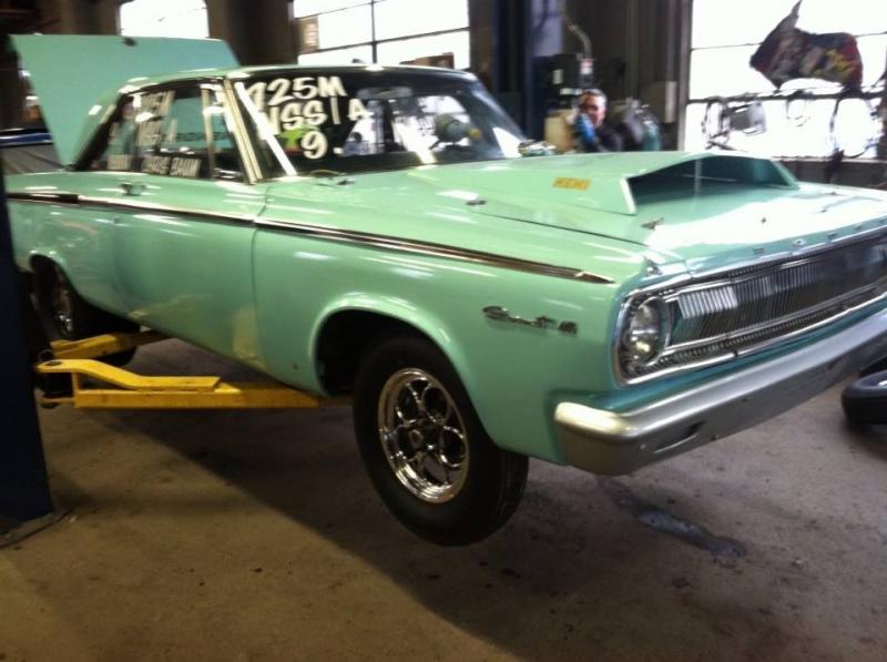

Wheel wells all opened up. Only way was to use this stretching pump that Jimmy had at Vignogna Racing Engines. Had to try it in 4 different places and stretch them about 5/8" on each side. But no more rubbing.
And it got 4 new tires and wheels too.
