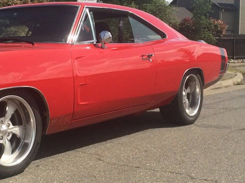

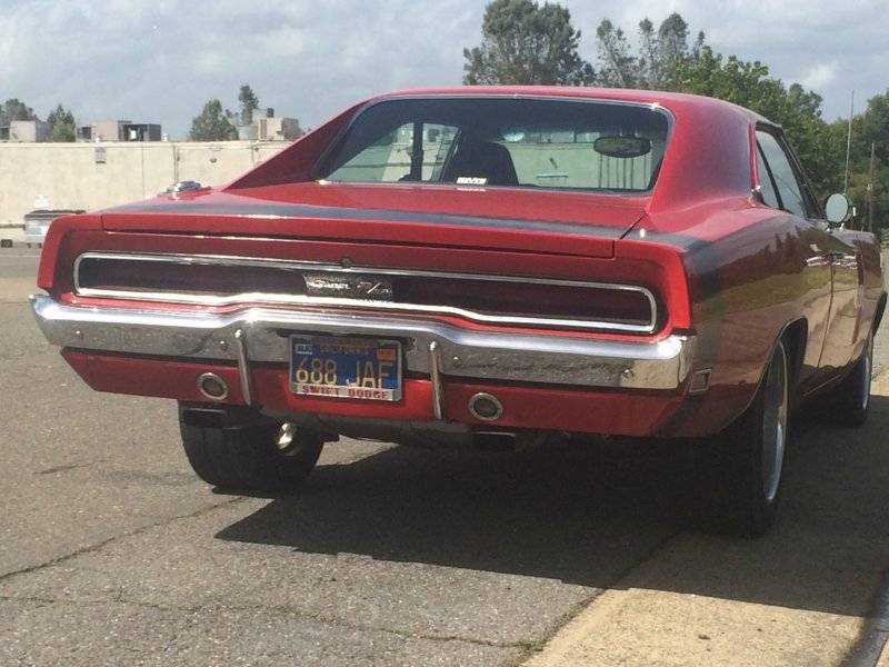

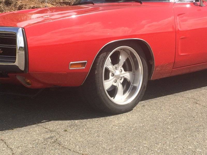

When I rebuild a front end or just reassemble one, I adjust the alignment cams so that the front bolt positions the control arm out toward the fender and the rear bolt positions it toward the engine. This is my baseline and all further adjustments go from there. MY Charger has .75 of negative camber and the tires do not wear the inside edges any faster than the rest of the tread. TOE will cause the tires to wear really fast. Ideally, you'd want zero toe but sometimes with wider tires, a slight amount of toe IN is desired because the rolling resistance of the tires pushes them slightly rearward, negating the slight toe IN.
My Charger has .75 NEG camber, 4.5 degrees of POS caster and 1/8" of toe IN. It tracks straight and the tires wear evenly.
From the rear, you can see a very slight camber angle.
Both bolts have an effect on both caster and camber.
View attachment 905436 View attachment 905437
It's amazing how from the side that looks like too much camber (to me) but from the rear it looks spot on.

Maybe the shadow gives a false impression of excessive camber. Regardless, some negative camber is good.

If you take a pic in line with the rear tire but off a few inches, you will probably be able to see the camber better....or use a level on the front tire to show where the bubble is but you have to place it at a slight angle to avoid the tire bulge at the bottom.
