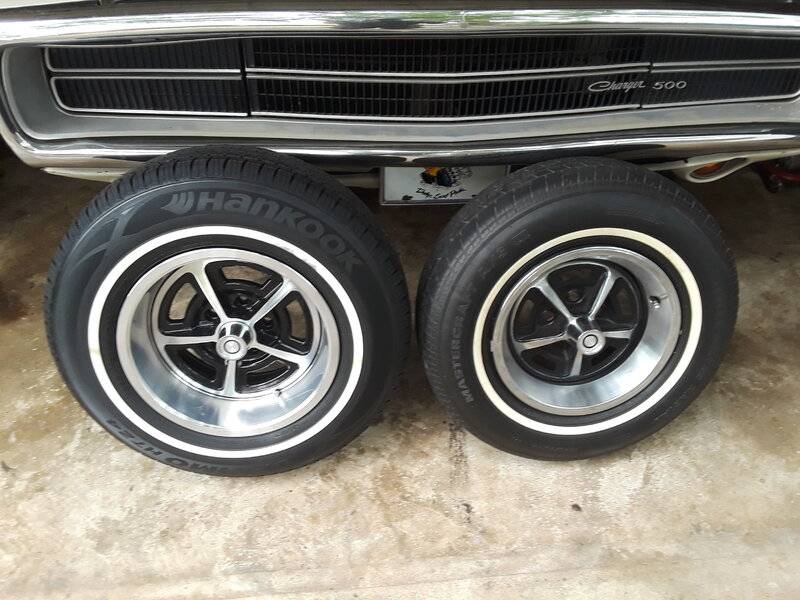

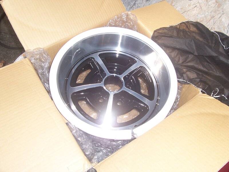

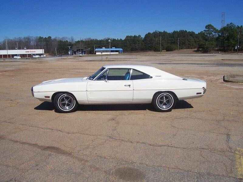

I wanted to upgrade from 14" to 15" wheels, but I wanted to match the Rally wheel as closely as possible. I went with 15 x 7 Dynacorn one piece alloys all around, with 225 R75 15's for my old school stock look! They fill the wheel wells and give a better stance, I'm VERY happy w/ them!:thumbsup:
