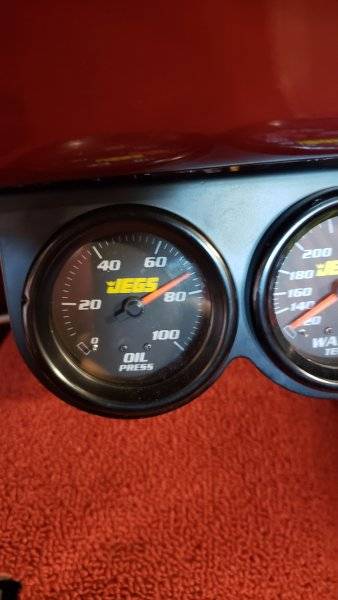

Engine was shut off as soon as it lost pressure. Break in oil and filter were change and pressure then was fine. drove car about 15 mile yesterday and it runs fine. Like I said it was also run thru a Dyno before install. My guess is a stuck relief valve but not sure. If the engine develops issue in the future it will be up to the builder.
Thanks
OK went out and started the Coronet ..... oil pressure is fine..... some how when it warms up and you get on it... the pressure goes to zero ..... again would this be the relief vale issue?
Got me stumped ???
Are you positive that the wire on your sending unit is not loose? This happened to me on my A12 Bee after a clutch and flywheel swap. Take a close look. Good luck.
Glad you got the oil pressure back when driving. New rebuilt motor you just never know. Keep an eye on it and hope it all works out for you. Never had a problem with mine from the get-go. Oil pic up tube and oil pan must be compatible with each other. Oil pickup tube should be as deep in the pan as you can get it but need clarence enough to have good pick up. Should be some kind of tray in the pan so all the oil doses not run to the back of the pan when launching the car off.
i would say u had something break?
what oil pump did the shop use?
the gauge put on it was it electric or mechanical?
there r lots of things it could be , i guess u r not real mechamical cause u had some or else build yje motor . right?
