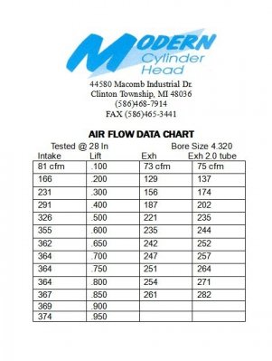

Flow sheet from Modern for my EZ heads....2.19 intake, 1.81 exhaust....excellent work!!!
