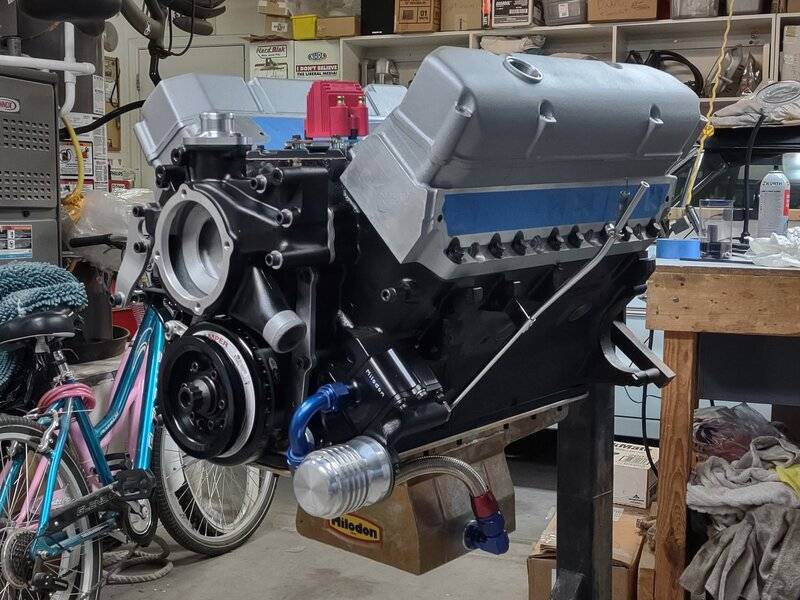

New bullet for the "Brick"
Oil pump and pickup installed -
Filled with break-in oil and ready.
Those v/c's are nice and tall. Time to spin up some ol' pressure.
Getting ready to put the new "bullet" in the chamber - took a few hours to clean up the garage, ended up throwing away the car cover that had been on the car since it was parked, it was full of dust.

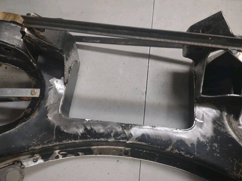

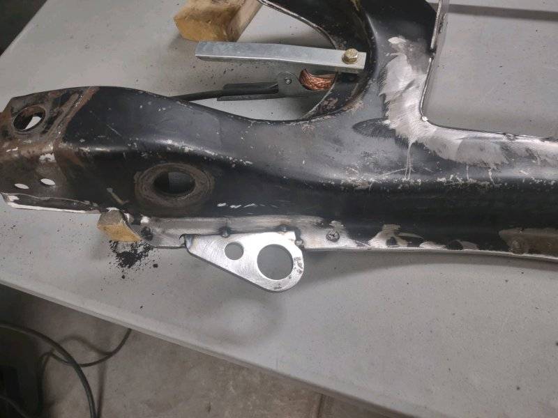

MATS was a bust, flat tire, oil leak and my Pan e Vac system did not work (or worked too good). I only got 2 1/8th mile passes in and folded it up. The only positive was a 1.42 60ft. I pulled the engine back out and it was such a pain in the *** (as was the installation) to get it out I decided I was going to do anything I could to make it easier for next time. I had interference issues with the external oil pick up line and k-member, the top transmission bell housing bolts are almost impossible to get to because of the CSI scatter shield (you cant lower the engine enough to gain the needed space to get the top bolts - if you are pulling the trans instead of the engine its not so bad. I should have done it long ago but I yanked the K-member so I can notch it. Hopefully this will allow me to lower it enough to install the top bellhousing bolts, as I do not want to drill holes in the firewall for access. Another thing I'll be doing is welding nuts to the motor mount brackets where possible so I wont need to do the double end wrench knuckle scrape/bust/pinch mumbo jumbo when tightening the thru bolts. K member out and started the modification -
Drill holes -
Mark lines and cut out -
Fabbed up this reinforcement bracket for the divers mount tower - I put the curve in it to give more room for the oil pickup line.
I also be-burred the whole thing as well as cut off and or rounded off all the sharp corners and edges I will also weld on some tie down tabs. Now time to get it cleaned up -

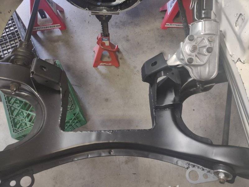

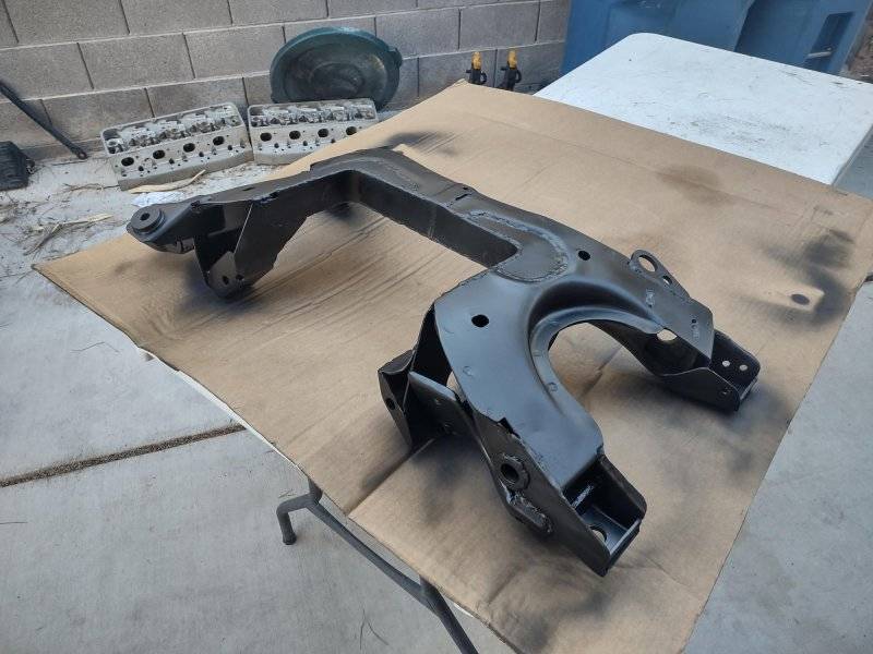

Progress -

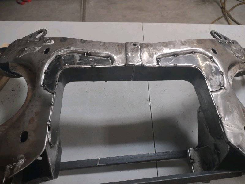

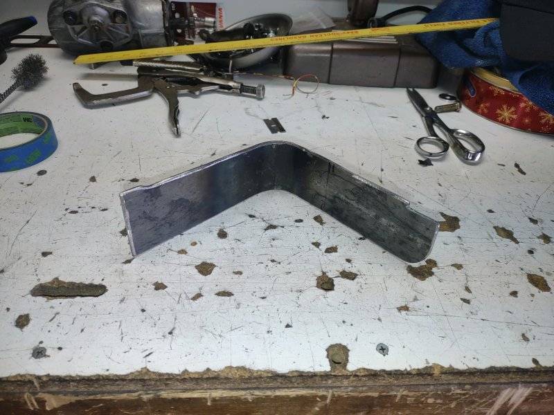

Got the boxing plates bent, here is one side. You should have seen what I rigged up to bend these, it wasn't pretty but I got it done!

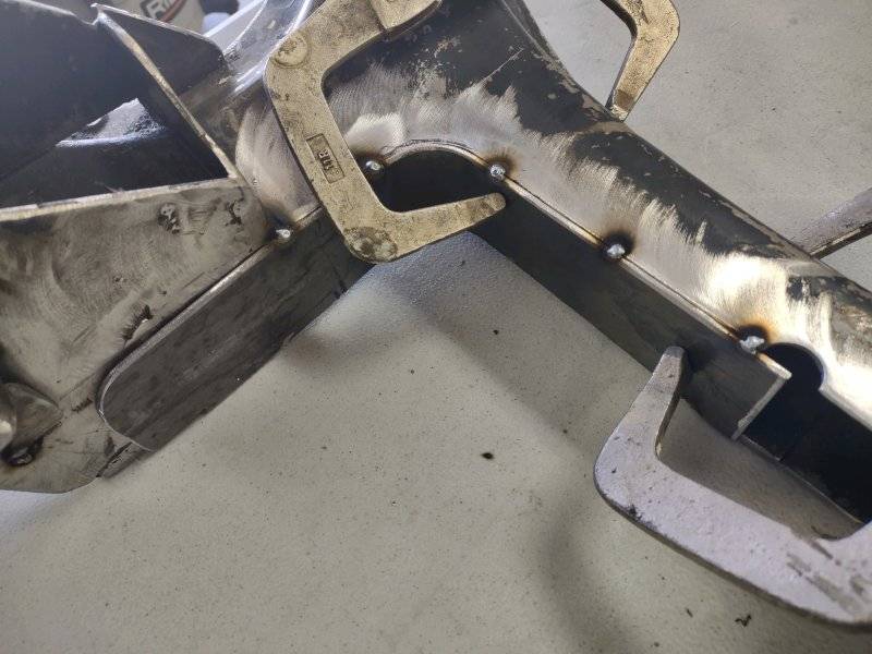

Tacking then in -
Working on the other filler pieces -

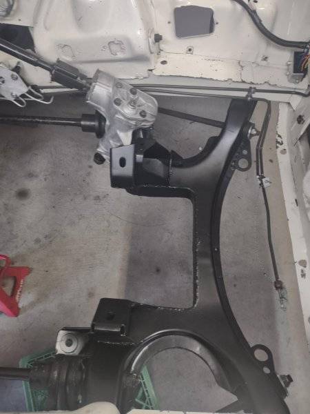

Got it welded up, painted and today my brother helped me put it back in. Also started fixing the oil leak.
