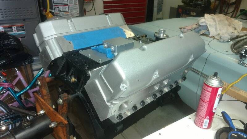

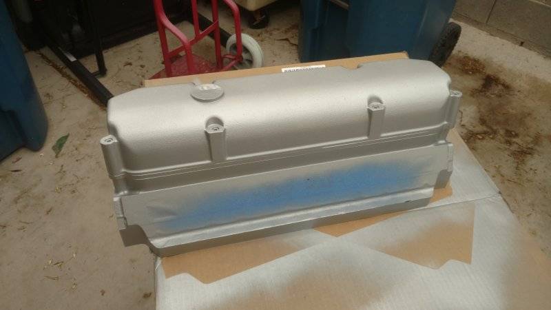

Painted the other head & valve cover
Now I can do some more mock-up to determine the best intake manifold fitment. I bolted on the heads then test fit the intake - I checked for the best port alignment (fore and aft). These manifolds can be mounted backwards because the carb pad is horizontal to the the head surface. I tried it backwards, then swapped the heads and tried the intake again both ways. Turns out it fit best with the first mock up (intake forward) That makes me happy because the Edelbrock script will face forward, on my old engine the intake ended up backward mounted.
I also bolted on the valley cover to make sure my custom breather box clears - it does.
Installed the distributor to make sure there's no interference - it's close!

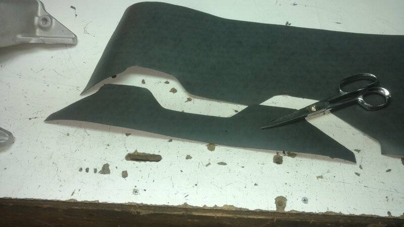

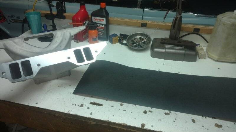

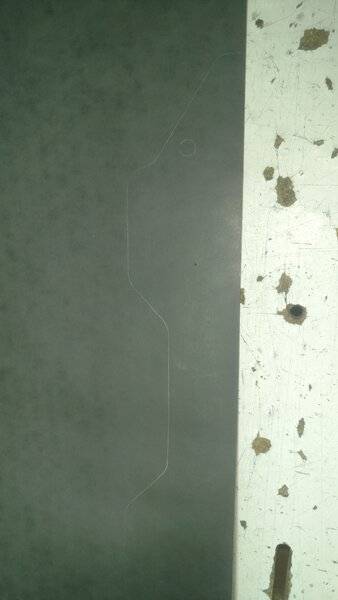

I glued the gasket material to the flange then I cut out the port openings and bolt holes with an exacto blade.
Done -
Now its' time to clean it and paint it - should get that done this weekend.

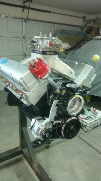

More assembly, getting closer. I had to "install" both rocker assemblies twice. The left side had the exhaust rockers in the wrong spots so I had to remove it, swap rockers and re-install. Then on the right side I forgot to make sure the rocker shaft spacers were in the right spots, so I removed to check - good thing I did because the right side rockers would have been oil starved.
Back at it - installed the windage screen.
