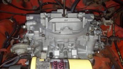

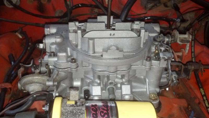

Had my avs done recently. The guy lightly bead basted the top,base, and plates. Not sure if he bead blasted it before or after he dipped it. 2012-08-31_18-36-14_395.jpg
Guess these avs's aren't so easy to rebuild or just bad luck, the accelerator pump isn't giving it enough fuel shot. Took it back to the guy and waiting to see if its repairable.
Wow that is clean!
