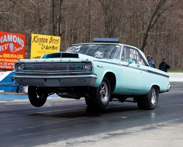

very importantly, bring a set of spare underwear or a oversize depends. 1st pass will feel a little scary with alot of adrenalin and if the 1st pass goes good, you might see some WOOD depending on your age. give em hell!!:headbang:
