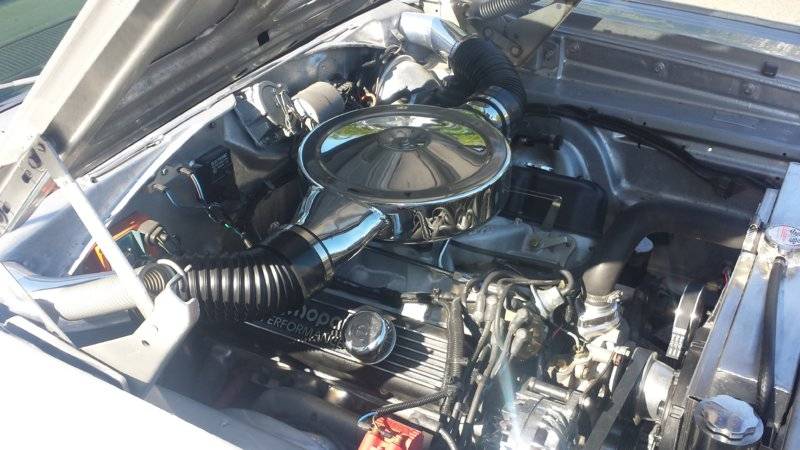

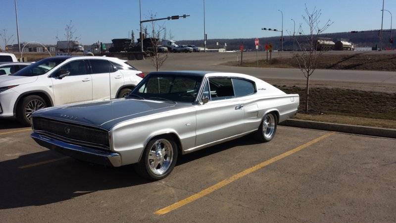

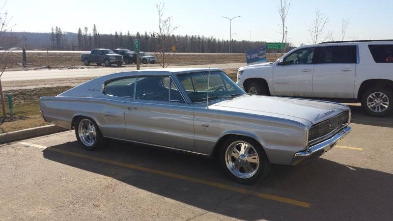

Hi nice Charger I'm new to the forum too I've had my 66 charger for 12 years an love it.

Welcome. Nice looking car. Thanks for posting.
