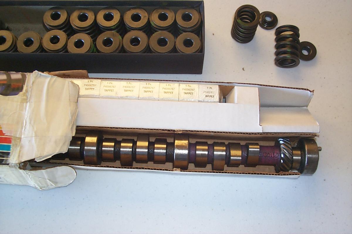

cam

the cam is 284/284.....484/.484 lift, part #312-p4120232

I believe that's a motor home block. No issues with that that I can think of. Do a cranking compression test and get back to us with the numbers. The .484" cam can be the kiss of death.

Those compression numbers are great - for an air cooled VW! You can do a cam change and save your engine. Look for something specifically designed for around 8-8.5:1 CR. I think Edelbrock makes a good cam for that application. Your target cylinder pressure should be 160 PSI for regular gas and a stock intake and carb will be fine. If you want more power you will have to change your pistons and put a slightly bigger cam.

What you want is a cam that's similar to an RV type cam. They raise the cylinder pressure thus making a low compression engine think it has more as it runs but the intake valve doesn't close early...it actually closes a bit late. It opens late too which creates a lot of vacuum. The intake begins to open as late as 0 TDC and as the piston gets near the bottom on the intake stroke, and is about to come to a stop just before it starts back up on the compression stroke, the air/fuel mix is still rushing in packing the cylinder full. That said, you can also advance that 284/484 5 or 6 degrees and it will do a good job making that low compression engine run better on the low end. Of course, you'll need to use a degree wheel to make sure you get it set where it needs to be. There's lot's of sites that show how it's done but http://www.carcraft.com/howto/116_0701_how_to_degree_a_camshaft/index.html is one of them. Comp cams and I hear Mopar Performance cams are ground on a 4 degree advance but I still move them up some for a streeter. Comp says their cams are precision ground and don't need to be degreed in....I say BS to that. There's also a lot of info on the net about how cams work and what all the different numbers mean and do but unless you plan on becoming a cam expert, it's a waste of time. Are you good and confused yet? lol

Still not very good. Get rid of that cam and put in something that has an earlier intake closing spec (I.E. smaller). I'm running the MoPar .455" lift cam in a 440 and pulling a 3700 lb B body through the traps at 109 MPH on street tires. You don't need a huge cam to make good power.
