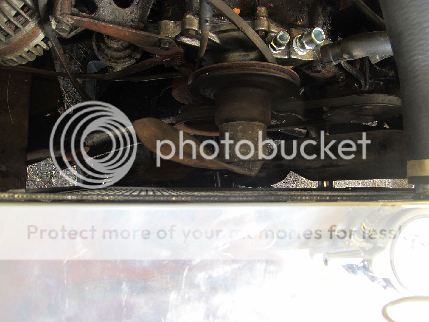

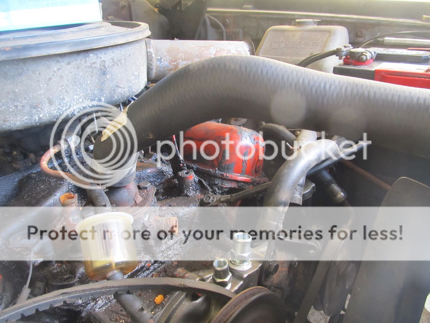

I finally have the radiator all buttoned up. I have two pics attached. Ones shows the upper radiator hose, I purchased a preformed hose and think I should change to a flex hose. Second show how close the fan is to the radiator. Is that ok?
I would clean the hose up and take it back to the parts house and ask them to find one an inch or two longer. Flex hoses are cheap looking, in my opinion (sorry if I offended anyone). Take a little extra time to get it right. As far as clearance to the radiator, try to get an inch between the closest part of the fan to the core. If you ever use a flex fan, try for even more. Hope that is an optical illusion because the fan blade looks bent in the picture. Hope you treat your engine to some degreaser and a power wash when you get it buttoned up... (you DO know that they run better when they're clean, right?) lol
