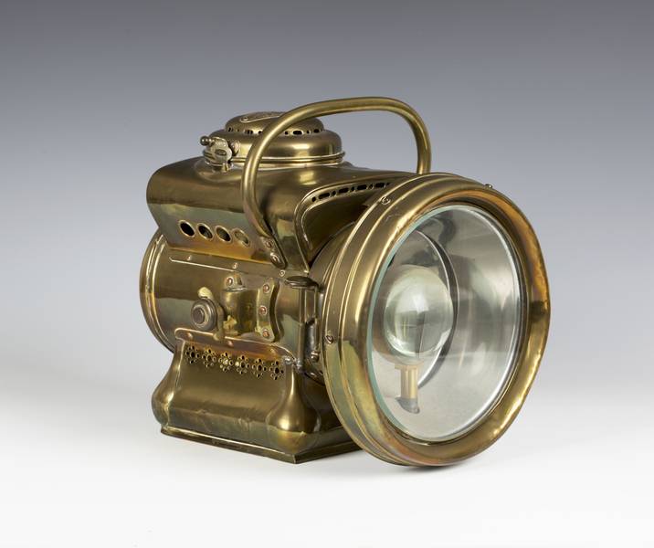

Yeah, im curious how you shut off "all function" and leave the headlights on? Two flashlights taped to the fenders?
That is just pure stupid.
It isn't a problem. Acetylene headlamps stay lit without electricity. :)
