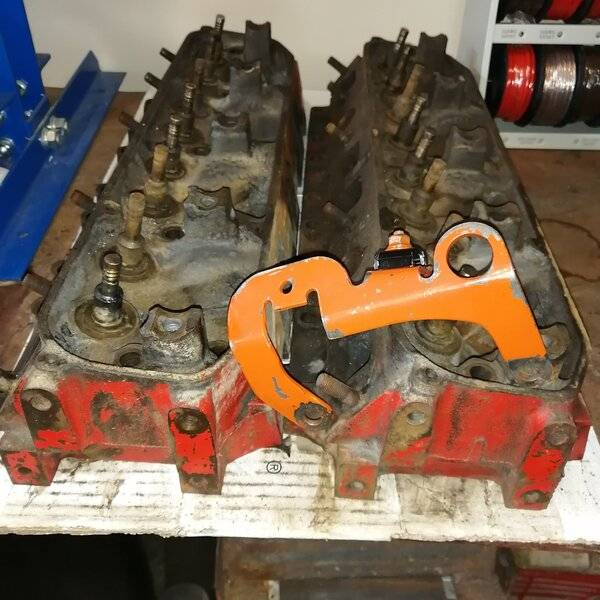

Are the rocker arms adjustable? Have you checked the crank flange? Are the holes in the flange threaded or through bolt? The cast iron TorqueFlite torque converters had studs that slipped through the flange and were held on with nuts. Painted red I am wondering if it might be an engine for an older car even with a '64 casting date. The 361 in my '59 Plymouth was painted red.
The rockers are adjustable. I’ll let you know about the flange. I’ll probably go to the machine shop this week sometime.
There's no need to put in hardened valve seats unless you plan on doing lots of heavy towing. Ive worked on old engines for many years and I've only seen a couple with really bad valve seats. The performance shop I worked at, we never installed seats if the original ones were still good. They don't burn out just cruising around your hotrod.
ANY pre-1970 will require exhaust seats. Ignore those rumors, gossip, and wives tales out there that say that you don't, and treat it as "Myth". I have too many sunken seats on early heads (Mopar, Chevy, and Ford), and can tell you first hand, put the seats in and be done with it. Do it once, and do it right!

ANY pre-1970 will require exhaust seats. Ignore those rumors, gossip, and wives tales out there that say that you don't, and treat it as "Myth". I have too many sunk seats on early heads (Mopar, Chevy, and Ford), and can tell you first hand, put the seats in and be done with it. Do it once, and do it right!
Weird, because I worked at a performance shop and we never did them unless they were already sunk. And they were rarely ever sunk. And if they are it's usually because of a bad valve job where they've been cut too much. I never have installed seats, never had a problem, and never will.
I don't care if you disagree, but it is fact. "Performance" guys go thru heads so often, why would they care if the exhaust seats were hard or not. Head goes bad, just find another head. I have been at this for 27 years, and can tell you, ANY pre-1970 head needs exhaust seats. I also use chrome stem valves too for the unleaded gas. While Mopar heads tend to have more nickel in them, the hardness depth is not consistent. After a few valve jobs, you can be into soft iron, so why take the chance. Most regular folks only want to R&R the heads once, and have the seats put in. Ford and Chevy heads suck and eat a lot of exhaust seats, but Mopar is definitely better. Regular vehicles can do okay, but won't "Never" sink a seat, and higher loads (truck, trailer, towing, etc) do exacerbate the problem. And, just to add, I have seen a lot of Mopar car heads with sunk seats too.

I did have the hardened seats installed. Thanks for the reply

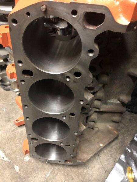

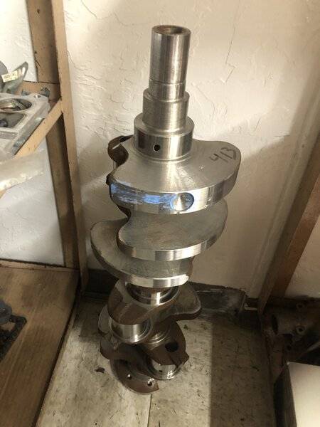

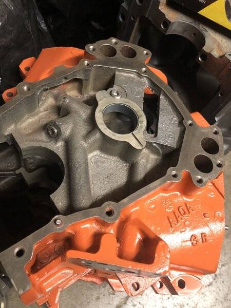

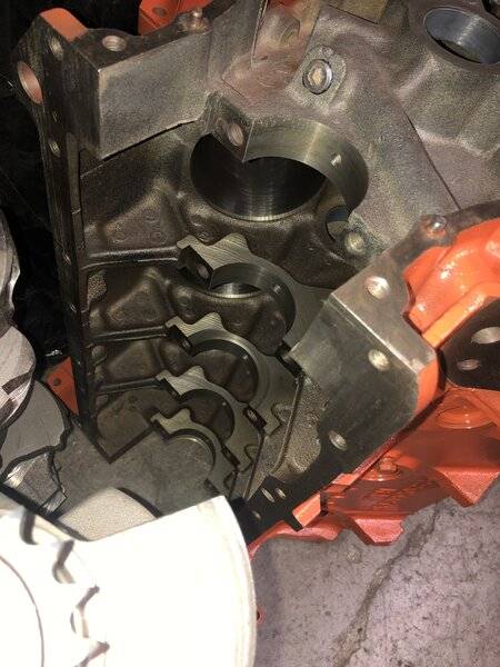

8EF10D99-0A60-4B46-BA75-4508E7E7926E.jpeg C1728024-A0E0-4342-B3E7-E72EC025A2F5.jpeg 77D1324B-A564-4DDA-A3F8-7EAA0CB13265.jpeg 1332881E-F83C-46E9-8A08-B9D0AFF533B8.jpeg
I plan on bolting to a 1964 push button torque flight. Shouldn’t be a problem seeing I have a 64 block.

That engine looks super! Same as I have, casting, year etc. Very nice and runs great. Still has the lighter pistons too, the 440 went heavier. Power isn’t much short of a 440 anyway. I’d like to see the rockers when you have a photo. Probably same as 300K and MW.
