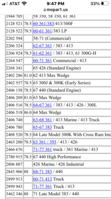

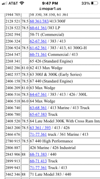

The heads have the smaller exhaust ports 1.6”. I thought it was a 518 cast, but it looks like a poorly cast 6.

Yep, 518s are max wedge. If your heads were maxwedge, you'd know it!
Is it possible that the 516’s could have factory adjustable? These heads were used on a 426 as well.

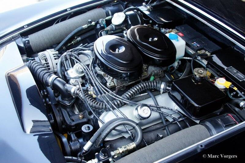

I have done some research on '516' heads and there are different castings, (same casting number 516) larger ports.
Its all to do with the small exhaust ports for the 1.600 valves...
For some strange reason the 1964 and 1965 '516' castings had a revised ex-port shape, (much larger).
One set of heads came off a Facel Vega with and 8-barrel manifold...:wtf:
I have compared it with the 1967 '915' port and its very similar, some are 1.600 and some are 1.740.:poke:
But every 1966 '516' head I have ever found had the tiny and small ex-port...Go Figure...?

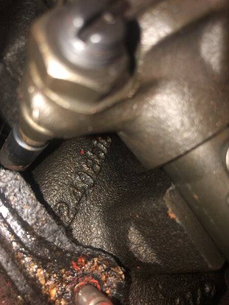

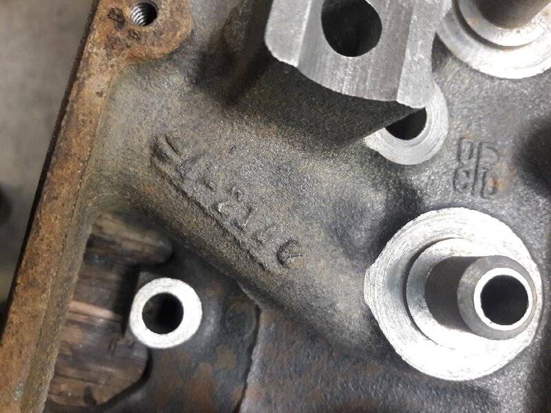

Here are some pics. They are cast rocker pedestals.
4-214 is what i see, plus another cast code.
Pictures are a little close Jonpaul.
If you take some pics further away and the combustion chamber too.
There may be some numbers cast into the boss underneath head as well.
Pictures of the rockers as well.
This was an inquiry about the date code. I think that 4-214 means it was cast on the 214th day of 1964. The pic was taken for another who asked about the date code. I’ll get some pics of the rockers if I can. They are getting ready to assemble it.

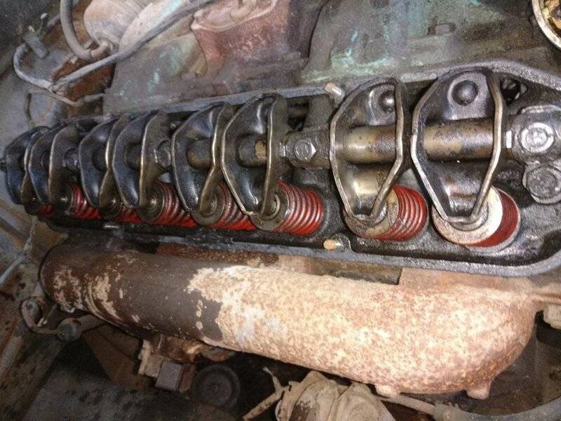

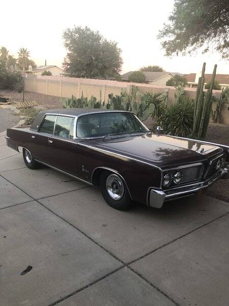

I have a couple of ‘64 Imps. Both are projects that I’ve gotten running and am sure have never been apart. Here’s what one looked like before I cleaned it up. I’m pry sure it has about 114k miles on it and it runs like a sewing machine.

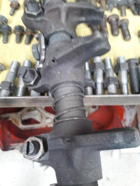

If we just forget about the '516' heads for a second.. could you post more, better, pics of the rockers?
There was a thread some time ago that touched on the differences between MW rockers and letter car rockers.
Your engine find may produce interesting information on the subject
Honestly I never looked and the covers are back on both cars.

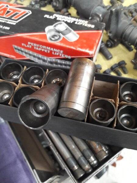

the motor is completely disassembled right now. I’m going to try to get photos as it comes together, and a dyno video. I’ll post the results too.
Thanks!
Looks like you might need different pushrods with new lifters.. those appear to be the early neck-down rods. Never seen them myself.
