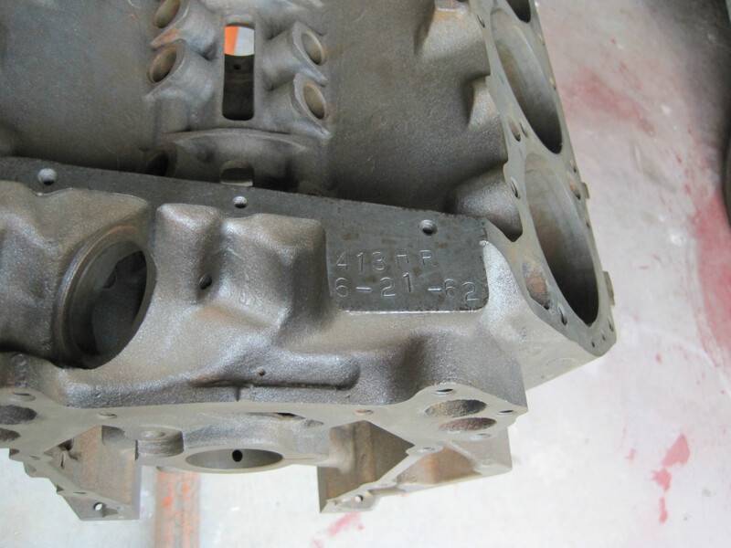

Is there anything stamped into the pad in the front of the engine right behind the water pump housing? There is a flat spot behind it. This picture shows where that information is stamped. I'm pretty sure even though it was a crate engine there should be some kind of build info on that pad.
BeepBeepRR is that your block in the pic ?
That’s my block in the pic.
That would be wonderful, but the 300K had 1.75 ports. This has 1.6”. I’ll measure the spring I.D.s too. The springs in there now are very beefy. I know I have something, but what? It’s a new 413 bore with 3-3/4 stroke without hydraulic lifters. Puzzling. It was worth the 2k I paid for it.
Sorry, no. We meant the block in post #13. It's a 413 max block.

I'll be the first to say that I am no expert on this stuff, but I find it odd that the pad is not stamped. As already stated, that was stamped when the block was built, and includes information like assembly date, shift, undersized journals, etc. I see no reason why that wouldn't be stamped for ANY block built, warranty or otherwise.
Could you show us a picture of the pad (in front of the intake manifold, as shown in an earlier post)? Could that have been machined later?
I will show you a pic when I go back to the shop. There is an “m” only on the block. They would have had to blend in the entire valley pan area around the entire intake, or leave a step where just the pad area is. I’ll check it out.

The motor in MAX is a factory replacement. It is not stamped.
