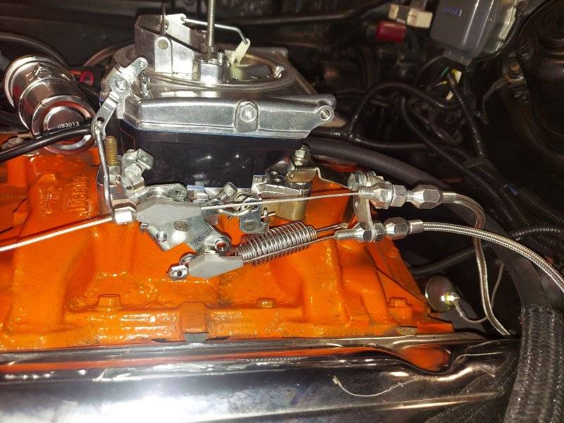

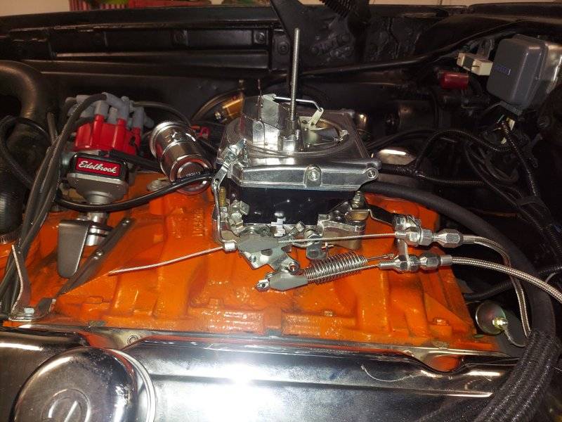

First, thank you for letting me join. I greatly appreciate it. Heres my current issue. I'm restoring a 70 charger and have a big block with the holley street demon 750. I can't get it to open full throttle!!. I'm only getting 2 barrels, if that. I tried factory throttle cable and kickdown and currently using lokar style cables and brackets. I've adjusted, adjusted, adjusted and adjusted....no luck. It did stick one day and that was fun. Geometry issue or something? Idk. I'm close to getting this car finished and could use the help. Thank you, Alex

Sorry. All the pictures didn't load the first time. Here are some. I can open it full throttle by hand from under hood but the pedal and cable will not fully open it. I've adjusted and adjusted. No clearance issues. Factory cable, kickdown, brackets and levers didn't work eiter.
