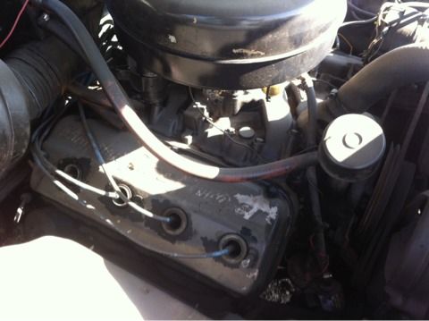

I'm not too sure if this is a good deal or not.
I'm looking at a 392 Fire Power Hemi that is for sale locally
He wants $2,500 for it. Says it runs.
Should I buy it?
What are these things worth?

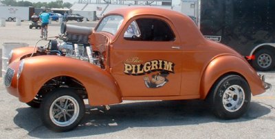

I think Hemitis runs one in his blown 63

From the picture I can tell you that it is NOT, repeat NOT a 392. To begin with it does not have a water crossover manifold and uses a wet intake. This indicates its a pre 1955 331 cu. in. motor worth about $500 - $700 if its running and in good condition. A running 392 is worth maybe a grand or $1500 but not what he's asking.
When you go look at it, check the deck just in front of the intake and behind the water pump on the passenger's side of the block. There will be a stamped set of letters and numbers there. If this number starts with anything other than NE57, 3NE57, 58N, 58N3, CE57, or 58C it is NOT a 392. So many people are unedcuated when it comes to early hemis that they believe they are all 392s and if you don't know how to tell the difference it can bite you. He probably doesn't know that its not a 392 but in this case just looking at the picture its easy for someone who knows them to tell its an early 331. Another indication is the location of the oil filler tube. On later models it is located behind the water crossover manifold in the valley cover. In the picture you posted its located on the water pump cover. Wrong place for a 392 but the right place for a 331.

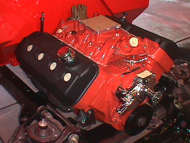

Here is a picture of a 1955 Chrysler 331 which uses the same water crossover manifold which incorporates the thermostat housing that the 392 uses. If his engine doesn't have this crossover manifold its definatly not a 392, and from the picture you posted it doesn't.

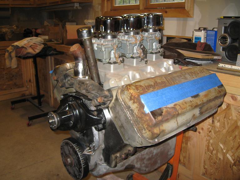

Here on the other hand is a picture of a 1954 331. Chrysler hemis prior to 1955 use a wet intake with the thermostat housing in the intake manifold. Looking at the picture you posted its pretty obvious the engine has a wet intake.

Centerline,
Thanks for the great "DATA" (Info)
Yup, as you stated...it is NOT a 392 although advertised as one.
You saved me from making a mistake.
