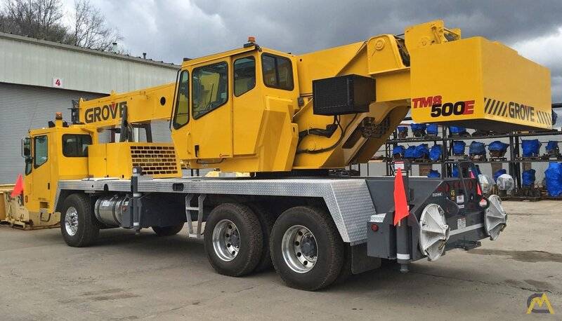

I know a guy in NJ that uses a 40 ton Grove stick crane for tree work and all he uses is rope, no cable. Just as with a cable, the rope needs to be certified and inspected regularly.
