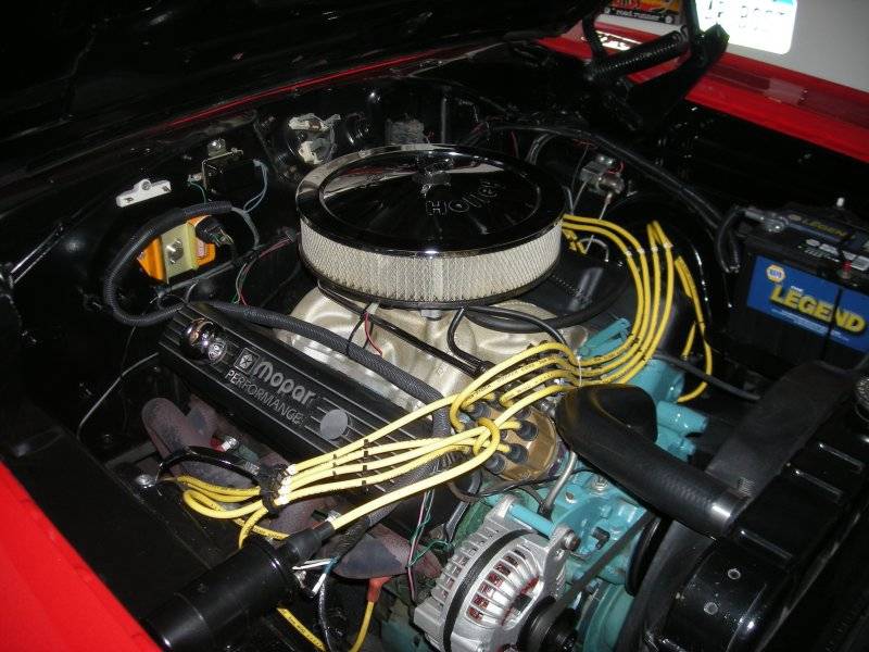

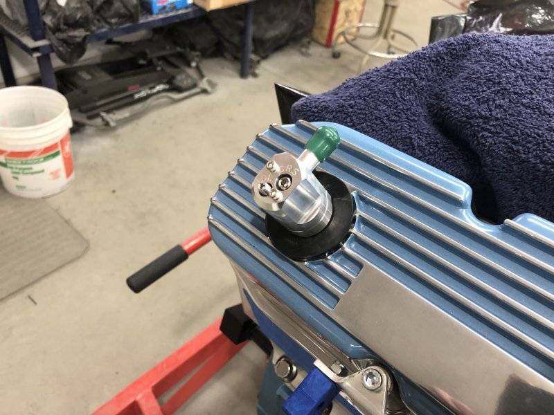

Oil around valve cover filler cap
Just run a breather cap on the pass side and universal pvc from the driver side with the hose from the pvc to the front of the carb no need for hose to the air cleaner!
