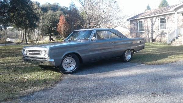

This is the one I'm thinking about selling. Completely (professionally) wired front to back, interior redone, new tires, lots of parts included, been working on motor and almost finished($10,000 invested). Headers, cam, neew 850 Holley. List of name brands in this motor. Very strong fast motor. 727 trans with reverse shift pattern. Typical Mopar panel rust bubbles starting. Probably about $15,000 OBO. If you know someone looking tell them to contact me. Love this car but never done body work and it can get expensive.
