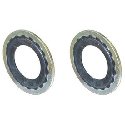

These oil drain plug washers work great...

do you have a link where we can buy 'em?
I tried these also but they couldn't fix my problem.

I put one of those washers "plucked chicken" showed and it still drips. I think I found the problem, the pan is just beat up around where the bolt goes in so it is not really flat and even, I will put clear silicone on it tomorrow with a brand new bolt and washer, see what happens.

if the washers plucked chicken showed dont solve the problem,then you have pan damage.we switched to those here at the shop and never had any leaks.anybody who sells dorman or mighty products can get them.can you file the mounting suface flat?
