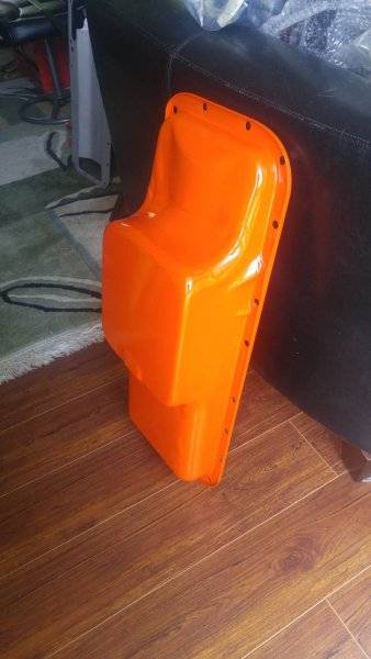

I spoke to the previous owner and apparently it has a Hemi oil pan and a Hemi pickup as pictured. Could this be the issue?View attachment 1377207
This does not look like the Hemi pans I’ve seen. Maybe they are not all the same. Hemi pans have baffles to help prevent oil sloshing from the pick- up on both acceleration and deceleration. Even if the pick-up is wrong, or your 2 quarts low, you shouldn’t uncover the pick-p in a baffled pan on the street.

The issue was there wasn't enough oil in the engine. I add a quart of oil and the problem resolved completely. I did some hard braking and drove 20 miles.
The Lokar dipstick showed oil to the full mark before adding that quart. So I obviously have the wrong dipstick.
