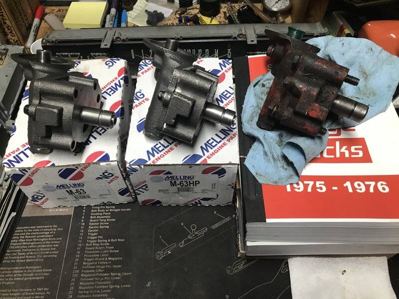

As stated earlier, my recommendation is to run the original pump, and based on data, decide what to do.
What is your recommendation for the OP?
My recommendation based on my experiences is to use the high volume oil pump, which, superficially appears to be diametrically opposite of your recommendation.....fine. I would prefer to error on the "too much oil volume is better than not enough oil volume", as the oil provides, in addition to lubrication, cooling of the bearing journal by providing more volume to carry away heat, (and to maintain the affore mentioned hydrodynamic wedge), similar to high circulating volumes and velocities in the cooling system. The cost differences between a "standard" volume pump and a "high volume" pump is nominal (with in $10 - $15 +/-). But....I'm sure there are just as many proponents that advocate FOR the high volume pump as there are FOR the standard volume pump.
