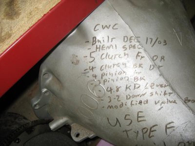

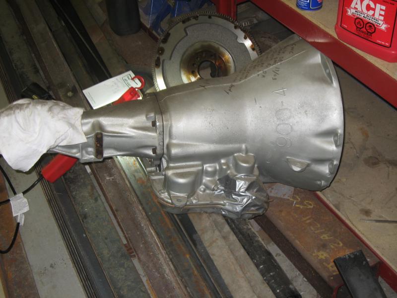

i aquired this trans some yrs ago with my hemi engine but never used it. went tko instead. its new rebuilt but i don't know what the writing is telling me and i am guessing it will bolt to a 440 also. any help appreciated, thanks.:eusa_think:

It looks like a decent tranny. Didn't get a good enough shot of bellhousing to tell if its big or small block. Built for the street. Nothing special about the planetary gears, 4 pinion and 3 pinion. Kick down lever is ok at 4.8, no real difference from a 5.0 lever.not sure what year it is but i assume its been modified for part throttle kickdown. The older units would not downshift unless you basically floor it.
It is a big block trans so it will bolt to any B or RB engine, don't know about those "Hemi Specs". True Hemi transmissions, as well as other HP applications had a special input shaft and also a 4 pinion rear planet. The Forward and direct drums were unique as was the intermediate band and band apply lever.

"hemi-specs" refers to the 5 clutch disc front drum... 4.8 lever, never heard of it.. there is a 4.2 and 5.0, but have never heard of a 4.8... I think its a typo... another aspect of the "hemi" 727 that is different but not annotated on that transmission is the governor... hemi governors had a shift rpm much higher than the other engine/727 combinations.. do not see it written on the case that it has been given a different governor though.
tailshaft housing is out of a late 70's truck :D
also, if it has sat for 9 years, replace the front pump, tailshaft housing, and shifter lever seals... as well as the trans pan gasket... insurance

yea i figured that, thnx
