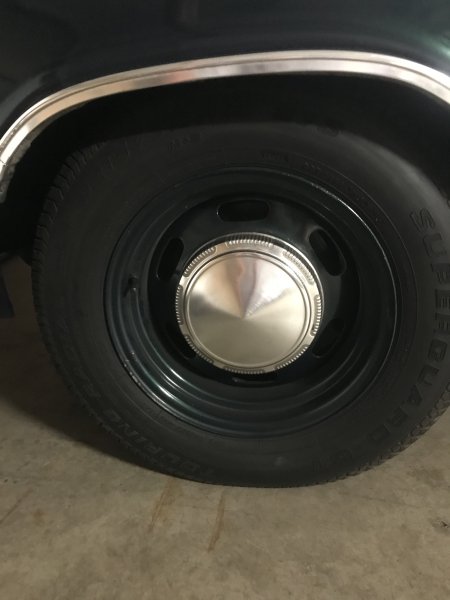

I am also going to upgrade the rims asap once the budget allows.
What you have there are 15x7 cop rims. You could replace them with a set of " better looking" rims..
But pretty hard to find a set of rims that are " better".
Any sugestions on doing something with these rims to give some more crome? trim rings... Crome the rims??? Shine? I am a rookie men. The more suggestions you have the better.

Thank you everyone. Now the question is... what do I buy and where. Sounds like Coker is the place to go. Now what to buy. I have P215/70R 15's on it now. it's a 1967 Coronet 440 with steel rims and dog dish hub caps. I don't understand back spacing etc. so any info you guys have would be great.
