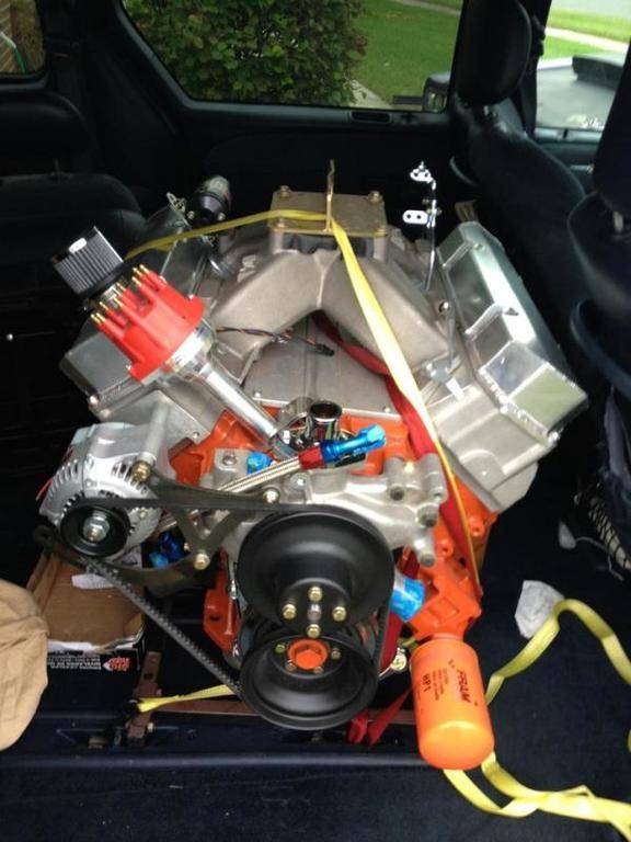

Hey 69, couldn't help but notice the fram oil filter. Just wonderin do you plan on leaving that on there. IMHO I'd never run a fram, but to each his own. I'm not trying to be a dick or anything so please don't take it wrong. I just hate to see one of those "orange can of doom" on a new motor.
Sublimegtx, No your not being a dick I'm glad you mentioned something, Whats wrong with them? Just wondering. I was probably going to change it anyways since thats been sitting on it for a few years.

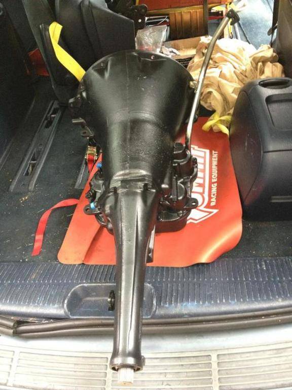

for street application, i would you a 10" turbo action converter. but if your going to go to the track have paul at turbo action spec you out a nice 9"

Thanks SSR. The trans was built by Dynamic converters so I figured I'd have them build the converter as well but haven't been able to get a hold of them to talk about a converter... So I'll have to check with turbo action. It is a street car with some strip time. Just wondering how much does a custom converter usually run? much more than off the shelf?
Here's a few links.. http://minimopar.knizefamily.net/oilfilters/opinions.html http://www.forbbodiesonly.com/mopar...70-favorite-oil-filters&highlight=oil+filters http://www.forbbodiesonly.com/mopar...Do-You-Use-or-Recommend&highlight=oil+filters I just won't use fram, lots of people do. I see $$$$ sitting in that engine and would use the best I could find.
Thanks for the read. I didn't know that, I'll be sure to try one of those recommend on the list. Rather spend an extra what 10 bucks every year or two for something of quality.
