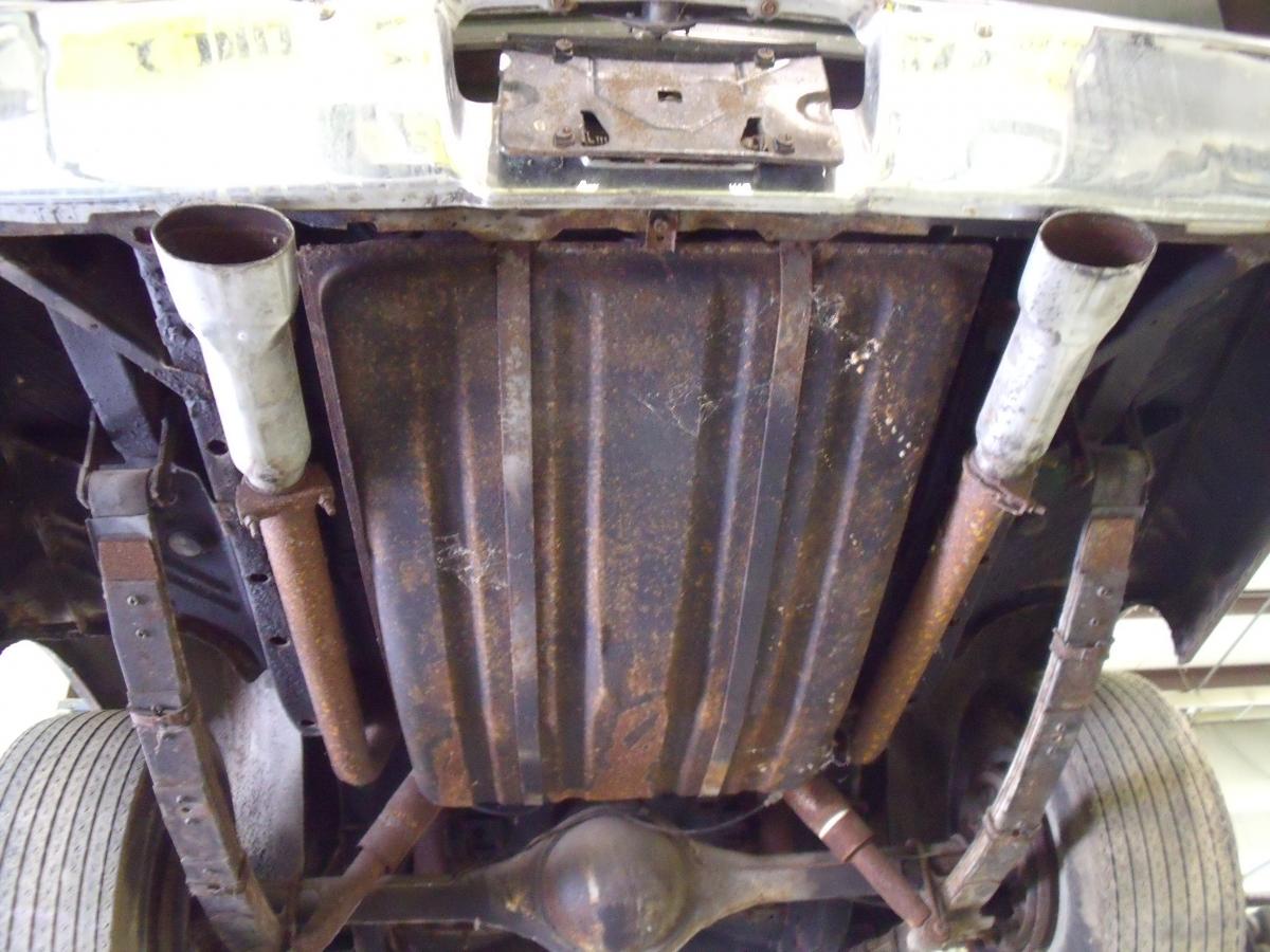

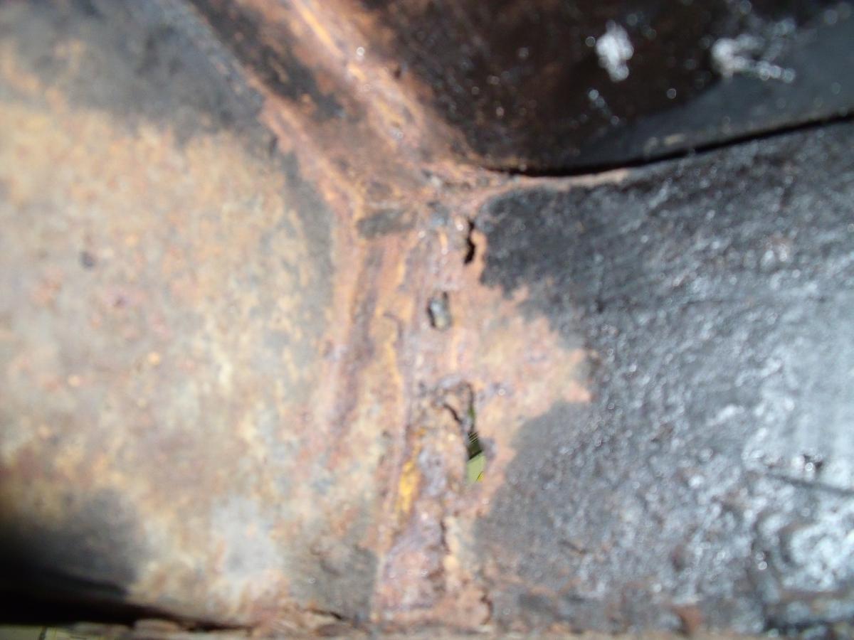

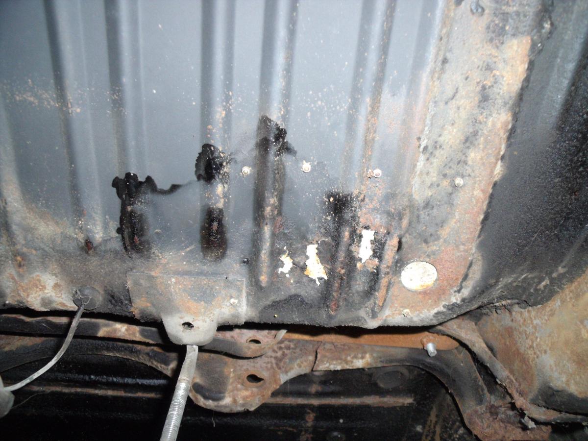

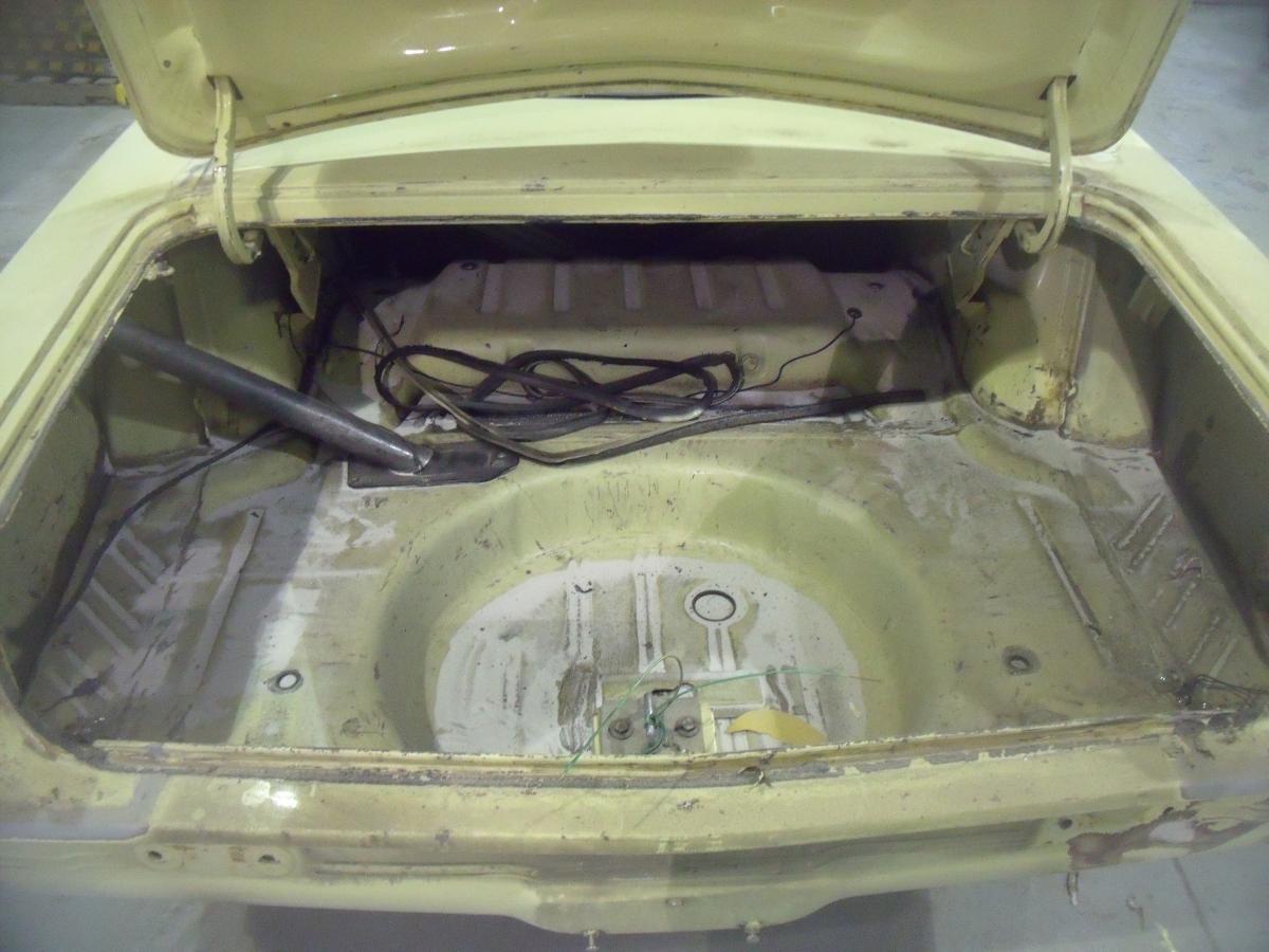

I took the the tank out and found another patch and then I scrapped the rear cross brace and found 2 holes ...so I think it's new floor , extentions , and rear brace for me!!! Can I replace all that without taking the 1/4's off?? I will post pics later today to show what I found!
heres the pics
Yes.....Pain in the rear though. The quarters are spot welded onto the extentions on the bottom lip and forward lip. They also are spot welded to the sides of the fill panel and extention lip towards the rear.
The biggest headache will probably be where the rear lip of the trunk panel tucks down and is spot welded to your fill panel. Also, it is spot welded from the bottom up from the rear crossmember where it's tucked underneath the fill panel. The fill panel braces along with the trunk lid latch support will have to be drilled out. The frame rails along with the shackle mount and trunk brace are pretty straight forward and not too bad to seperate from the pan.
You'll have to go from inside your wheel houses to drill out the inner wheel house to trunk pan welds. Judging from the pic's, be prepared to find some decent rot there. Really typical place for rot. The shock crossmember will only have 2-3 spot welds on each side to drill out and the about a dozen more across the rear interior pan to trunk pan.
I really recommend "Blair" spot weld cutter bits. Clean off all spots welds via wire wheel or blast, hit em with a punch and drill away.
Good luck with your project, and post up some more progress pic's if you get a chance

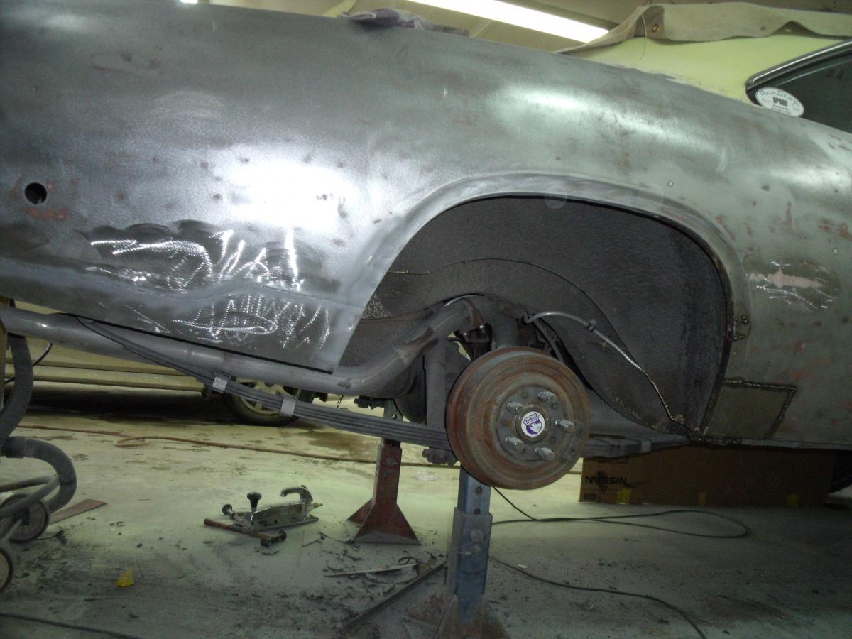

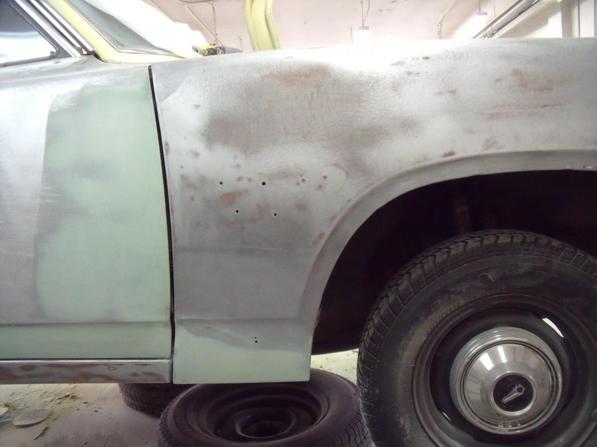

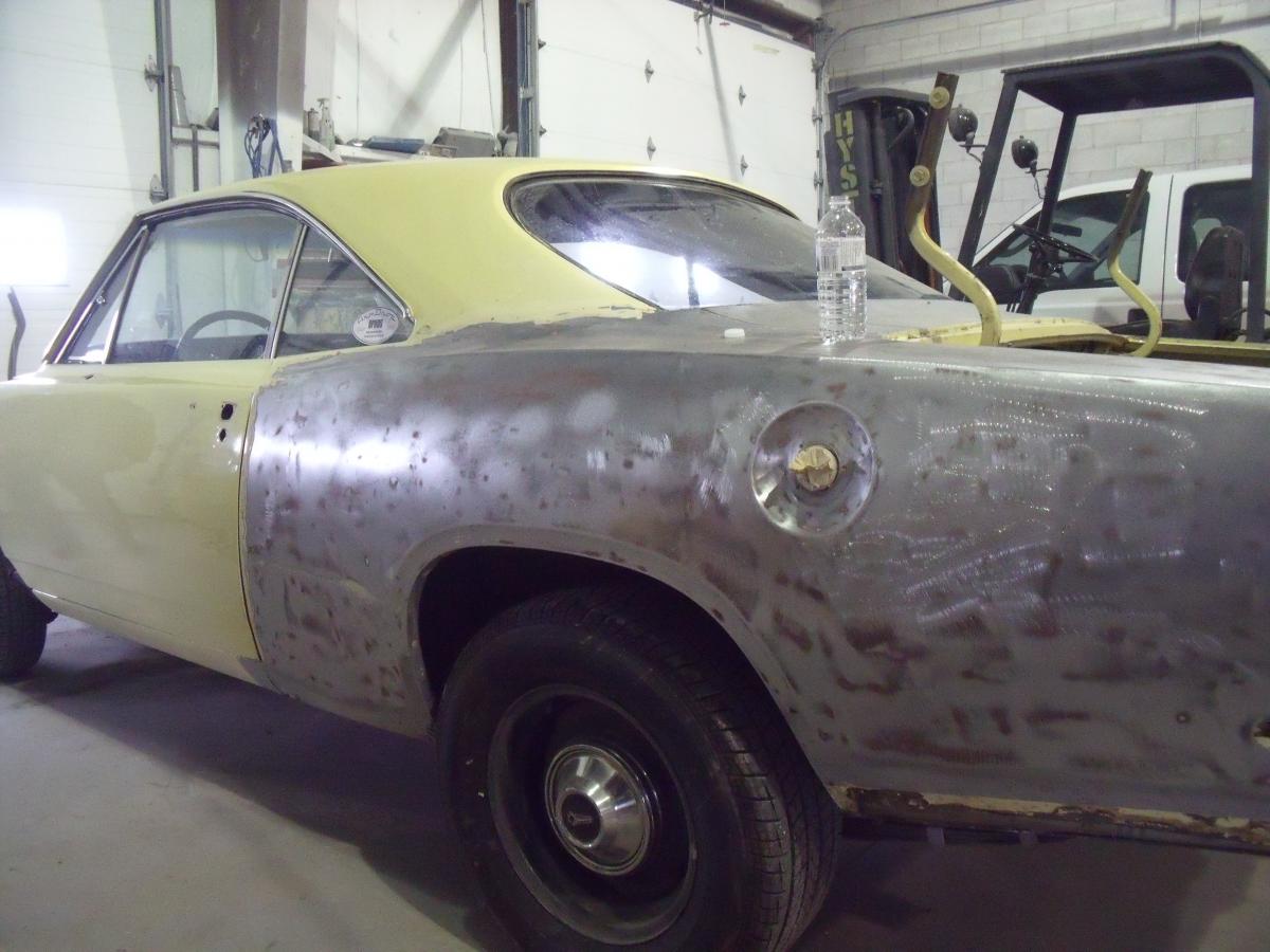

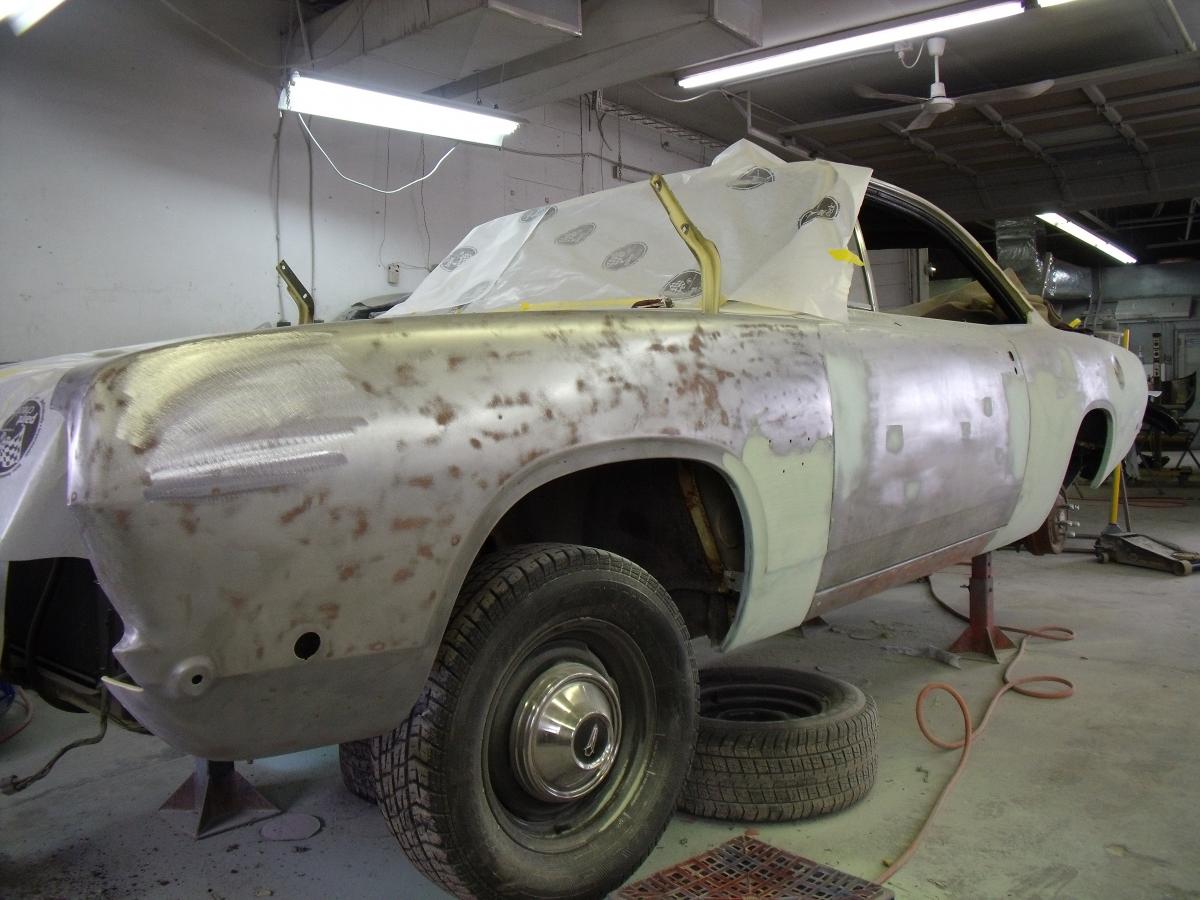

my barracuda
well at the a bodie forum it won't let download pics of my barracuda so I will here!! yes, yes I have 3 projects on the go at the same time!! Visa loves me!!LOL
