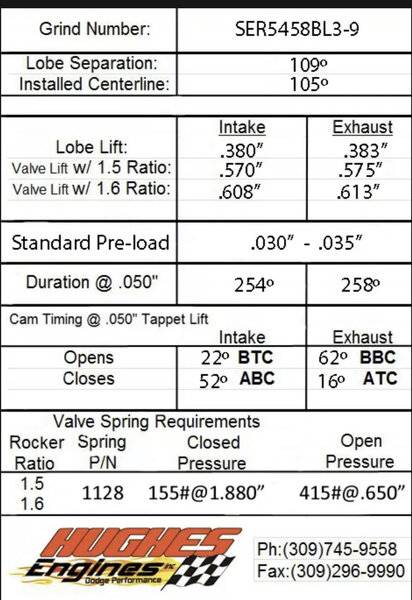

I have spoken with Hughes, who designed the cam I am considering using. They recommended it for a 500+ CI motor with 11:1+ compression and mechanical secondaries on the carb.

I will post a photo of the cam card. Hughes seemed to think with the low altitude here and the abundance (as of now) of 93 octane gas, that 11:1 on pump gas would be doable.
The car won’t be a daily, but will probably see more street than track. Would you say 11:1 could work safely with the cam, or is it better to try 9.5-10.5?
I have heard some people say 11:1 makes the tuning window very narrow, however there are plenty of cars from the era that cam with 10.5:1 and iron heads back then. I’m assuming it should be fine, but I just want to verify.

I’m running a 11.2-1 in a 360. 93 octane is do-able but not something I’d do again with my small-ish cam. Your cam is larger than mine by a good margin, 30* @050.

My 496 stroker has 10.2:1 w aluminum heads. I only have 91 available where I am. If it's not cool outside, below 50°, I get a bit of clatter n I'm running 32° at full advance. Now, I've been made aware by those much more knowledgeable than I that it has to do w my cam. Not enough overlap to bleed off compression. Instead of being around 160ish psi, I'm at 190.

Aluminum heads run a bit cooler than iron so that's why the motor will act like it has a bit less compression. Used to run 10.5 with a 340 in a 3560 lb Cuda and it did fine with 91 so long as I kept my foot out of it. In the winter time it was better. Summer time 93 was better until the temps hit 100 and engine temp got around 190. Keep in mind that an engine pings in the lower rpm ranges with a heavy load but at high rpm there's not enough time to ping.....and if you haven't already done it, there's plenty of info on detonation and preignition and how cams can make or break an engine.

You can get away with higher compression and help avoid detonation by using flat top pistons with aluminum heads providing quench and a cam big enough to bleed a little compression at slow speeds
